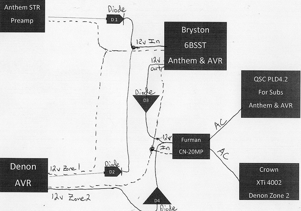

I have a couple 12v trigger issues I’m dealing with.
I have an Anthem STR Pre-amp with my Front Right and Left speakers connected to a Bryston 6BSST amplifier. The Anthem supports Home Theater Bypass but is in standby mode when HTB is activated. I need the same Bryston amp to turn on while the Anthem is in standby. A 12v Y-cable with a couple diodes should solve this issue.
I have a couple pro amps without 12v triggers and want to use a Furman CN-20MP to turn them on. The Bryston will provide the 12v out to the Fuman 12v in for the subs.
I have a second pro amp that powers my house in-wall and outdoor speakers. Currently my AVR trigger out 2 is set up for zone 2. The trigger 2 12v out is connected to a Furman CN-20MP to turn on the Crown amp to drive my whole home speakers. I want to use the same CN-20MP to turn on a QSC amp to drive my subwoofers. The Bryston 6BSST will provide the 12v pass-through.
Does my attached diagram look correct to accomplish what I want while protecting back-feed?
I'm confident the y-cable to the Bryston will be fine but want to be sure on the other since there may be times when both trigger 2 from the AVR and the Bryston trigger out will be active.
Thanks.
