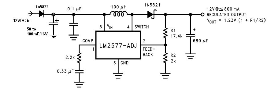

hi all,
when i start my car the starter needs a lot of current to operate.So for 3-4 seconds,until the car starts normally,the voltage drops down to 0V and rises up to 12V very quickly because of inductive phenomenon.
I want to construct a voltage regulator 12v or 12,8v maximum input, to 12v output with 2A circuit current maximum.The circuit in normal operation demands 100mA.So ideal steady output is 12v/100mA!
This circuit will provide a small GPS modem..
if someone has a schematic circuit would help me a lot!!
thanks in advance..

You can't regulate 12 volts to 12 volts with a linear regulator. You would need some kind of a buck-boost capable switching converter to do this. Why would you need 2A output if the load is only 100 mA? That's a big difference.

So,the voltage drops while cranking the engine,and the GPS restarts?
Hum,I've usually done it with a diode and a large capacitor or small battery.The diode will isolate the cap/battery so that it doesn't discharge back into the car's starter during cranking.
It will 'takeover' and power the device during the voltage dip.
Sort of a simple UPS.
I once used a 17AH SLA in the same setup for a (temporary)car-PC,so it (or more correctly the inverter) wouldn't reset during starting,etc.

If that's the problem that is to be solved, then this solution (the diode/cap) should be all you need.DigitalJunkie said:So,the voltage drops while cranking the engine,and the GPS restarts?

DigitalJunkie said:Hum,I've usually done it with a diode and a large capacitor ....The diode will isolate the cap....so that it doesn't discharge back into the car's starter during cranking.
Hi:
That's a good idea. I'd also suggest using a small and simple step-up regulator, connected after the diode-capacitor network (as in the picture below). The regulator will keep the output at 12V during the input voltage sag.
Milan
I don't use the same wires as the stereo to provide my modem.I just take it from a fuse 🙄 ....
I also thought before posting that a detector (diode/capacitor) would be the best combination but i didn't know the accurate diode and and cap i must use.
I will use also the step-up regulator of ''moamps'' after the diode-cap network..
Ha Ha,I think that i solve my problem!!
THANK you ALL!!!!!
THANK you ALL!!!!!
I'd suggest putting a choke right at the input, prior to the diode/capacitor. Transient voltages produced by the starter solenoid etc can spike the car voltages a fair deal, causing grief to sensitive electronics...

Hi -
Just put the choke before the circuit posted by moamps.
The exact value is not important - you can pull one out of an old car radio, or use the secondary winding of a step-down transformer, i.e. one rated at 2A of current.

I have been using appliance inside a moving vehicle, when start up the engine, It draws over hundred of ampere current, not because the wiring not thick enough, it's because the internal resistance of the lead acid battery. the simple way is just add a diode 5404, filtered with a 2000uf 25V elect. capacitor. this can solve the problem. 2000uf for 1 ampere load.
