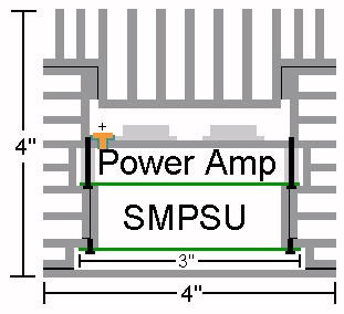

😀 All Right! But it's gonna be hard as hell to compete with commercial manufacturers' prices. I'll have to SELL each channel for around $100. And I'll have to make the cases (with cooling fins and good device mounting surfaces) myself from bent aluminum plate. Not easy to do, but they should look really nice.
Can't you use ready made alu profiles that you just cut? There are quite a variety to choose from. Some should fit your demands.
Unlikely, I have a fairly specific design in mind to keep the modules as compact as possible and so they can be connected to form a unit almost undecernable from a single amp. I'm using TO-3 output devices, and they must be completely hidden because of their live cases. I need a cross section something like this. There will be a 92 cm fan at one end, and a panel with input, volume, gain, Xover controls and power connections on the other. There will be holes in the sides for air from the fan that goes inside the amp to escape from. The - power terminal will be part of the case, and the + will be a strip inside the area where the top of the TO-3's come out which will come out the end to be accessed. This strip will only be in the dominant units, the slave units will be connected via lateral cables within that corresponding area. There will be a plug at each end to connect dominant units at the the amp's input level (after the preamp, so that only adjustment of the controlls on the end unit will be valid. Because of this, each preamp will need to be capable of driving lots of units). There will be a plug on the side to connect slave units. The speaker outputs will be on the sides. The units will be connected end to end by long bolts (or threaded rods with nuts) and side by side with metal plates that screw on. It looks like this might require welding on the fins, but I don't have a TIG welder, nor do I have access to one, but I will when school starts. Are there any aluminum extrusions that look like what I need? I think not. It's OK because I need to keep cost down anyway.
