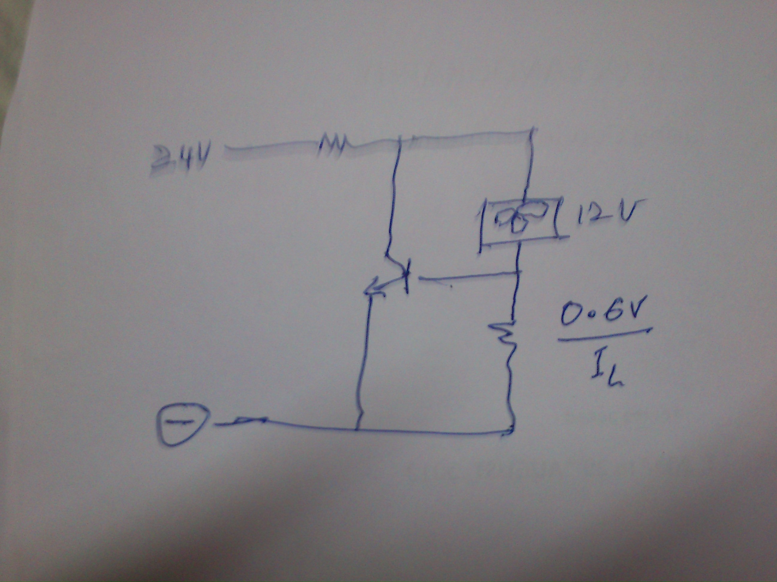

Another option...make a ccs circuit using a transistor. Saves the fan from high currents also.

I'd much appreciate a schematic of your regulator circuit.
Gajanan Phadte
Would you be so kind as to provide a schematic diagram?

😀, linear regulator can get very hot. I use series resistor with fan, and then place 12v zener over fan, to steady voltage, so it doesn't creep up.
I don't care how hot resistor gets, no runaway effect here.
Knowing 12V fan, current draw makes calculating (guessing) resistor easy
Tomorrow.
