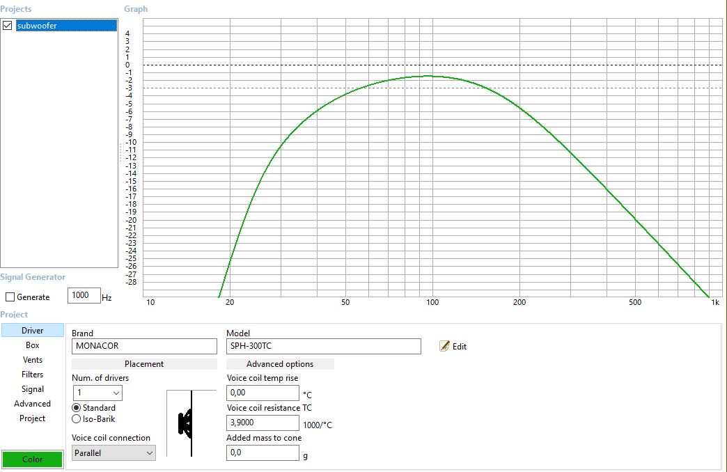

Already made a samplebox in Winisd and i think the driver i chosen is not a good fit.
MONACOR SPH-300TC - 12" Subwoofer
With a 65l ported box (1x20cm vent) and low/highpass filters (25< and 120>) the max SPL is at best -2dB ???
That doesn't seem well, does it?

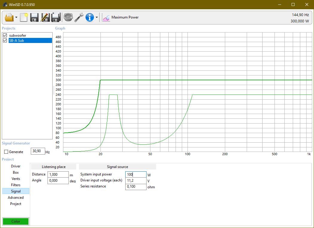

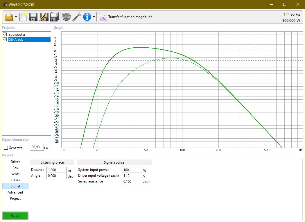

ps: i added two images, in the second picture i compare this driver to a SB-Acoustic, which seems to perform much better. The third image show the max power for both. The Monacar acts really strange here....

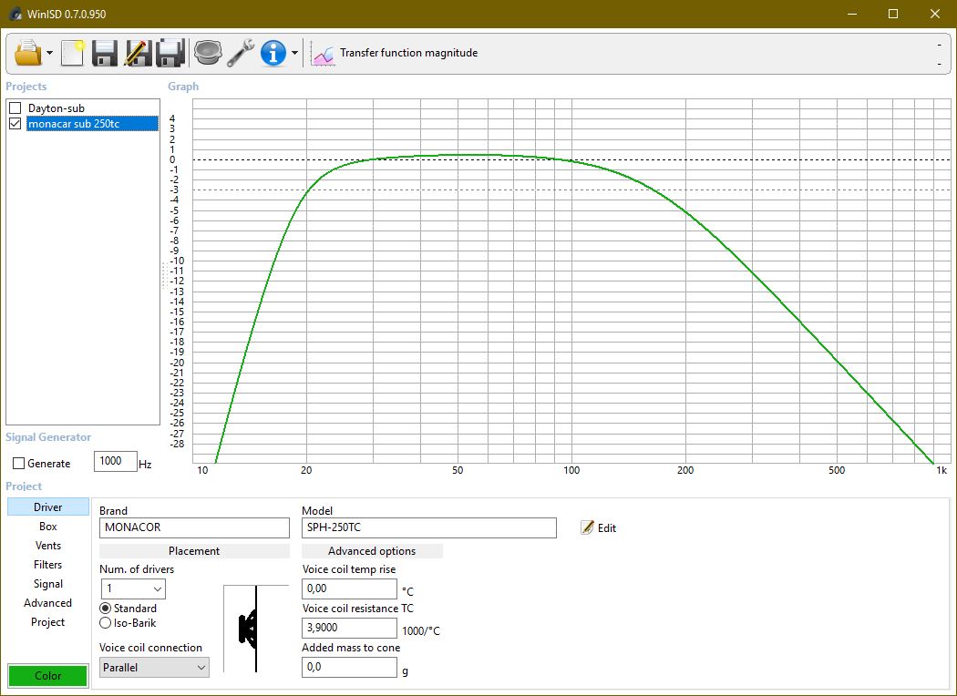

Oke, i tried another type from Monacar, the 250tc 10inch driver.
Meanwhile, i learned you need a linkwitz transform too boost these kind of woofers.
so here i have simulated this Monacar 250TC in a 65liter vented box, with a highpass at 16hz and a lowpass at 160hz and a linkwitz transform.
This looks much better, but am i on the right track here?
What type of filter to use for the highpass for example?
I used the linkwitz here. And the butterfly for the lowpass.

The 300TC driver is a mid-bass driver not a subwoofer. The 250TC seems to be similar. They will run out of xmax quickly.
Are you sure you want stereo subwoofers? 90+% of all recorded bass content is mixed mono and will sound bad over a stereo bass system.
To have the least phasing and comb-filtering effect you want to have the subs together and in a corner of the room.
Keep in mind that if you are going to use it indoors, you will get a big boost on the low end due to room/boundary gain, which will make it sound boomy. (to much low end) A sealed subwoofer has a nice roll off that compensates for the room gain and will sound best.
