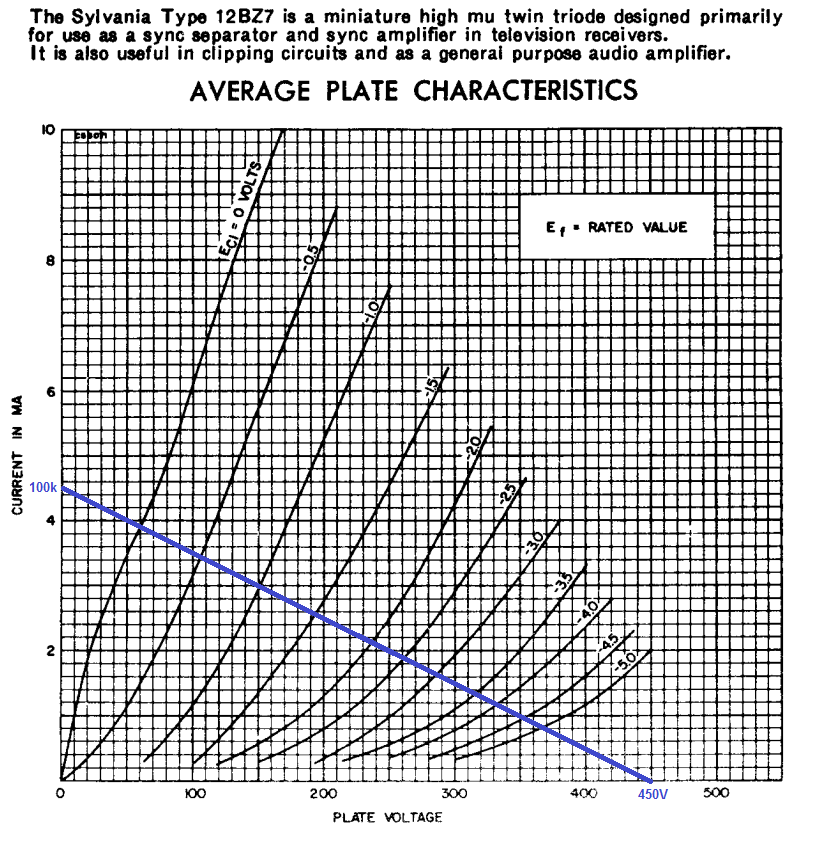

I know that some of the more experienced builders here have stated that 12BZ7 is not very linear, so don't use it. It's probably not horrendous, so might be useful. But if it was good for use in a sensitive spot, like the input stage of a phono preamp, you'd think somebody would have used it by now.
Come to think of it, higher distortion in the input stage of a phono preamp wouldn't be a deal killer there, as signal levels are so low. I wonder if the problem is crippingly high input (Miller) capacitance?
100k loadline with 450V B+ doesn't look inspiring...
It's touted to be like two 12AX7s, but the linearity is decidedly poorer, while still being at least as difficult to use properly.
It looks fantastic for a 1v. input. This tube is meant to drive something like a 6K6, from the same source that would normally use an AX7. The graph of paralleled AX7's would probably tighten up, too. So you get 1/2 the Ra and 2x the Gm. in one tube.... You have to use it for what it was designed for.

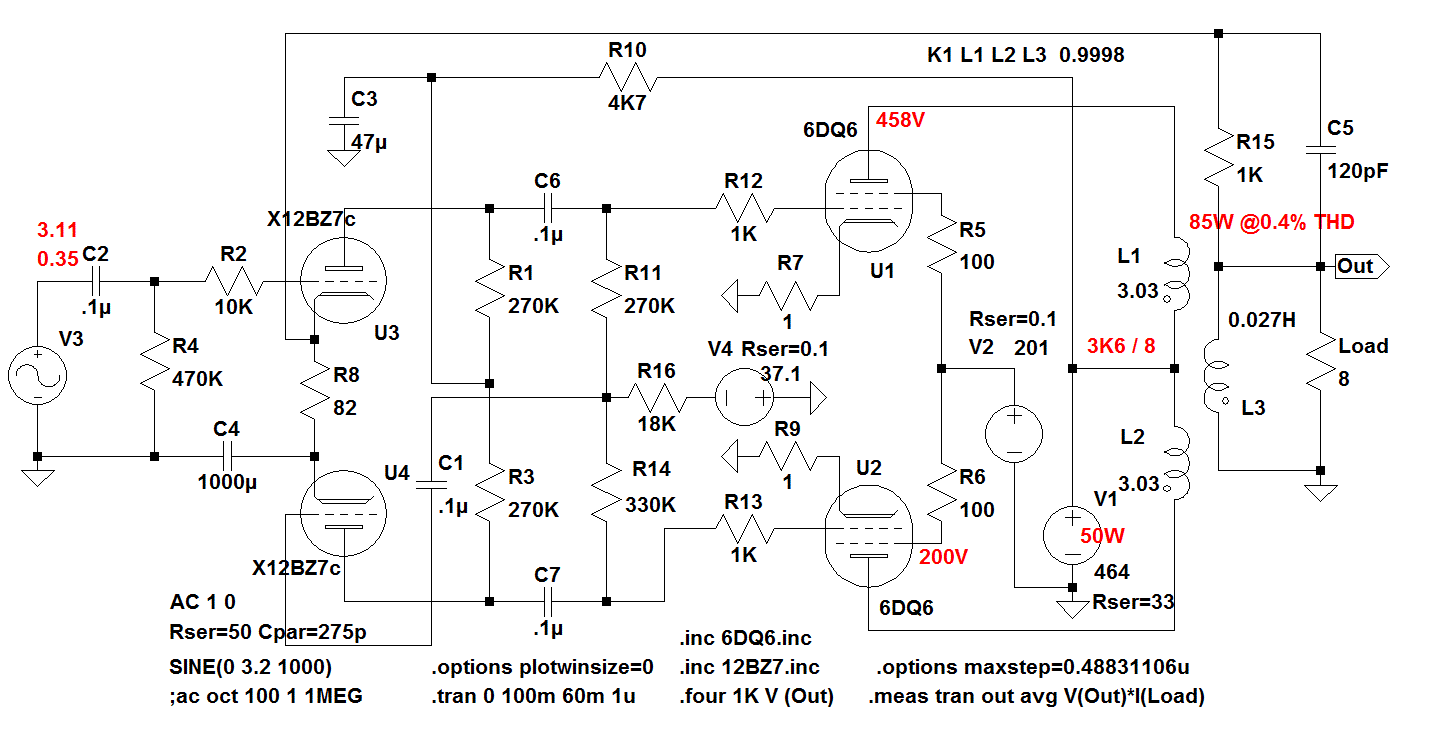

Well, this is what I come out with, just in case someone wants to check the sym..

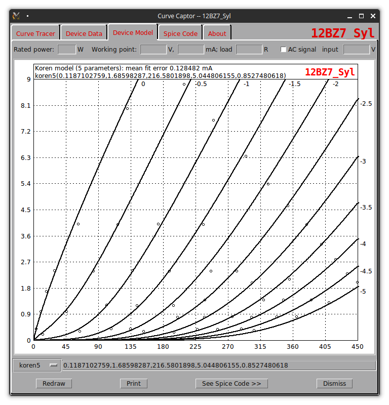

That 12BZ7 model is way off. Try this one... Not perfect, but much better. 😀
Grid current not modeled. Diode is added only to help with convergance, such as a cathode follower that's direct coupled to previous stage.
Code:
* 12BZ7_Syl LTSpice model
* Koren model (5 parameters): mean fit error 0.128482mA
* traced by Wayne Clay using Curve Captor v0.91 and
* Engauge Digitizer on 07/12/2016 from Sylvania datasheet
.subckt 12BZ7_Syl P G K
Bp P K I=(0.1187102759m)*uramp(V(P,K)*ln(1.0+exp((1.68598287)+(1.68598287)*(216.5801898)*V(G,K)/sqrt((5.044806155k)+(V(P,K))**2)))/(1.68598287))**(0.8527480618)

cogsncogs, thanks a lot. I ll try it right now.
Cheers
J.
http://www.diyaudio.com/forums/members/cogsncogs.html
The new spice model shared by cogsncogs yield to less power and more distortion in this circuit, all other things being the same. This was to be expected due the too optimistic results using the old model

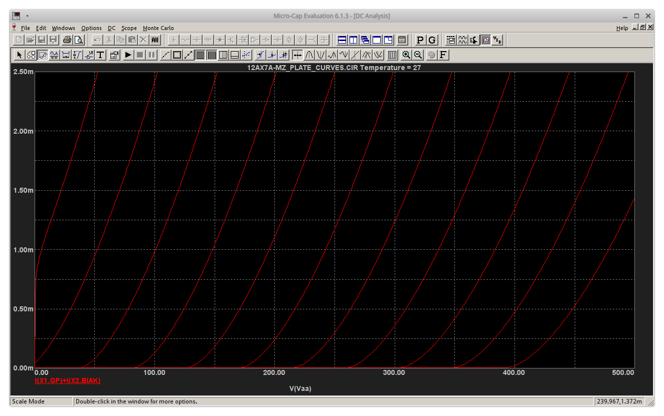

I wonder if one took Wayne's 12AX7 model and paralleled it with Ayumi's 12AX7 model--in other words, create a model of a mismatched pair of 12AX7's in parallel--would you get something similar to a 12BZ7?
I ran your idea through Micro-cap and the result is below in the screenshot. Nowhere near the published curves, which look a little 'flaky' to me.I wonder if one took Wayne's 12AX7 model and paralleled it with Ayumi's 12AX7 model--in other words, create a model of a mismatched pair of 12AX7's in parallel--would you get something similar to a 12BZ7?
That suggests that the 12BZ7 does not equal two 12AX7 sections in parallel. It's a different tube with different characteristics.

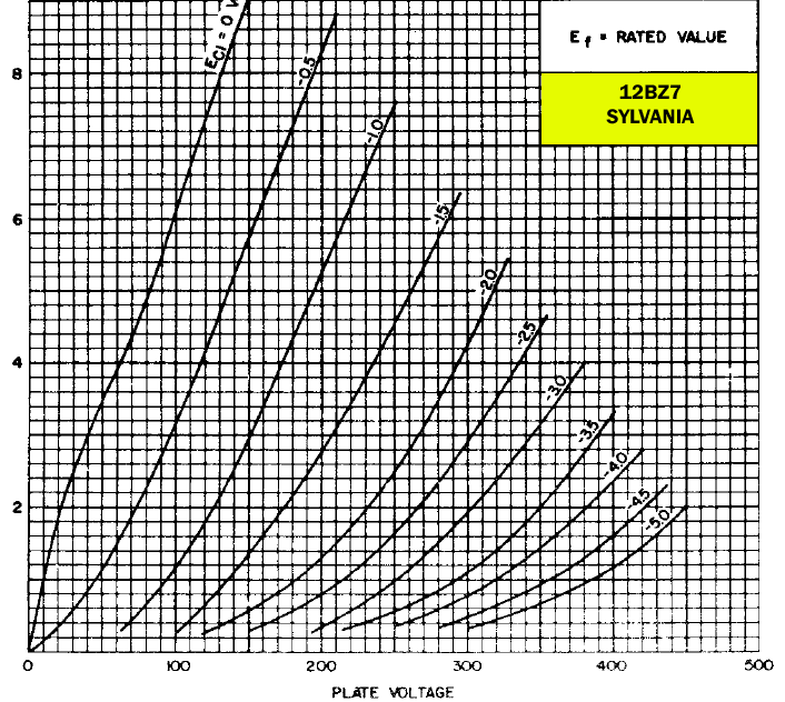

I've tried a couple of 12BZ7 tubes, once in a Fender guitar amp and once as the LTP phase splitter/driver for a little PP 6CK4 amp (old JC Morrison design). In neither case did I think 12BZ7 was anything at all special. I think it might be useful in the LTP phase splitter stage of a Fender guitar amp, in place of a 12AT7. You'd get more gain that way, and it would stay at a better operating point than would a 12AX7 in that place.
The published 12BZ7 curves look really awful at high plate voltages with low-ish plate current. Running it with low plate voltage and high current would force you to use low grid-cathode voltages too, which risks inducing grid current. The shape of the curve for Ec = 0V makes me think grid current would be a problem with grid voltages close to 0V.
Ep 155V, Ec -1.2V, Ip 2.4mA looks like a good spot, but only if there's not a lot of voltage swing needed.
Although it's not mentioned in the datasheet, but by just looking at the curves it looks like it may have a somewhat semi-remote cutoff characteristic. After all it was designed for sync separator/amplifier-clipper in television receivers. It mentions it's use as a general purpose AF amplifier, but that may be because of the high-mu.
