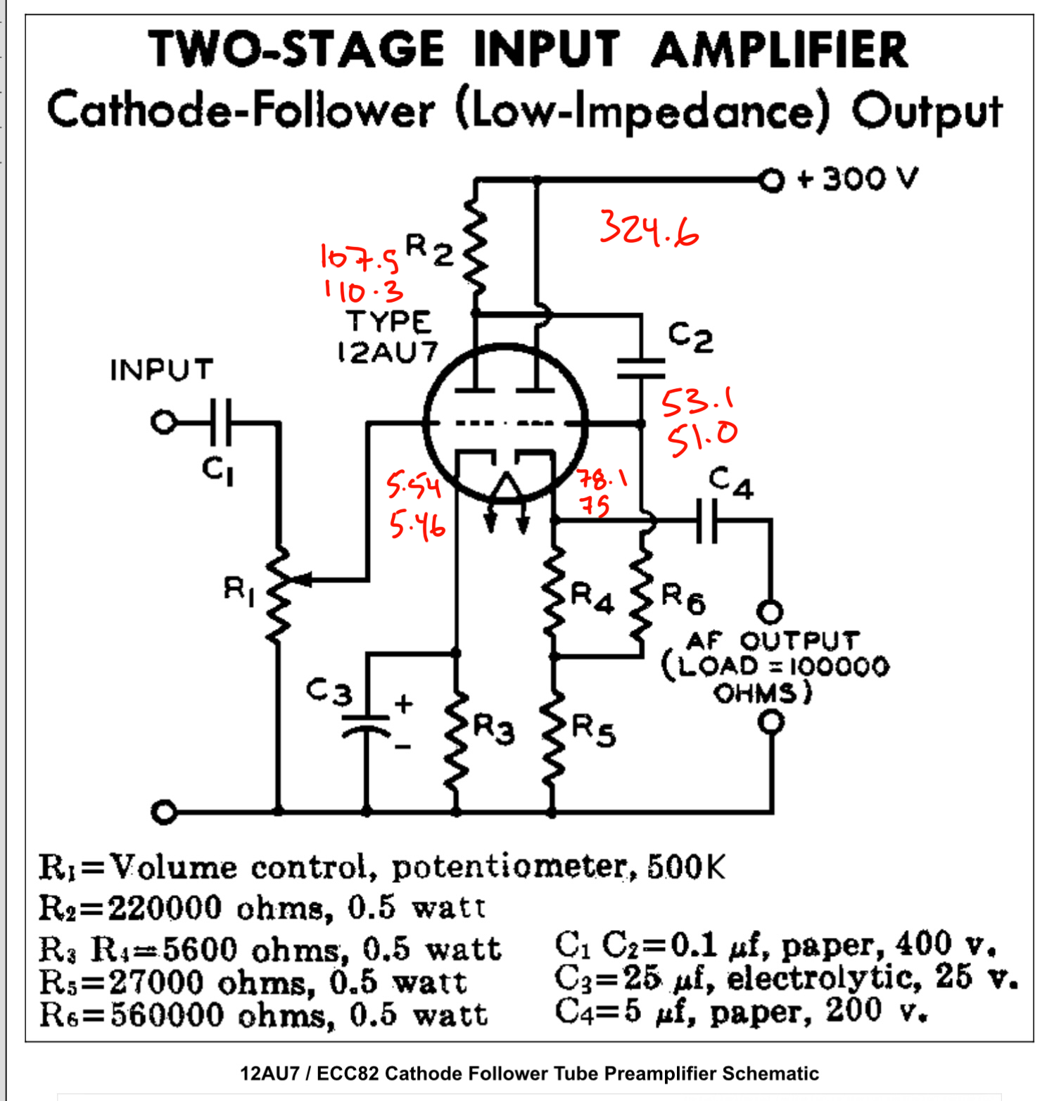

Hi
I built the RCA 12AU7 cathode follower preamp, and I’m finding it to be a bit bright/Sibilant sounding. It sounds bright with both Mullard, PSvane and Electroharmonics tubes in it. And it’s bright with every amp I put it in front of (DIY store Sony VFet, Hiraga Super 30, Type 45 and a couple of others…)
Been reading about subbing a 12BH7 for the 12AU7’s, and from what I’ve been reading, they could help with the top end.
I’m using a Hammond 369JX transformer and an EZ81 rectifier for the power supply. The transformer has 2.5A available for the heaters, which I believe is enough for the 12BH7s and EZ81 (which add up to 2.2A)
Any thoughts on this swap, and if it will help with the bright top end would be greatly appreciated.
Tyanks
P

I can suggest a few things for you to try, without any guarantees. One by one.
1. Add grid stoppers to both grids, as close to the grids as possible. 300ohms to 1kohms,
2. Ground the first grid with 1Mohm to GND (this is mandatory, the potentiometer slider may lose contact),
3. Remove C3 for lower voltage gain,
4. Add a 47ohm resistor in line with C4 (from C4 to output).
5. The operating points can be changed with other resistor values. Let's say the first half of the 12AU7 works with a very low anode current, and the second half is not much better either.

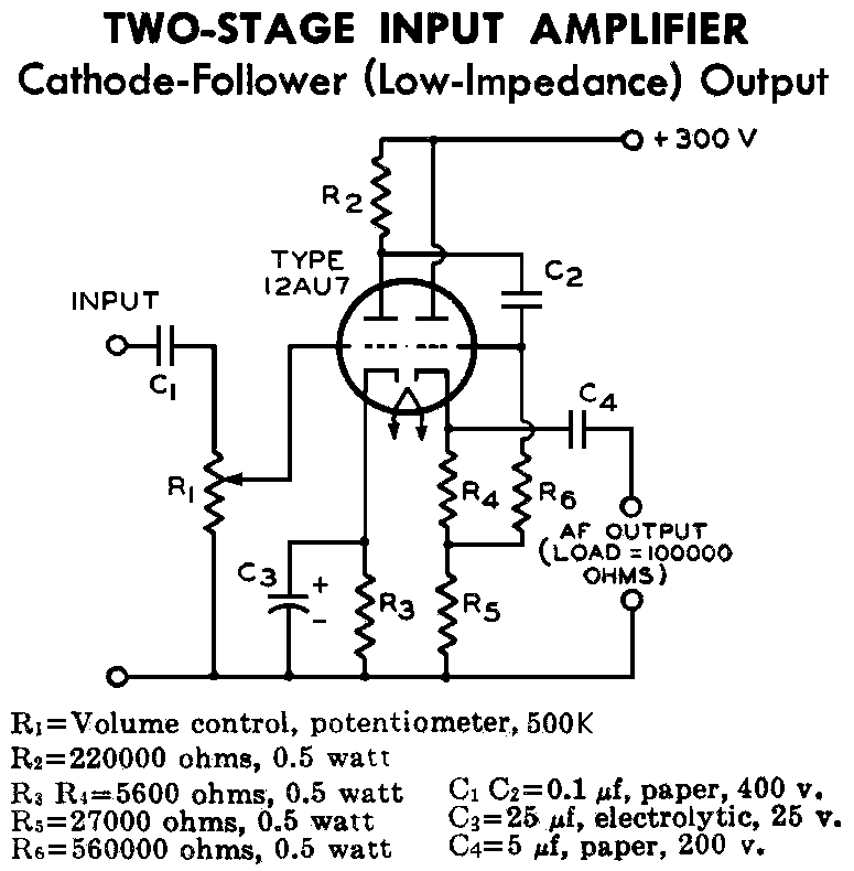

Any chance this is an impedance matching problem? That circuit was designed to drive the amps that they were using back then and you've connected it to several SS amps, yes?
If you look at this 12AU7 Cathode Follower design from CascadeAudio, you'll see that by moving the volume pot to the end of the signal path the output impedance can be lowered, resulting in a more suitable match for SS-based amps.

The cathode follower should have a lower output impedance than the 10k potentiometer. And it is not variable. With a potentiometer, the highest output impedance for an AC signal is at half the value of the pot resistance and equals 25% of the total resistance (2k5 for 10k pot). When the slider is at GND the output impedance is 0.

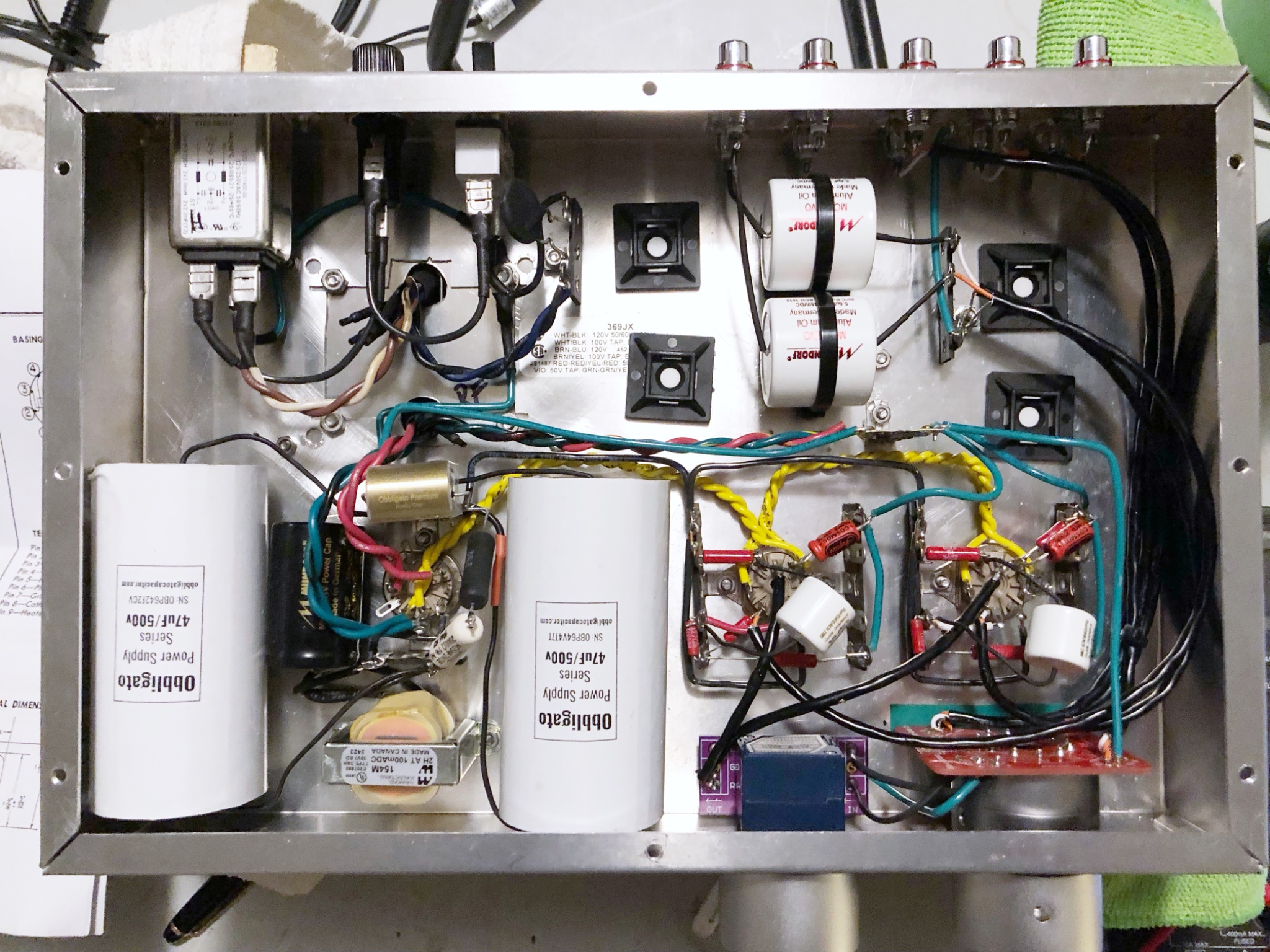

Here is the inside of the preamp
I’ve tried Solen caps, Clarity caps, Russian Paper in Oil Teflon caps and I’m using Mundorf now, solver gold evo oil coupling and aluminum evo on the output.
And here are the voltages I’m seeing. Surprised at the 324v on the power supply. Thought I adjusted that down? And I don’t understand hey there is a discrepancy between the left and right channels. Something is off….
Top number is left, bottom is right.
I built the unit as per the schematic, with the exception of removing the 0.1uF on the input, and I put a 0.22uF on the coupling cap.
