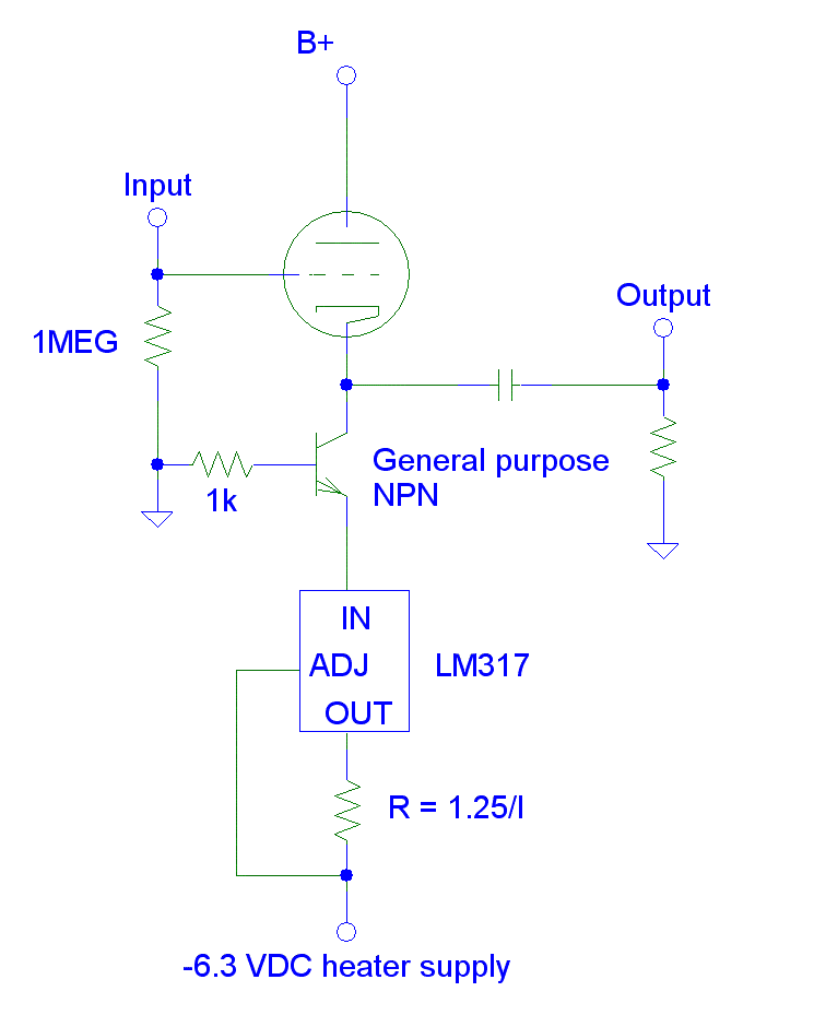

I am very interested in what you have proposed in the current source in the cf cathode circuit. As I am a layman to the solid state component, can you elaborate more (such as what cascode element) and sketch me the circuit if possible if I want 20 to 30 ma current.
Well, 20 to 30 mA is a bit rich for a 6DJ8 which is max rated at 25 mA. 10 or 12 mA ought to be good enough for that triode. The LM317 is not rated below 10mA, IIRC, although I found most to work well at lower currents, if needed.
Here's the general diagram of a LM317 with cascode, although there are many, many variations. I haven't built the CCS exactly as drawn here, but it's pretty straightforward and should work fine. I like to put the heater supply to work to supply the CCS too. A BC549 would work fine for the NPN.

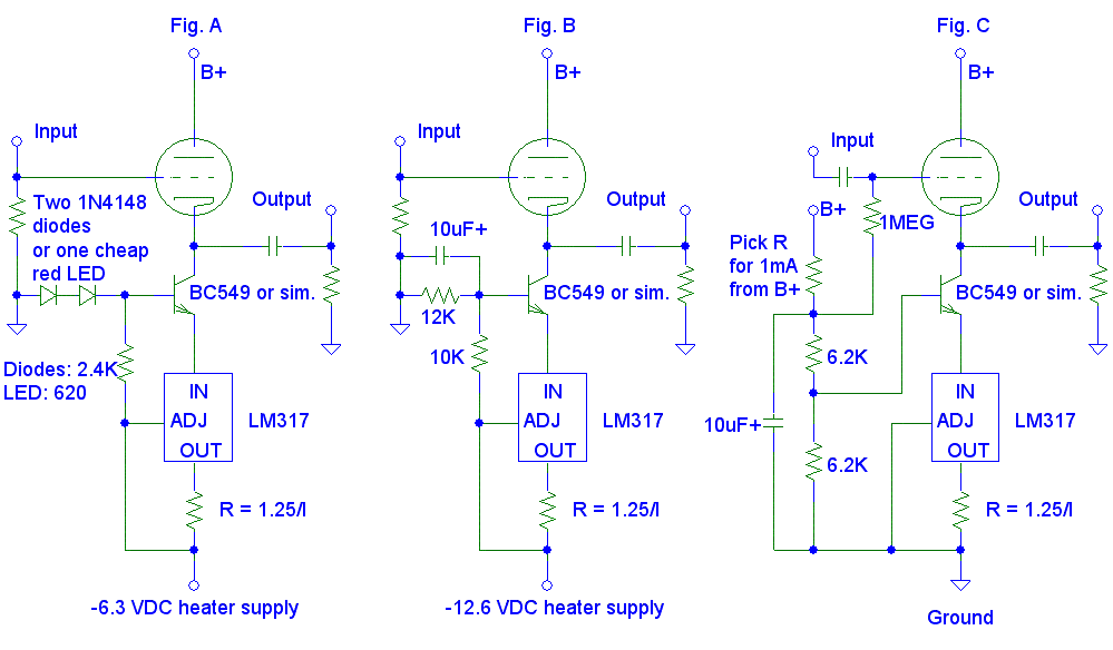

For more headroom...
Snoopyma,
The headroom (before the CCS stops behaving like a good CCS) is limited in my prior posting above, if the triode is a 6DJ8 or any tube with a low cathode voltage (Vgk). If you bias a 6DJ8 at 100V and 10mA, the cathode voltage is about 2V to ground. In the circuit above, the maximum output voltage will be about 1.6Vrms before the CCS’s NPN saturates. This is enough for many power amps, but not all. If using a similarly biased 5687 or even a 12B4, the original circuit should work OK. So I’ve added three variations on a theme below for tubes like the 6DJ8, each of which provides for larger output signal swings that should drive any power amp.
Fig. A shows how to use two signal diodes or a “cheap red LED” (to follow the current fashion) to bias the NPN downward in voltage to allow the triode’s cathode more room to swing.
Fig. B is for tubes using a 12.6 VDC heater.
Fig. C is for when a negatively referenced DC heater supply is not desired or possible. A voltage divider string from B+ biases the NPN base (6+V) and also the grid (12+ V) through a 1M resistor. This option requires the addition of an input coupling capacitor.
As I said earlier, there are many more variations on this theme. One can make better and better CCSs with perhaps double cascodes and other tricks, but the circuits here can get you started relatively cheaply and easily and with decent performance. BTW, here’s a link to my servo CCS variation of SY’s “Heretical line stage” that may interest you.

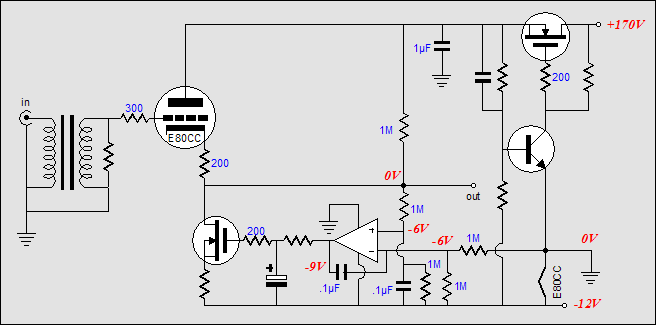

Servo CCS link
Another way to skin the same cat. I really am remiss in not reading all of Broskie's prolific output. I must admit to getting a little restless early on slogging through all of his power supply noise rejection ideas - excellent though they are, and not staying up with his later writing. He is a clever "topologist" and deserves to be read. BTW, I notice here that Broskie has used two poles in his feedback path, first the integrator, and then the unspecified R and electrolytic cap, presumably to remove the opamp's residual signal output . I did something similar with my C2 in the posting linked above, but did so with some trepidation, and only at a relatively high 160Hz, to avoid underdamping the loop.
Brian: This is not a previously-published circuit of Broskie's; he gave me permission to post it here.
The second pole was at my suggestion for exactly the reason you surmised. I just don't trust summing junctions. The pole can be pretty high; in my old preamp, I set the second pole at 50 Hz, figuring that even a crummy opamp can do very well at those frequencies.
