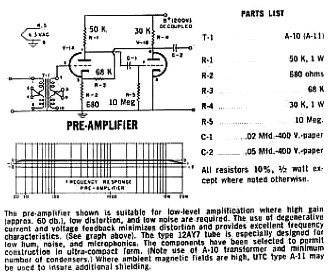

6SL7 is higher Mu and another good thing to try in the type of circuits 12AY7 would normally be used for.

Yeah I had kinda come to that same thought. I had looked at 7F8 or 7F8W as being close. But that tube looks like it's more for RF service NOT audio.

I was looking at the Preamp circuit shown there.

7F8(G) _IS_ two 6J5, which is an excellent low-gain audio tube.

OK, why??
It is a mike preamp. There is no place in a Hi-Fi rig for this much flat gain (60dB!) or low input impedance (500r).
The internal output impedance is like 5KXXX 15K, but the 0.05uFd output cap will suck bass driving even 200K load.
It needs (we didn't know) a higher-gain tube than 6SN7 or 7F8. Mu=20 will give hardly-any NFB.
The bias on the 2nd stage is just grid-leak. This works OK even good for very small signals, but at the end of a HIGH gain amplifier we expect BIG signals. The bias is uncertain and so is the headroom. In any case this bias scheme wants high-Mu triodes. The 6J5 and kin barely qualify.
Frankly the idea here is to sell transformers.
Whatever your "preamp" needs, you can do better.
OK, well good to know. That page is what follows the UTC W-20 & W-10 amplifier. They simply advertised it as "Auxiliary High Fidelity Equipment" A variable Equalizer and the Pre-amplifier. I had assumed they intended these two circuits to be on the front end of the Williamson amp.
