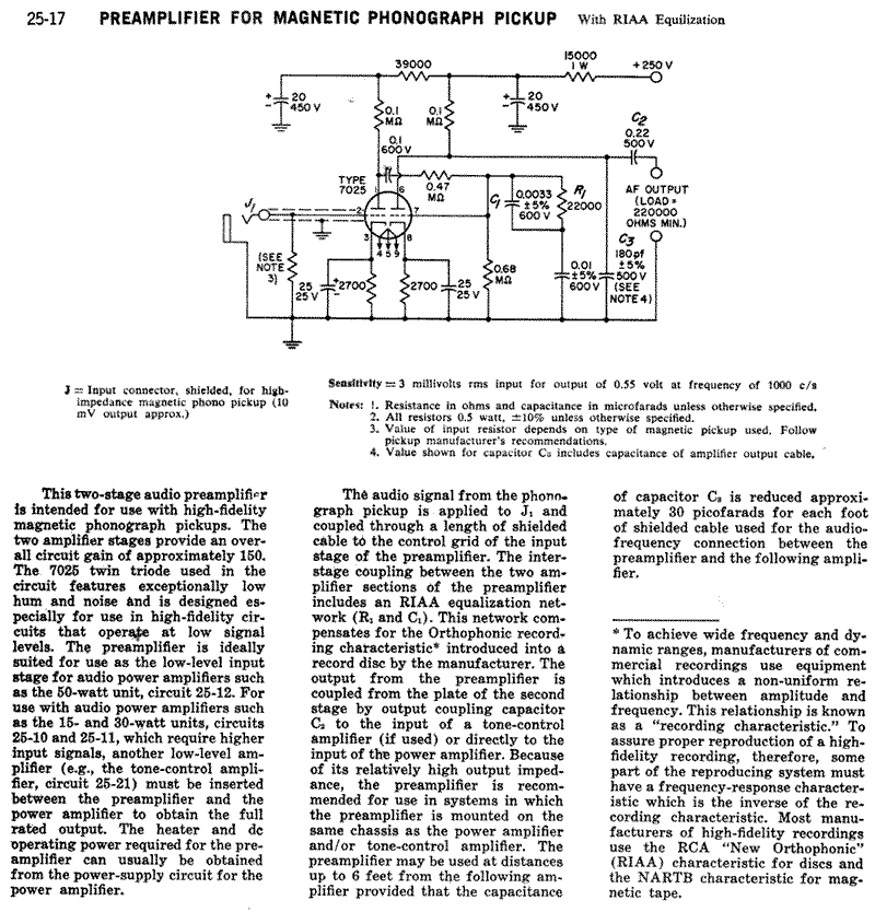

This is the RCA '70 databook one, I add one 2 years ago into a old Emerson Receiver made only for ceramic pick-up, it sound very well !Look for the Ear 834P schematic. Easy to find.

I also have the 1956 RCA databook and the phono preamp is different, it use a venerable 6SC7 twin triodes for each channel. But also for high load impedance, of course.
