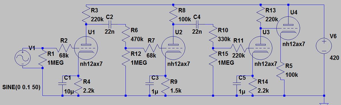

Hi all, i've been trying to design a fairly high gain amp, (4 gain stages and a cathode follower) im using a +HT voltage of about 400v and i was thinking, what would be the best way to do this? i was thinking of cold biasing so that one side of the wave is clipped in one stage, and the other side in the next, or should i just centre bias everything and get as much gain as possible? the 2nd option seems the best but that would mean the output signal from the preamp would be a bit under 400vp-p this seems to be quite high, or is this normal?
Output from preamp is not likely to be 400v p-p. You may be basing that on maximum hypothetical amplification factors instead of real world results. Best bet is to check out some common schematics for amps you like and go from there.
I will add to that comment that so much gain is not desirable. Starting with, say, 100 mV of audio you can get all the distortion you can stand with a single gain stage. If you want overkill, put in two. But four? Might as well use a square wave generator.
And 400 V is way too much for those tubes. They run fine on 100V.

400V of output from the preamp is silly. As the output grids will
forward conduct long before that. Even cathode follower "driver"
grids will forward conduct and you will be in blocking distortion
(not the kind of distortion you are looking for)...

You should be able to get sufficient overdrive/saturation/sustain for most lead sounds from 3 stages BUT for the total shreader massively overdriven sound 4 stages is not that unusual. 4 stages are however difficult to design. You need interstage attenuators to make sure you are not overdriving the subsequent stages too much. you need big grid stoppers, not for their "stopping" function but to provide real HF roll off and limit grid current, you need to limit the amount of bass to prevent muddiness (small coupling caps and small cathode bypass caps) and noise becomes a serious issue. To control the noise you need to keep grid to 0v impedances low and the interstage attenuators can actually help with that.

thanks! i have been looking at a few schematics, mainly the mesa dual rectifier and peavey 6505, dropping to 3 gain stages does sound ok, but il keep room in the chasis incase i decide to add another. but what would be an ideal impedance for the inputs?
I suggest - as low as possible. Noise is your enemy - in all its guises - you can't be too finicky. Maybe even make a list of all the tricks you aim to through at it - so that others can add in more.

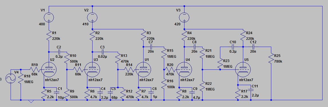

ok ive gone over a few other schematics, asked a few people and thought up a new idea, ive gone back to the 4 gain stage idea but im thinking of using a triode with NFB as the output instead of the usual cathode follower, any comments or ideas on the new schematic will be appreciated!
Thank you for the help so far!
the 780k resistor shown (R25) would be the tonestack and volume control, LTSpice says theoutput here at the gain level shown, is 240vp-p

Tone stack and volume all at the end? I dunno, doesn't feel right to me, not the best way to drive the power amp. But I'm not exactly an expert on this stuff 🙄
the tone stack goes to a cathode follower to drive an effect loop and then theres a gain stage after, all in series with the preamp hehe
Keep in mind that the tone stack will probably (depending on design) attenuate quite a bit, assuming you'll settle for a passive circuit. A cathode follower after the stack won't provide any gain, so you'll probably be driving the effects loop with a tiny signal.
Also modeling the tone stack as a fixed 780k impedance doesn't seem very realistic to me; I suspect the actual impedance will be a _lot_ lower, and it's probably going to be variable depending on the topology and the position of the controls.
Regarding the gain stages: is there any particular reason to throw away half of the signal after every stage (or even 90% after the third triode)? I'm sure you put some thought into this, but did you simulate the performance of this circuit? Does it seem to work as intended? I'm assuming you're following gingertube's suggestions here, so I'm only checking if the implementation is effective.
Apart from the above, if you're looking for a super-overdriven sound, wouldn't it be a lot easier to just put some diodes back to back, use two gain stages and some frequency shaping? Sort of like a Boss metalzone pedal with tubes?

I"ve modeled the Trainwreck Liverpool tone stack with all settings at noon and it comes out close to 100K impedance.
A cathode follower makes sense to drive a tonestack, as the impedance varies a lot with other settings and will see peaks and dips. It does not make sense following a tonestack. You need a good bit of gain after it because it really attenuates the signal.

I've built two Liverpool inspired amps (all Soviet tubes) and they tend to be very noisy due to the high gain. There are a lot of threads on The Amp Garage related to this issue and there seems to be no single simple solution.

basically i was thinking of the effect loop, how much signal out is ideal? 200vpp into a pedal running at 9v doesnt seem right, and i thought a tonestack impedance would be lower. i dont want to use any solid state stuff, cheating...
and as for the attenuation, this is what ive found is about normal, and this design is quite similar to the peavey 6505+ lead channel, thats the sort of sound im looking for. in the simulation this seemed to work as intended, but like i said whats a good signal output to send to the effect loop and how much would the tone stack attenuate the signal?
