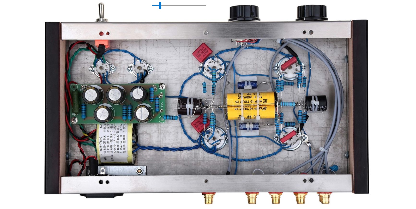

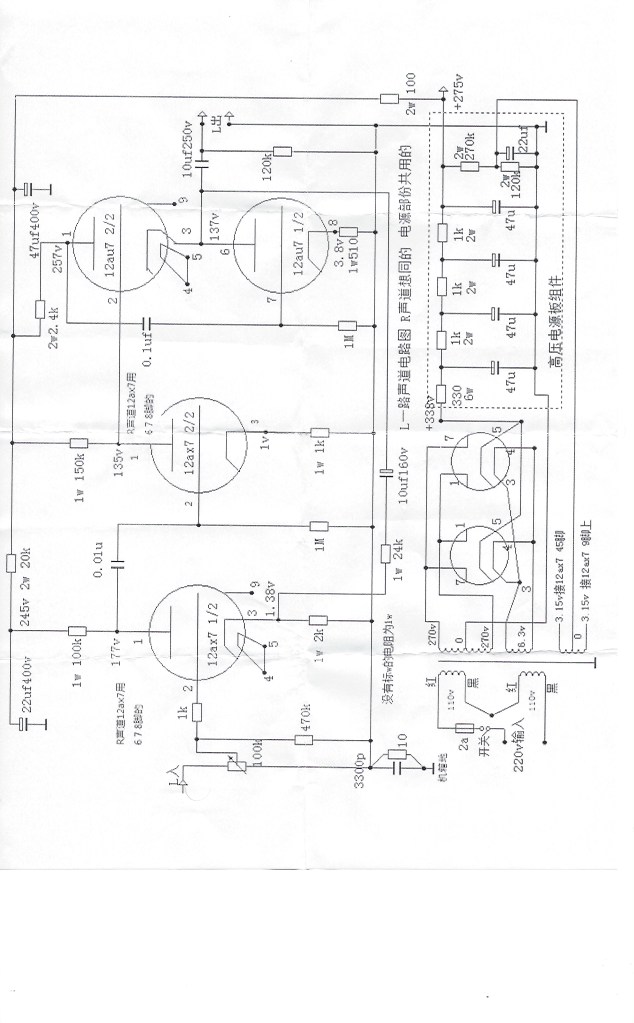

Has anyone else built this kit. I'm new at building amps and I've been slowly going through the circuit diagram. However I was wondering if anyone has some pictures of the inside of amp, showing the wiring and connections, which I can use as a guide with the circuit diagram I have.

The picture shows how not to wire a heater, for one of them. The valve at top centre has the heater wires encircling the valveholder, to get to pins 5 and 9?. All the books say this is the wrong way to do it as it maximise magnetic hum field at the valve.
Of course, it may use DC heaters, but then why bother to twist at all?

Thanks for the info everyone. I've been using google translate to translate the chinese on the circuit diagram.
I'll definitely won't follow the pic in too greater detail, as agree I want to minimise hum as much as possible

Thanks for your help. Looking at the images of the circuit diagram and also the physical image of the circuit. It looks like it's using the chassis as the ground bus. However I can't see how that connects to the neutral. Also it looks like from the photo, they haven't earthed the chassis. Any thoughts?
