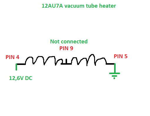

I am going to use 12AU7 in the input stage of hybrid amplifier and I am going to use DC for the heater (prefered 12.6V). The supply will be stabilised at approx 12.4V.
Can I leave pin 9 not connected to anything ?

Yes it's ok..
It's there in case you have a 6.3 volt heater power supply instead, so you connect 6.3 volt between pin 9 and pin4+5 combined.
Not sure about connecting pin 5 to ground. Depending on your schematic, it may need to be elevated.
And I have another few questions.
1. Would be recommended to put NTC thermistor in series with heater as a soft start for heating ?
2. Heating time is approx 11s, what is happening with bias current (cathode current), is it slowly rising up while heater is reaching its nominal temperature ?
If there isn't a soft start circuit or B+ is unregulated the cathode sees it's full voltage immediately. Regulators provide a slow start up, it's faster than the heat up time, but it's still slow enough to watch on your DMM.
Whether or not you need a soft start will depend on your circuit, and is beyond my ability to answer. I'm sure someone here will chime in.
No need for a soft start, unless your 12V supply can't cope with the initial current surge. This is a common problem found by people using DC heaters; their regulator goes into shutdown mode due to overcurrent protection.
Cathode current will rise as the cathode heats up. The rest of your circuit needs to cope with this.

I was speaking of the initial current surge into a cold valve heater, not the inrush current into a discharged reservoir cap. Big caps can increase inrush, as can big transformers, but this is a quite separate issue.
The surge into a valve heater can be 3 or 4 times the normal 'hot' current, so if someone designs a DC supply using a normal regulator and does not take account of this the supply may never come on properly. You take account of it by ensuring that your supply can deliver the initial current for at least a few seconds. I don't use DC heaters myself, so I am only going by the cries of newbies on this forum.

All valve heaters fed from a voltage supply, whether AC or DC, have a current surge as the cold heater has a much lower resistance than a hot heater. An AC supply and some simple DC supplies usually limit this a bit by their source impedance. A regulated DC supply has, by design, a very low impedance so this maximises the surge. One option is to make a supply for a slightly higher voltage and add a dropper resistor - wastes power but if you were worried about efficiency you would not be using valves at all. Alternatively just make sure the supply can cope.
No need to delay HT/B+ voltage with normal valves - this is only needed for some very high power valves, such as those used in transmitters and serious PA. Elsewhere, the surges caused by such delay can create their own problems.
