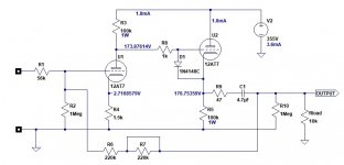

I found and resurrected an old Concordant pre I cloned about 30 years ago. But I have loads of 12AT7s, but only two mismatched 12AX7s. And less gain would be nice too, but my question is, can I simply sub the 12AT7s in place of the 12AX7s without causing damage? I realise I will eventually have to recalculate the resistor values for the 12AT7s, and change the output caps to keep the bass response, but would there be any initial risk in swapping them?
A 300k ohm plate load on a 12AT7 would probably result in that type of tube being run very cold-biased, too close to cutoff all the time. It would probably make sound, but it would not be an improvement. It's a simple enough circuit to re-design to fit 12AT7/ECC81, though, if that's what you want to do.
If it works, you won't do any damage. You're definitely going to have to make adjustments to get it working right though.
would there be any initial risk in swapping them?[/IMG]
Probably no risk, but check the DC voltage at the input plate to see if it's at
a reasonable point. The plate resistor is rather high in value for a 12AT7.
You'll have to recalculate all the resistors.

Surprisingly little change in net gain will be observed, after things are squared away. Remember, the gain of a common cathode triode is function of both μ and RP. The 12AT7's lower μ is compensated for by its much lower RP.
I suggest the substitution not be made. The 'X7 triode is more linear than the 'T7 triode. Nice current production 'X7s are not especially expensive. For instance, Jim McShane charges $33.50 for a matched pair of "reissue" TungSol.

The second tubehalf has it's cathode on 130V whereas the Vfk is 90V max for the ECC81, you have to lift the heater circuit for say 50volts.

Probably all the resistors will have to change. Remember that it's a direct-coupled circuit.
It's not so difficult, replace the 300k by 150k for a ECC81 and you will end-up with allmost the same voltages.Total current by the circuit goes up allmost 1mA.Probably all the resistors will have to change. Remember that it's a direct-coupled circuit.

Include a diode from the 1st plate to the second cathode. It will protect the tube while the heater is cold.
A little more fun with it...
If you change R3 and R5 from 56k to 100k, and R4 to 1.5k, the two 12AT7 triode will bias at about 1.8mA plate current each. Your power supply would need to supply 3.6mA total plate current for a stereo pair.
The gain remains the same. Interesting that the modeled distortion spectrum changes quite a bit, with 3rd and higher harmonics more pronounced. 12AT7 usually works better with 3mA plate current (all other things being equal).

And don't forget to raise the heater supply up to about +85V, to relieve cathode-heater stress on the second stage, at least as much as is possible with a +355V B+.
C1 should be 1uF , R10 100k even with a 10k load the pass frequency is 18hz.

Wow, thanks for all the advice! I should mention that the trafo I have (275-0-275 unloaded) sags a bit under the current load. I will have to open it all up and measure the actual voltages, as I can't remember the details. Replacing it would cost more than I wish to spend, more than a couple of 12AX7s.
Rongon: Increasing higher order harmonics is something I would like to avoid.
Stocktrader 200: The output of the line stage is into the 50k volume pot. Something I would also like to change; putting it in front would reduce the output impedance, no? But reducing noise attenuation at lower volume settings, as I understand it. Doug Dunlop seemed to make these things with whatever he had in his parts bin at the time; the phono stage in this version uses ECC85/6AQ8s (I have one of each in it!), but the Excelsior (a later version) uses 12AX7s! I have the circuit for that, and it runs 315V HT (loaded).
