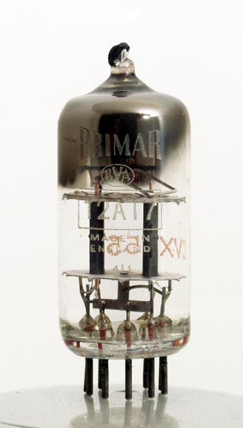

The 12AT7 is a good front end or phase splitting valve.
Unless driving headphones you will need output valve(s) too output transformer etc etc

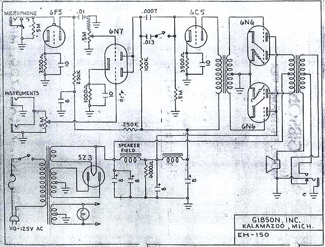

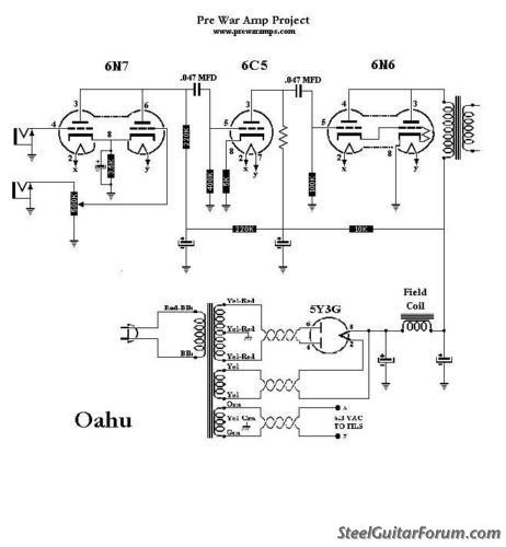

The 6N6 was used in some early guitar amplifiers. Oahu used them SE. Gibson used them PP in one of the versions of the EH-150.

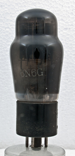

6N6G?
Weird, somewhat usable tube, follow datasheet suggestions:
http://www.r-type.org/pdfs/6n6g.pdf

looking for schematic for prewar Gibson EH150
