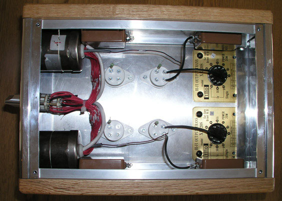

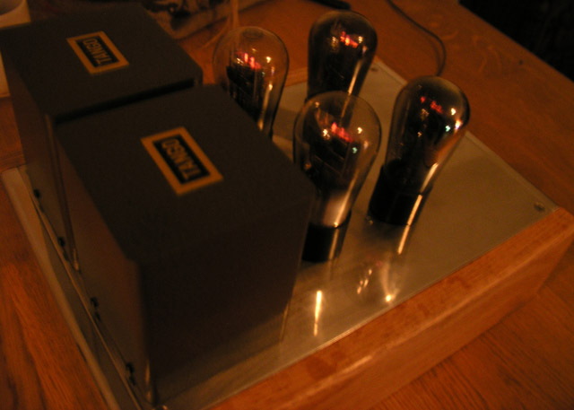

Finally, holidays are here, and I can spend some time finishing my 12A/71A SET.

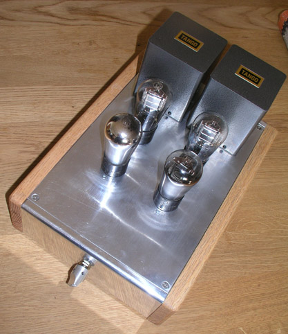

The setup is quite simple, amorphous core volume trannies into UX-112A loaded by Pimm BBMCCCS, coupled by 0.2uF silver mica capacitors to the UX-171A output tubes, loaded by Tango XE-20 S output transformer configured as 5K:16R. Sensitivity of the setup is about 4.5Vrms for full 700mW output. Here's a pic taken yesterday right after drilling and mounting the first bulk of components..
It is originally intended as a horn amplifier for use above 300Hz, but I think it'll have to serve preamp duty also, utilizing the TVC inputs and BBMCCCS loaded 12A's as preamp stage for bass amps...

Hard to get sensitivity on a SE DHT amp without using 3 stages or those elusive KC3, RS242, RS241, etc... I went with cheaper and more available tubes so I could afford to bank 3 globe pairs of each.. Replacements can come in handy when using electronics from the 20's and 30's..

only the BBMCCCS circuits left now, but I need some stuff from the lab and it's easter-closed this week
Perhaps I'll just mount them on proto boards from the local shack.. don't think I can wait a week for them to power up 🙄 I'll figure out what to do in the morning..

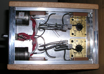

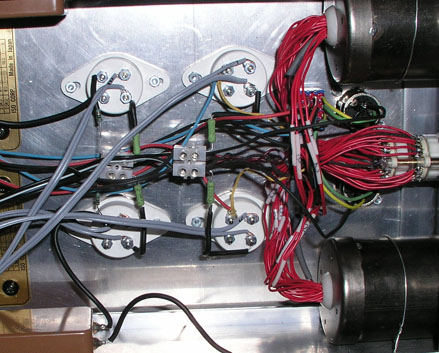

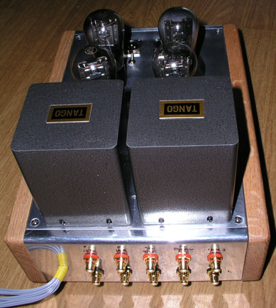

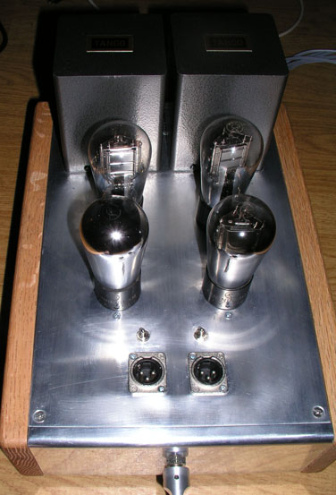

The build has taken a little longer than planned as I decided to put chokes in place of the CCSs.. they're in the mail somewhere.. most other stuff is done though, a switch is wired up for selecting RCA or XLR (only two inputs), and another switch paralells the primary windings of the volume trannies for selectable 0dB or +6dB gain. Even though this is a small integrated amplifier, I designed it more like a preamp, using RCA jacks for all outputs; a passive output, a CF output from the 12A (impedance in the 5K5 range), and 16ohm + 32ohm outputs from the 71A and output transformers for driving headphones and my horns... Inside looks like a bombed ratsnest already...
