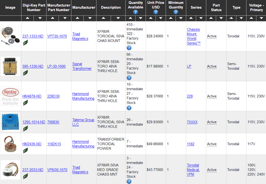

Refer me to suppliers of transformers that convert 120VAC to 15VAC. Mouser electronics? Other suppliers?

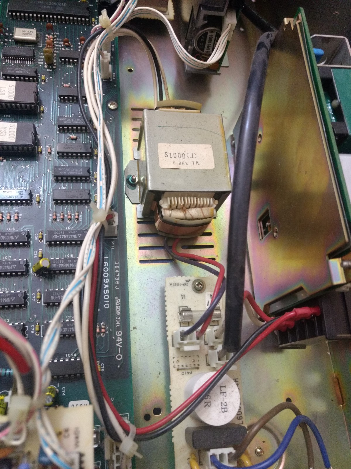

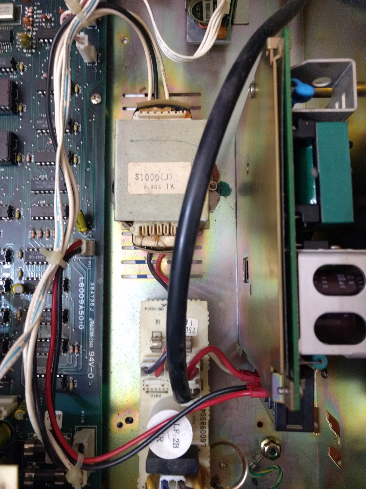

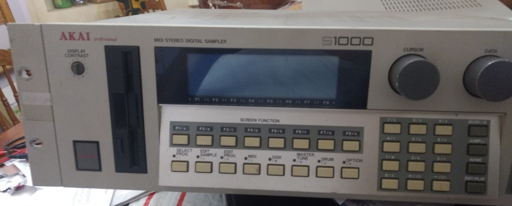

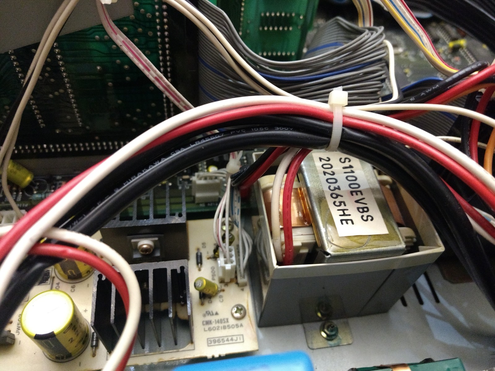

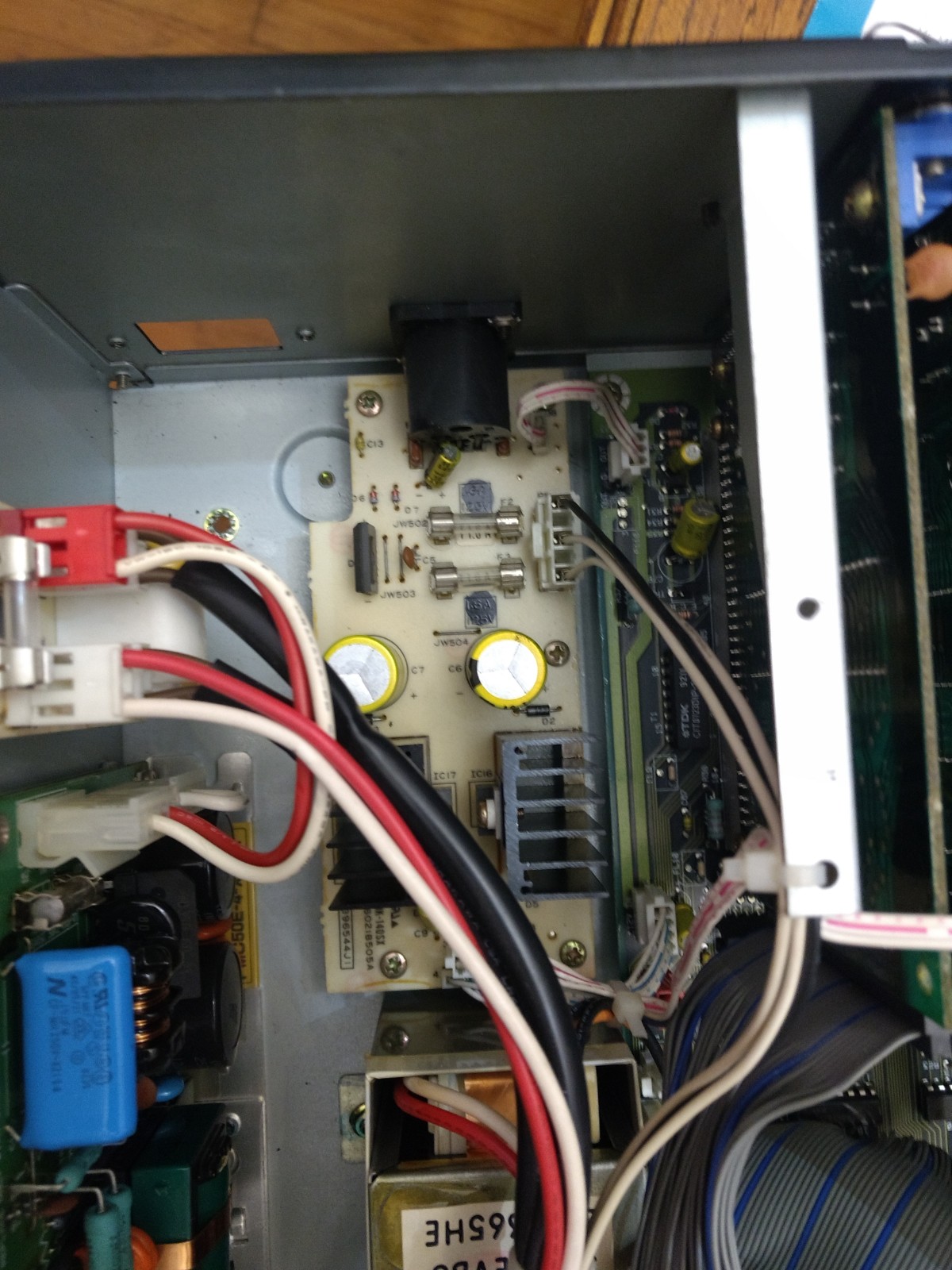

I attached some pictures of what I'm dealing with. One is an S1000 Japanese version which is rated at 100V. It is marked as S1000(J). The other picture shows the S1100 EVBS transformer in the S1100 which is the 240V version. I'm more interested in converting the S1100 240V version first.
You can see pictures of the two white wires and black wire coming out of the transformers. Notice that in the older S1000 the output from the transformer connects directly to the motherboard. In the newer S1100 it connects first to the digital output board and then has three connectors connecting back to the motherboard (probably two of them are data and one power).
The S1000(J) transformer does appear to be configurable. The power wires connect to the bottom of the transformer but there are small copper leads going into segregated partitions in the top of the transformer. I have no idea how to configure these and would feel more comfortable just switching them out with new ones.

The EVBS version seems to feed a small board with a bridge rectifier and two reservoir caps. That makes sense with regard to the three wires as it suggests a split secondary winding giving perhaps 15-0-15 vac. That's the most common form seen in most equipment although we do need to know the voltage.
Things to check.
1/ Does the black wire go to ground (perhaps connected to chassis) ? I'm guessing it also goes to the junction of those two yellow caps which will probably appear to be in series, with the junction of them being ground.
2/ Measure the AC voltage from the black lead to each of the while ones. Is that where your 7.4 volts comes from. You should therefore have around 15 volts AC between the two white wires.
3/ What is the voltage rating marked on those two yellow caps ? That sets an upper limit for us to work to.
4/ The two devices bolted to the heatsinks. What are they marked as ? Is one a 7812 or 7815 and the other a 7912 or 7915 ? or are they something different ?
Its a pretty safe bet that if you read 7.4 volts AC between black and either white wire that we are looking at a 15-0-15 transformer.
It looks quite a good quality transformer having a copper 'belly band' around it for low leakage... a typical Japanese type of construction. For low impedance line level circuitry its not such a big deal though.
The S1000J unfortunately doesn't look configurable. The two thin wires on the transformer will be for the primary, the two thicker ones look to be for a thermal fuse embedded in the windings/construction of the transformer. So ultimately it is in fact a single voltage primary 🙁

Examples might be like this:
https://uk.farnell.com/multicomp/mcta060-15/transformer-toroidal-2-x-15v-60va/dp/9530436
http://www.farnell.com/datasheets/2...46.327530231.1534874973-1577493477.1533651991
