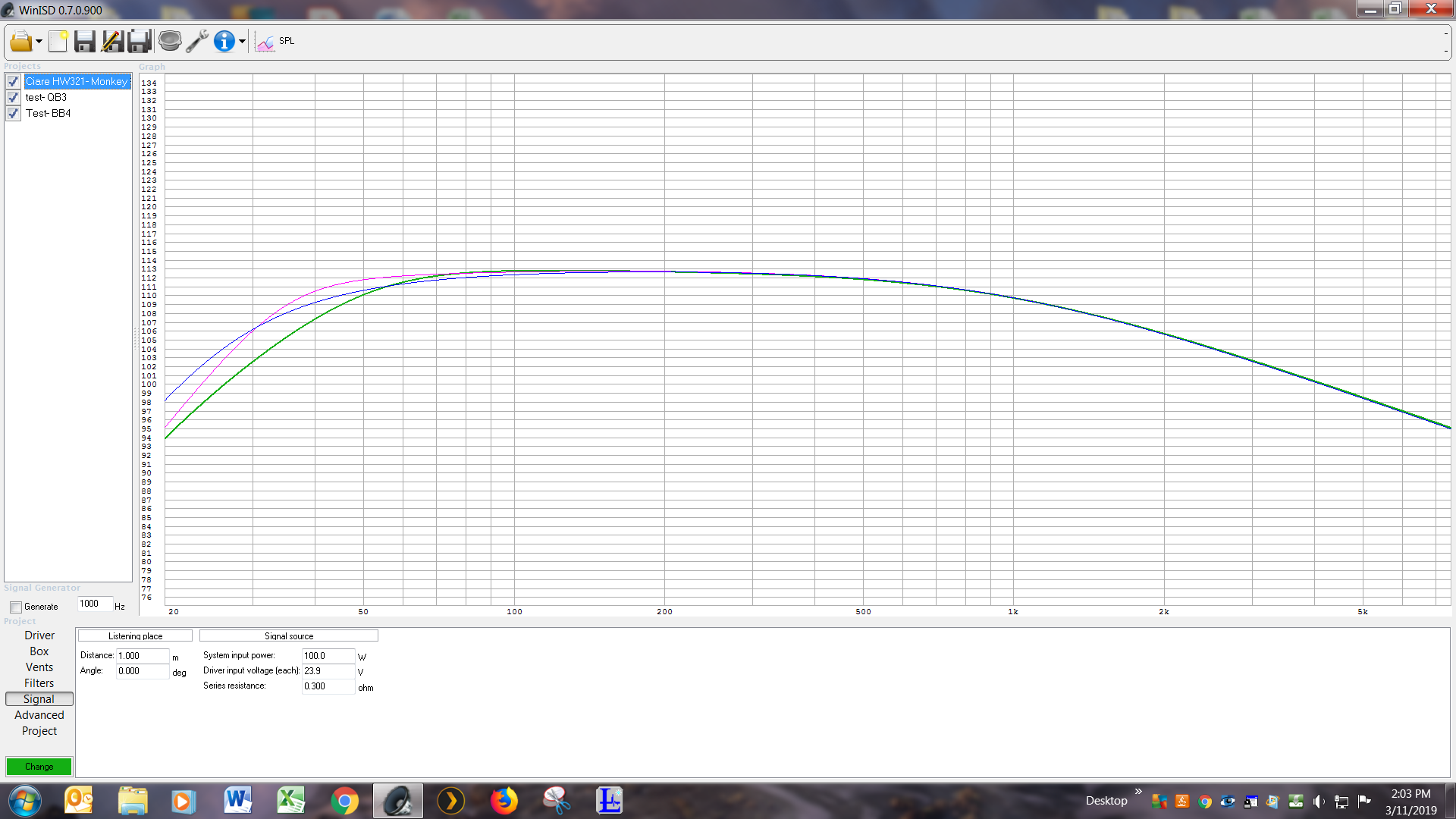

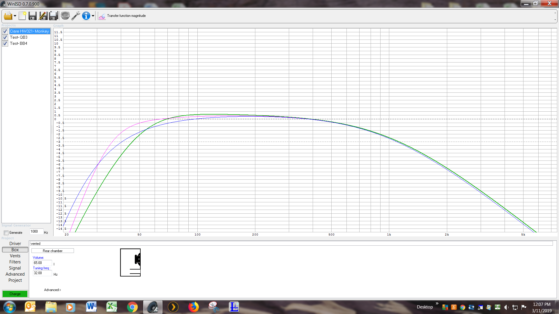

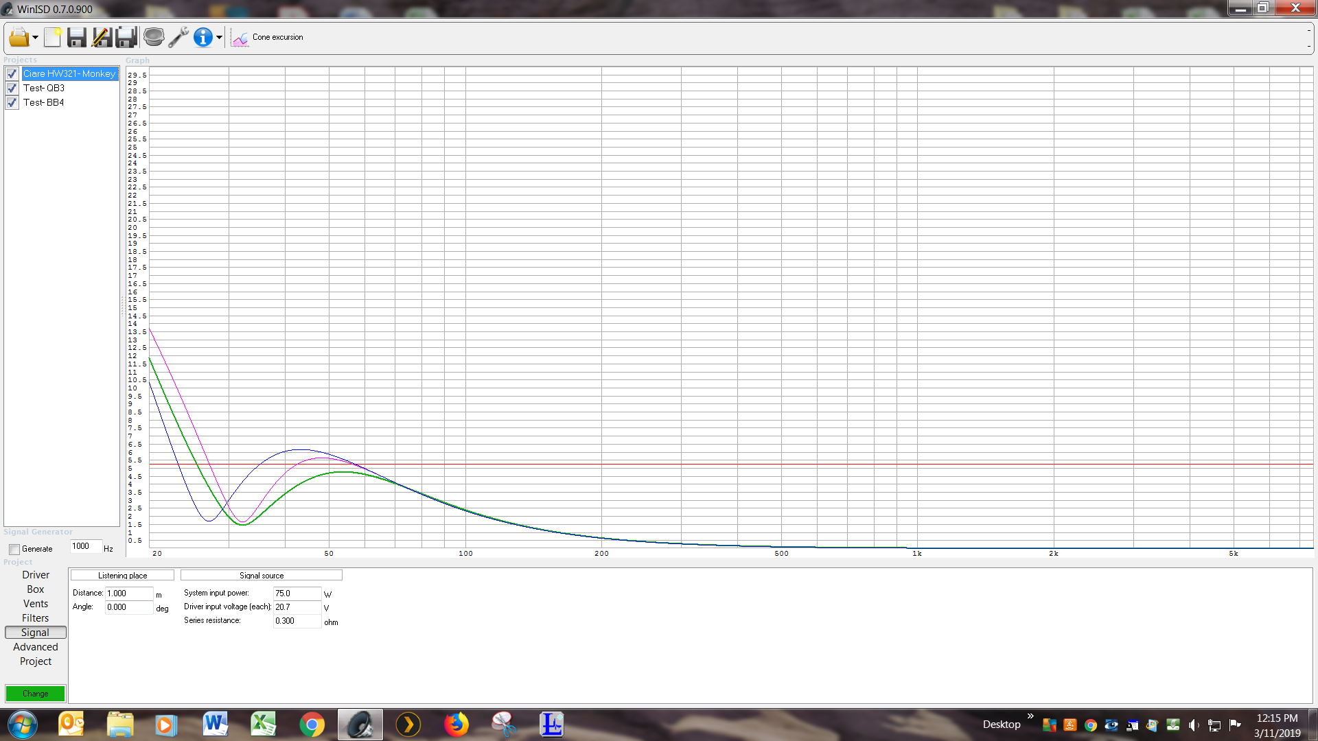

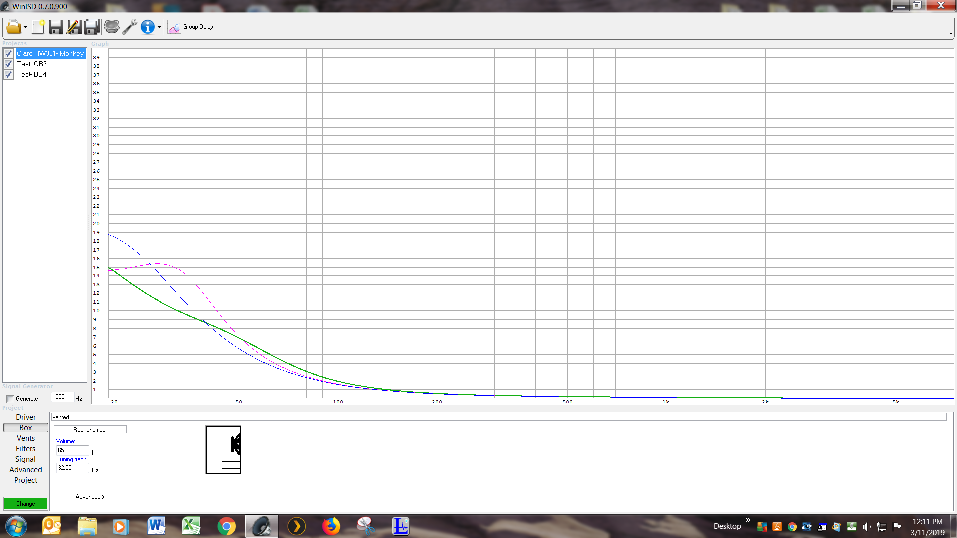

I been looking at various 12" woofers that might work well in a 65 liter ported enclosure. The Ciare HW321 has caught my eye but it appears to require a larger cab. According to WinIsd, somewhere around 95 liters plus is standard for this driver. At least to achieve QB3 or BB4 alignments. My question is can this driver work well in less vb then optimum? I have attached some screenshots for comparison.
Green= 65l @ 32hz
Magenta= 99.65l @ 32hz (QB3 alignment)
Blue= 98.52l @ 27hz (BB4 alignment)
Best,
Rich

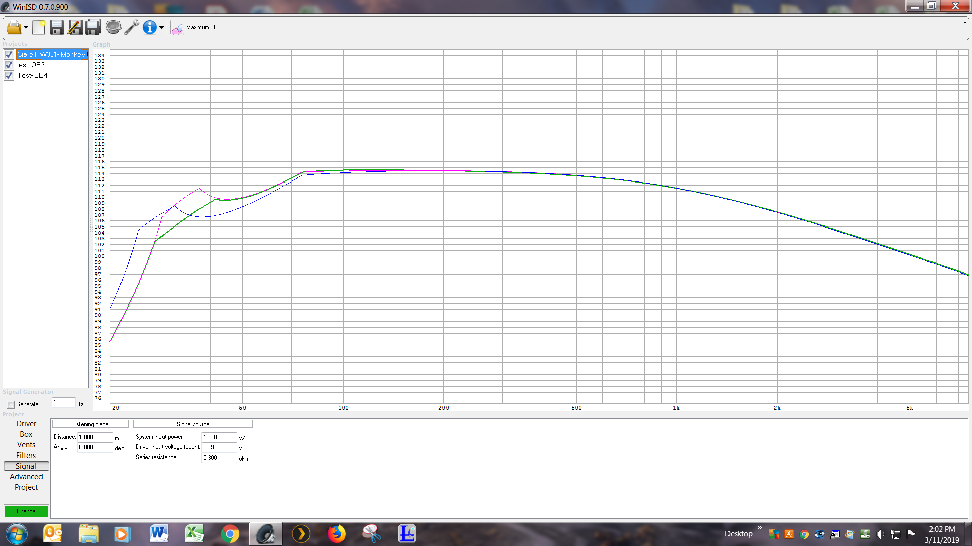

the system will be less sensitive.
but it can still be ok. just not optimum.
also it depends somewhat on the driver. if it has a strong magnet.
looking to your sims, driver excursion decreases as does output, when compared to the other alinement's
so you can 'make up' some of that output by driving the driver to same excursion.
so long as the magnet is strong and the voice coil can take the power.

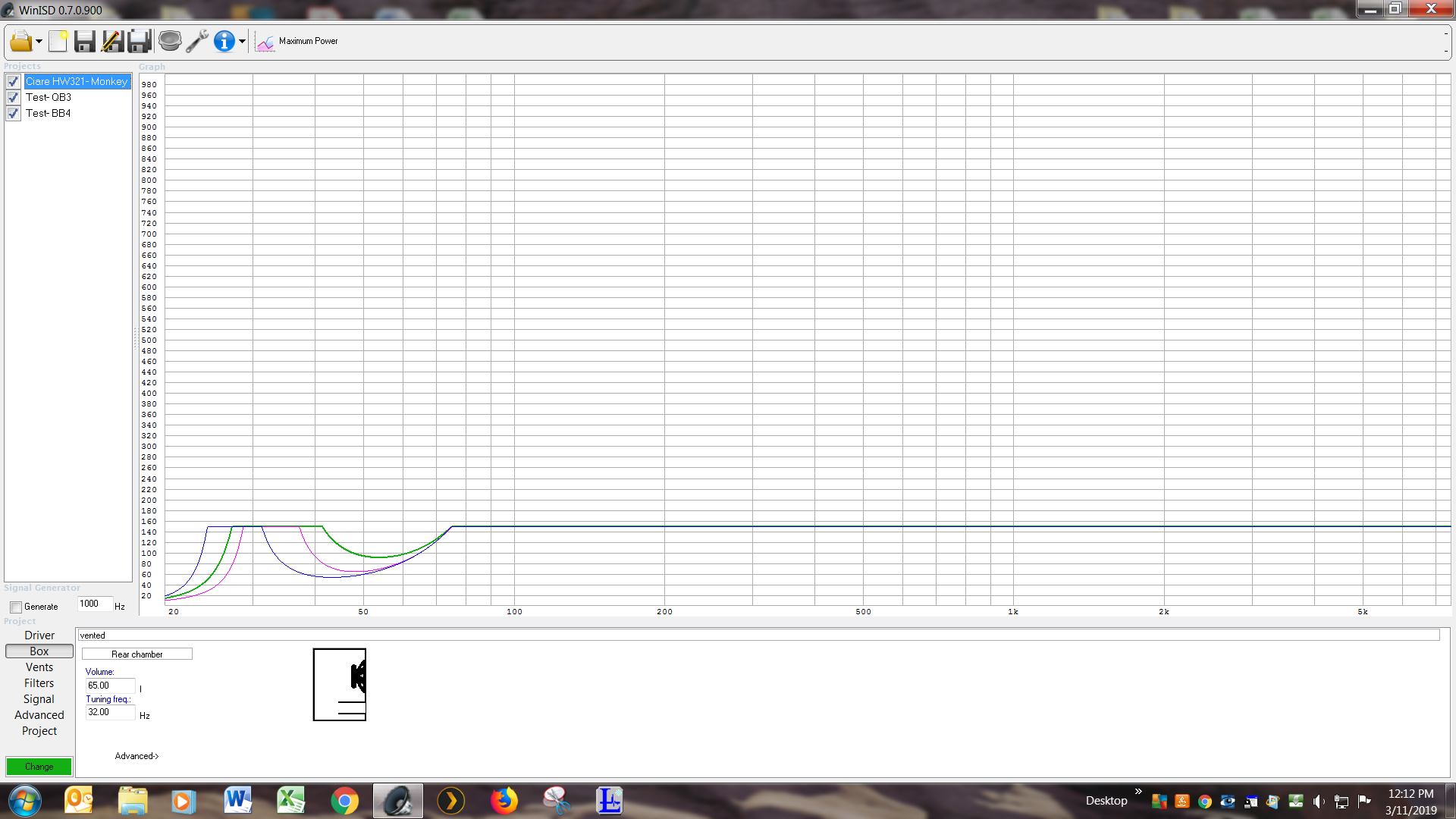

have you a simulation for max output for the alinement's presented?
Thanks WaVeInFoRm,

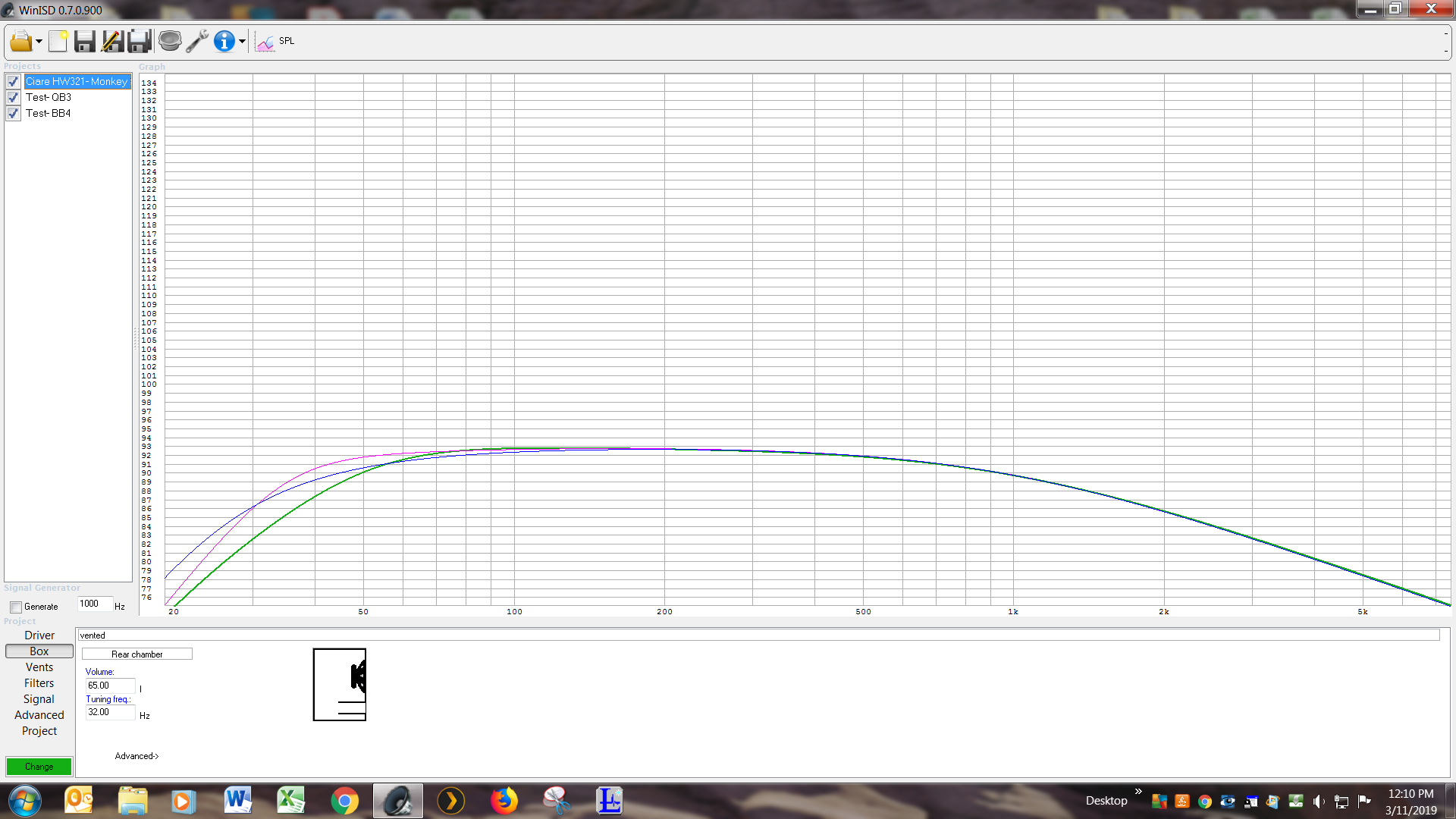

I appreciate your response. Attached is a couple more sims to compare. The first screenshot is max spl. The 2nd. is spl comparison @ 100w. In my opinion, it appears my 65 liter cab would work well with this driver.🙂 Unless, I have overlooked something.
Best Regards,
Rich
