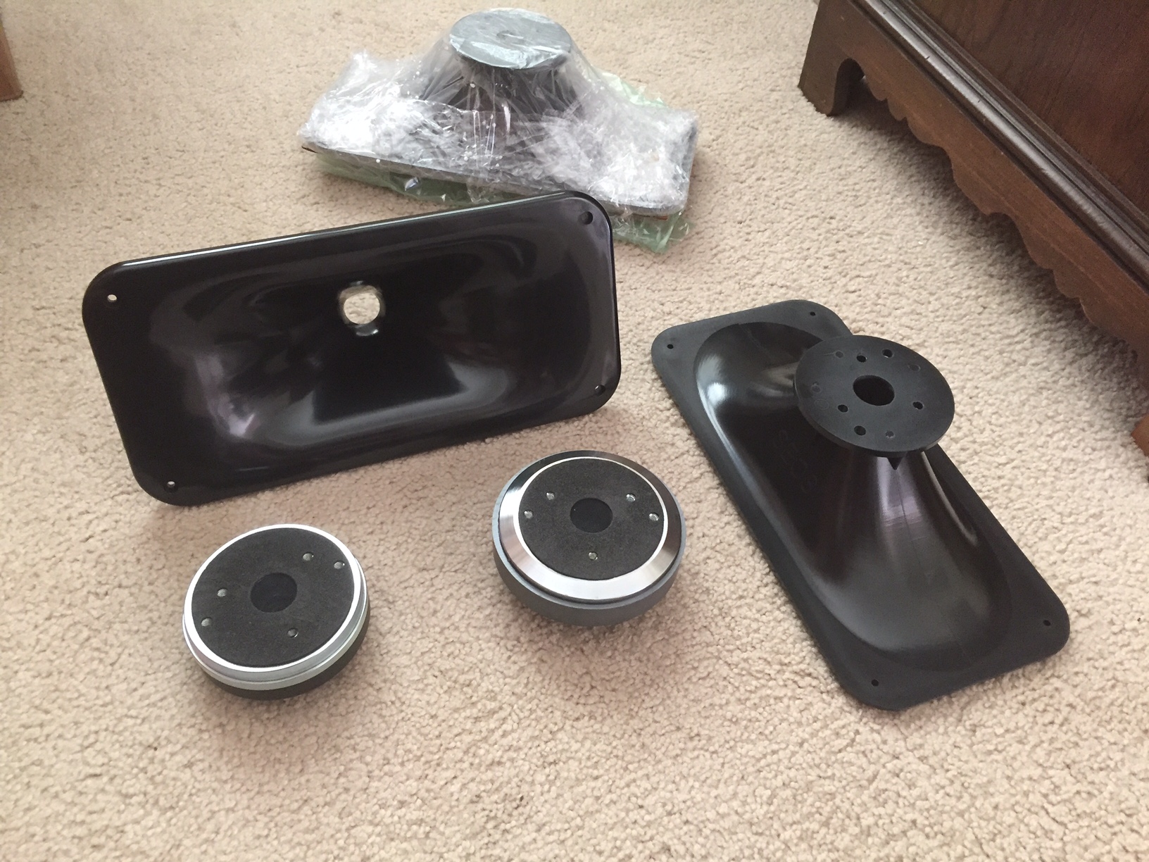

FWIW, I've got a pair of B&C DE250's and DE500's arriving soon for the waveguides. I know that compression driver sensitivity on the high end drops quite a bit on a CD waveguide. If the 97 db figure for the PLB is accurate, would that potentially be too high to mate with either of these compression drivers once they are eq'd back to flat response? I'm interested to try out foam plugs ala Geddes in the waveguides as well so it seems I might lose a db or two of sensitivity from the compression drivers for that.

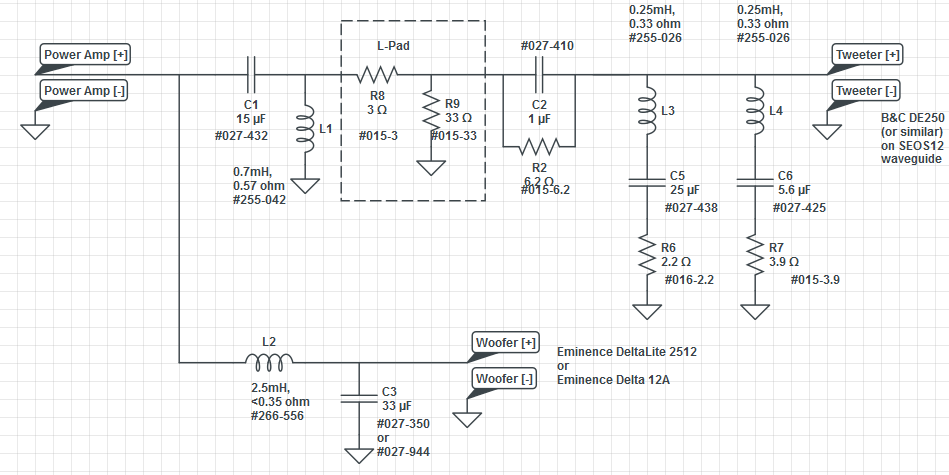

Unless you love the challenge of designing effective crossovers, I think you'd be far far ahead if you simply bought ( from DIYSG ) a proven design such as the HT-12 .
It uses ( for the woofer ) an Eminence DeltaLite II 2512 ( 12" ) to great effect .

Back to the Emmi 2512, ( also some years back ) Bill Waslo worked up this network using the 2512 & the horn/driver combo ( which you currently have on hand ) .
- I'm pretty sure this rare schematic disappeared when the DIYSG forum migrated to it's present form .
- Here's the necessary network schematic ;

Thanks for the input Earl. I came across SEOS designs with the 2512 in other threads here or at AVS forum. I hadn't really considered Altecs up to now, I'll look into those in more depth.
Designing a crossover won't be an issue for me. I will start out active using Frequency Allocator, and then build a passive XO at some point if I like the results well enough. Certainly I'll consider Bill's designs as starting or end points if I end up using one of the same woofers.

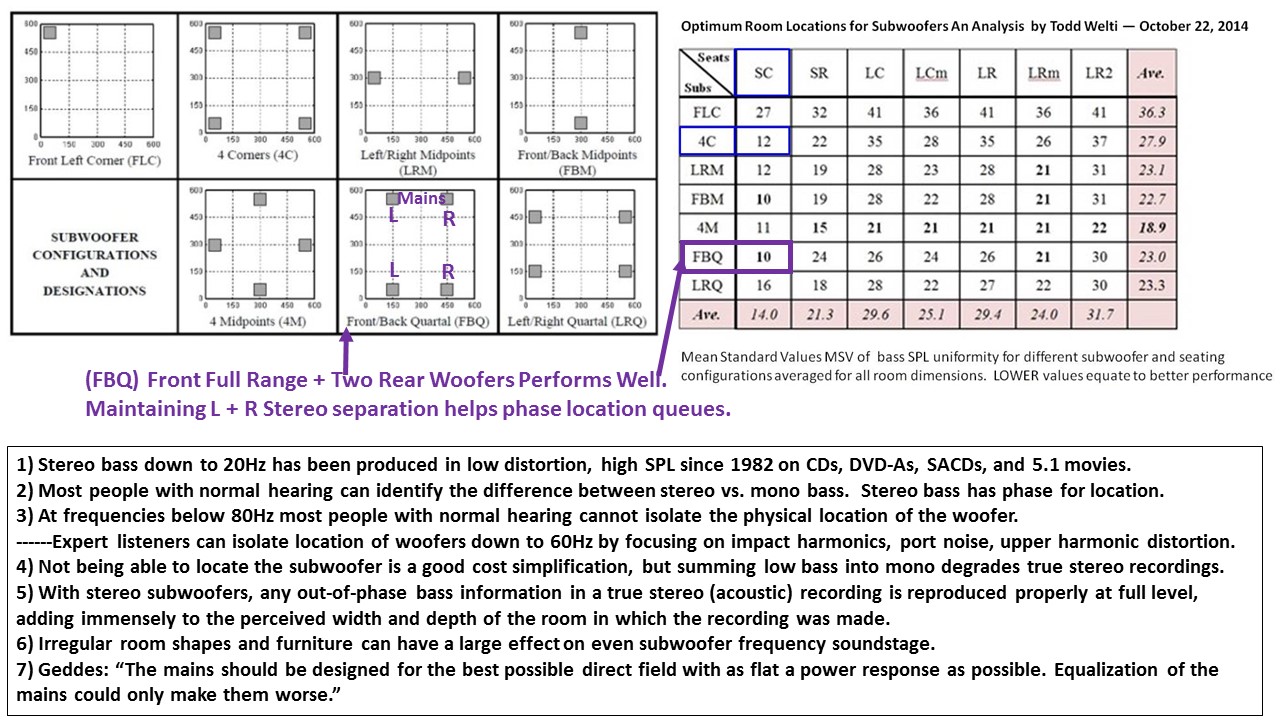

Have you compared maintaining stereo woofers in your room, like a front/back quartal configuration, versus summed mono woofers?
1) Stereo bass down to 20Hz has been produced in low distortion, high SPL since 1982 on CDs, DVD-As, SACDs, and 5.1 movies.
2) Most people with normal hearing can identify the difference between stereo vs. mono bass. Stereo bass has phase for location.
3) At frequencies below 80Hz most people with normal hearing cannot isolate the physical location of the woofer.
------Expert listeners can isolate location of woofers down to 60Hz by focusing on impact harmonics, port noise, upper harmonic distortion.
4) Not being able to locate the subwoofer is a good cost simplification, but summing low bass into mono degrades true stereo recordings.
5) With stereo subwoofers, any out-of-phase bass information in a true stereo (acoustic) recording is reproduced properly at full level, adding immensely to the perceived width and depth of the room in which the recording was made.
6) Irregular room shapes and furniture can have a large effect on even subwoofer frequency soundstage.
7) Geddes: “The mains should be designed for the best possible direct field with as flat a power response as possible. Equalization of the mains could only make them worse.”

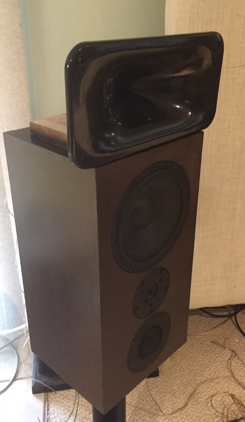

First listening tests with the DE250/SEOS12 sitting atop some other speakers I had on hand with a Silverflute 8" woofer were quite a success. Crossing over at 1000 Hz LR4 sounded very good, exceptional really considering how crude the setup was. They were run without a baffle, I imagine there's quite a bit of mouth diffraction that could be eliminated when the SEOS is mounted on a baffle with roundovers of an appropriate radius. Despite this quick and dirty setup, the speakers imaged very well and disappeared effectively. It was very easy to dial in a pleasing tonal balance. The DE250's seem very malleable. The quality of the treble was actually not too different from the Scan Speak 9500 domes I've been used to but with much more dynamics. That was really a pleasant surprise. With the 9500's, they will play loud but they reach a point were I want to turn the volume down since they sound a bit less pleasant. None of that was necessary with the DE250's. I haven't tried out the DE500's yet, hopefully in the next couple of days.

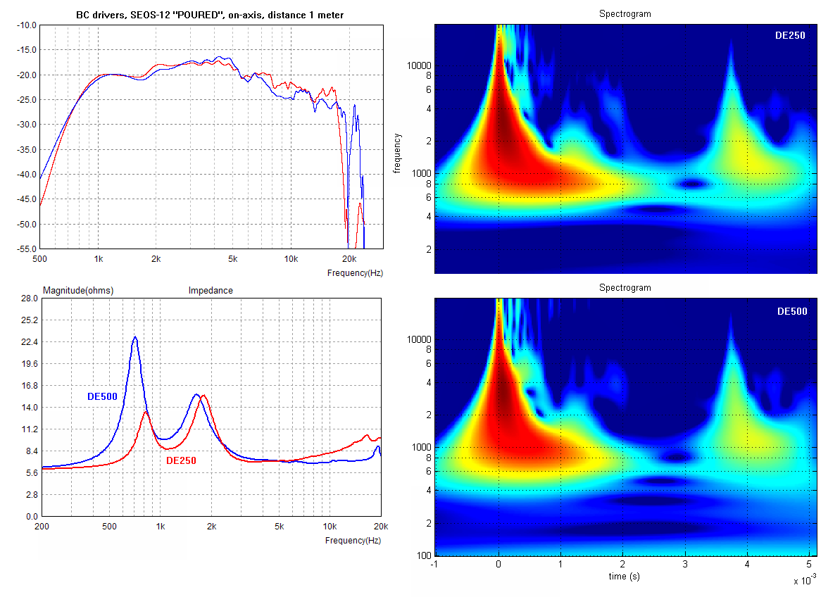

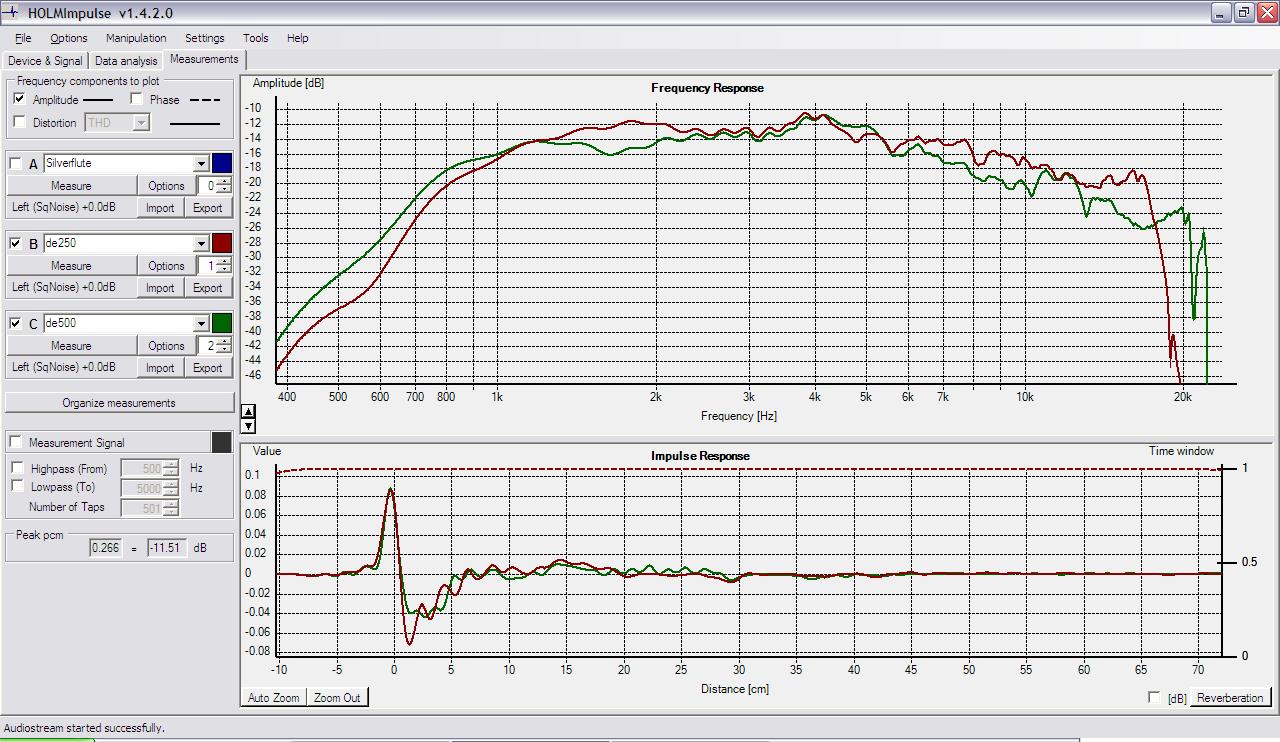

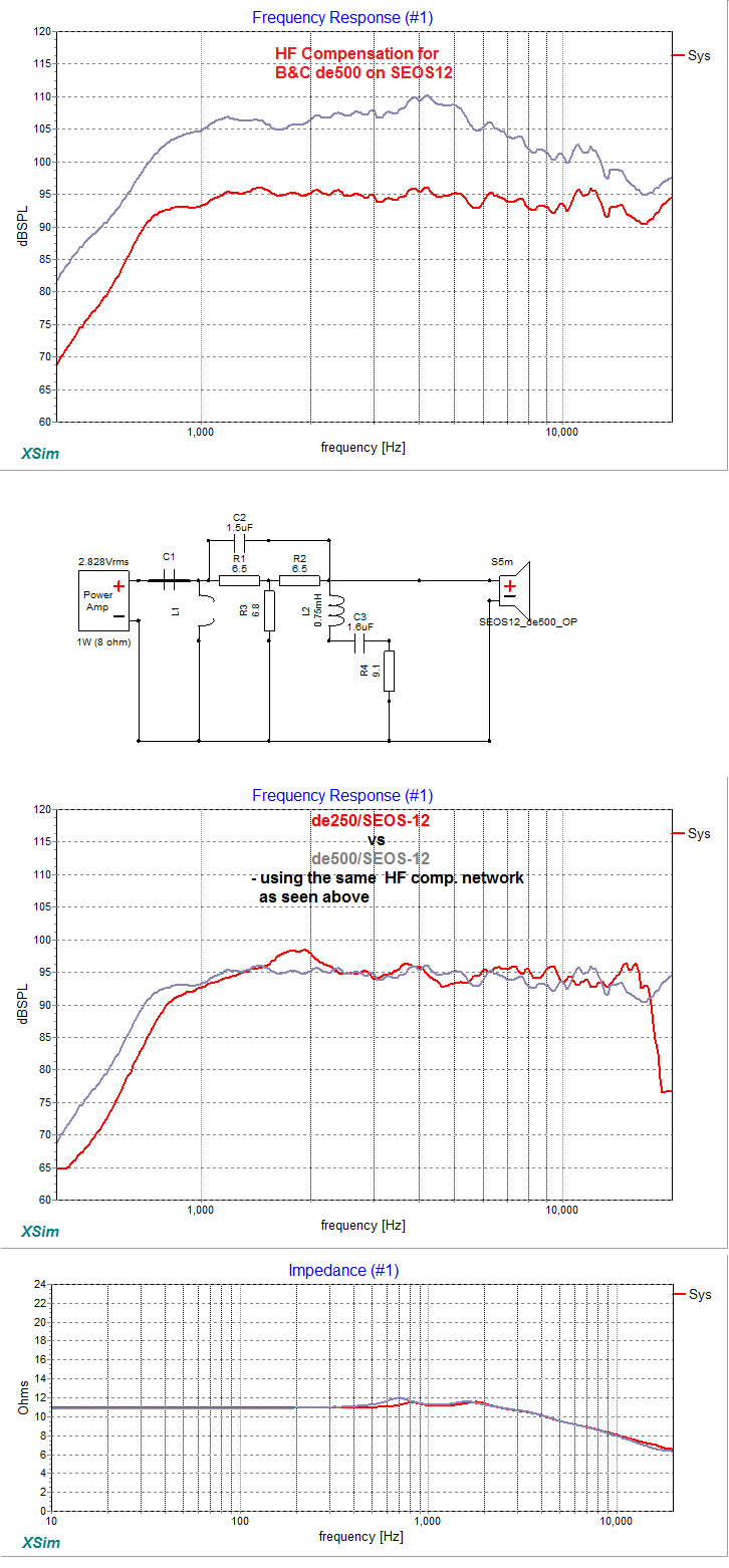

I was able to run some quick response tests on the DE500 last night. Plots are about 5-10 degrees off axis at about 1.5 m. They looks fairly similar to the data EarlK posted (from Autotech?) earlier in this thread.
Dan
Dan
Make that "response tests to compare the DE500 and DE250" if it's not obvious in the image. Green is DE500, red is DE250.
Dan
Dan
Hi Dan,
Thanks for the new graphs ( they're pretty interesting in their general agreement with other peoples measurements, including those Autotech graphs that I posted previously ).
A few thoughts ( no specific order of importance );
(i) To give the de500 the best audition ( or chance in a comparison to the de250 ), consider implementing some version of a 30 PPI Geddes filter // before deciding on the driver's sonics merits for your use .
(ii) Are you able to create .ZMA impedance files of your drivers for network design purposes ?
(iii) Do you have some proficiency in working with XSim ?
(iv) Passive filters do have a subtle difference in sound when compared to active ( generally, they are less dynamic due to resistive losses ) > though this attribute benefits the speaker designer when he/she is wanting to match-up components that have such large disparate sensitivities .
IOW, I believe it'll be to your benefit if you wire up some horn padding networks ( that also include some basic HF compensation ) .
- You can still do everything else electronically ( for now ) when it comes to creating HP's & LP's ( as well as any needed notch-filters ) .
(v) I've already created passive filters for these drivers using for your response pics ( as well as AutoTechs pics ) .
- I'll post them here at some point.

Hi Dan,
Here's an HF Comp. network for you ( if you want to try one ) ;
> CLICK the PIC ( it's quite oversized )!!
The LCR notch filter isn't mandatory ( though it'll help for comparative purposes I believe ) .
BTW, the FRD files are traces of your own FR captures, while the ZMA files were created from the AutoTech pic .
