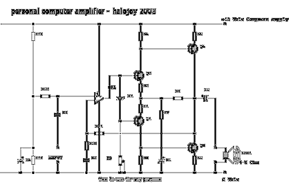

here is my principal schematic
for everybody to learn from 😉
halo - too lazy to calculate component values ....

from HaloAudio - power amp section:
pc-amplifier
A model for a circuit to give a good output from 12 Volts power supply.
An OP-amp controls power transistors. Common collector output for max power.
To be biased for full Class A operation. Voltage drop over R5 and R6
should be max 0.2-0.3 Volt at idle current.
Suitable as hifi power amplifier in Computers and Cars.
Your diy-audio-friend can help you to calculate component values.
Should be adjusted to fit your loudspeakers - 2/4/8 Ohms. [/b]

I attach my circuit again.
need some more feedback
I have a question:
What audio OP-amp should work the best with 12V single supply?
Maybe TL071? It uses JFET input, so a bit higher noise.
But cars are a bit noisy too. So that will be alright, I think.

TL071!!!!!!!??????
Yuk. You guys in Sweden don't get out much do you?
I would concentrate on ones that can swing as close to the rails as possible, and then worry about noise, or how it sounds.
Or you could design an output stage that is common-collector, maybe even with gain.
Jocko
Halojoy Web Portal with Chess-Audio Links
pc-amplifier
This project will be present in more detail later
