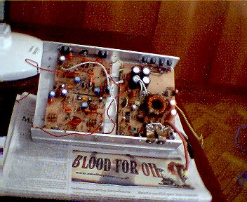

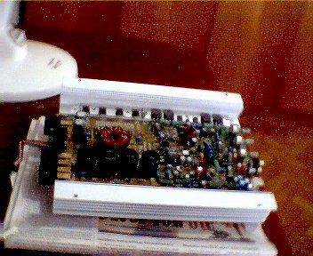

I tried to take some shots of my prototypes and I got these pics below. I have just one cheap webcam, so the images are very bad quality.
One is of a pre commercial prototype of a 200w x 2 at 2ohms amp using the SG3525 IC. The other three are of an hand made heatsink and pcb for a 75w x 2 at 2 ohms pwr amp. A very simple (and bad) power amp, just to test the smps.
Regards
