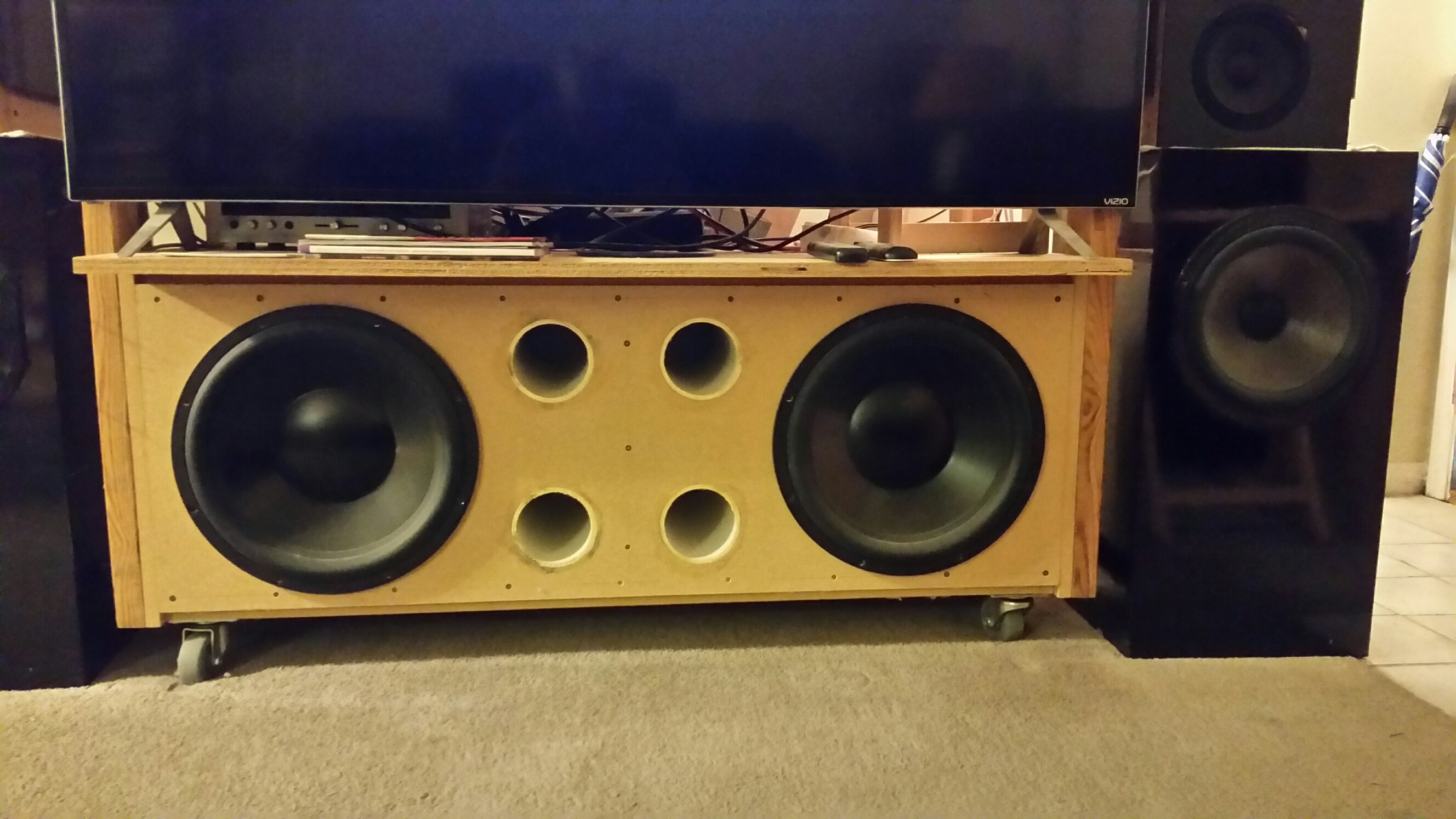

Hi, I'm using the 12LX60V2 in a tapped horn which helps overcome the limited Xmax and LF extention. I bought the enclosure already constructed and the Beyma was a recommended driver. I'm very happy with the performance!
