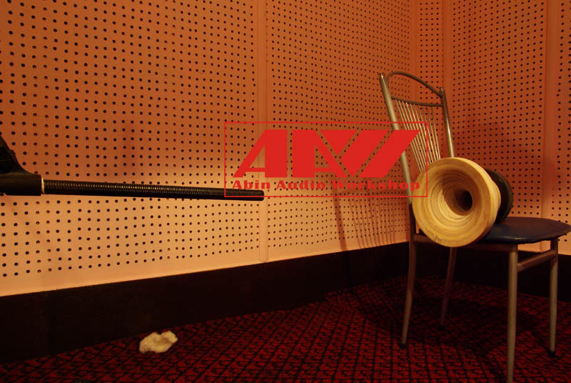

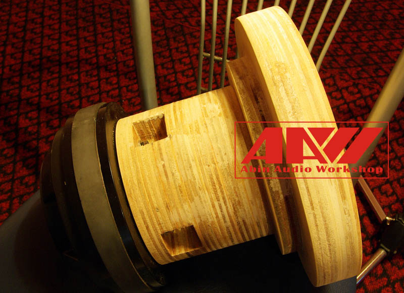

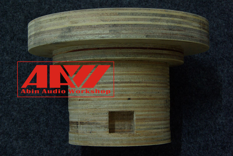

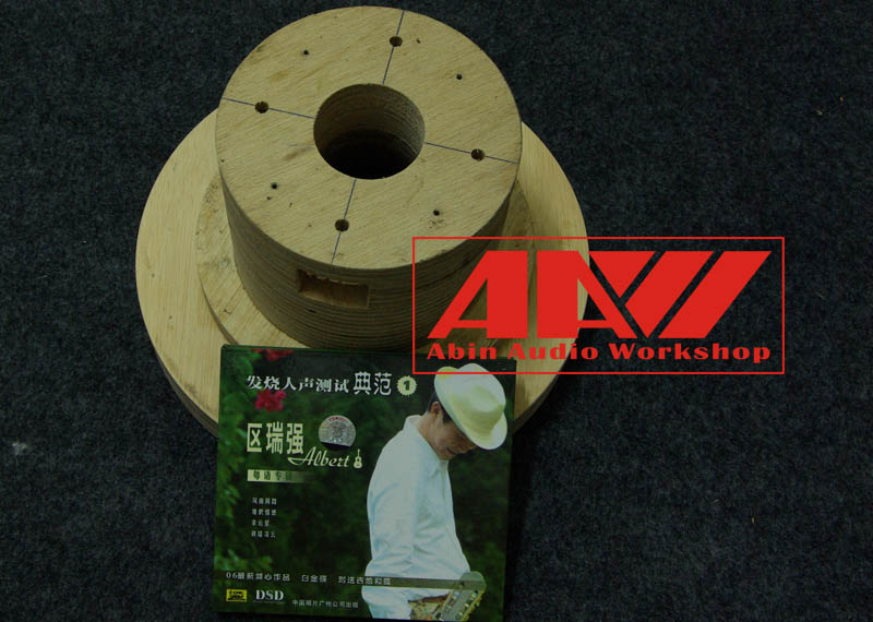

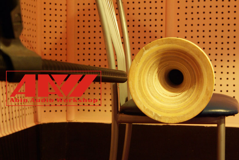

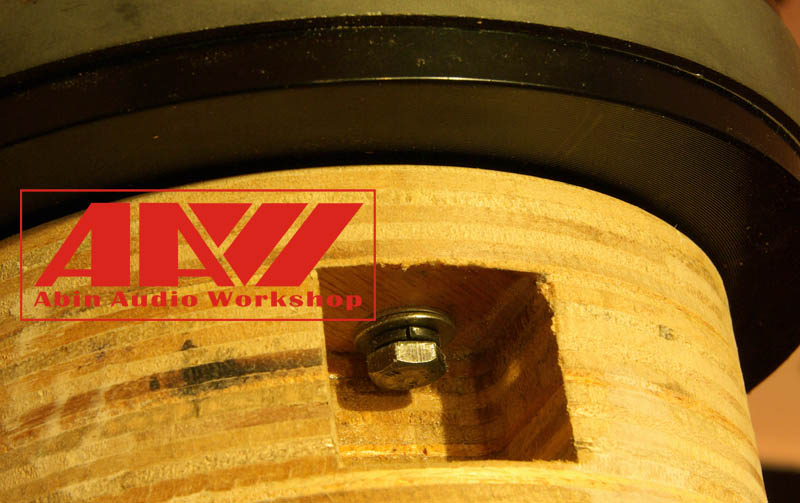

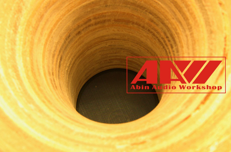

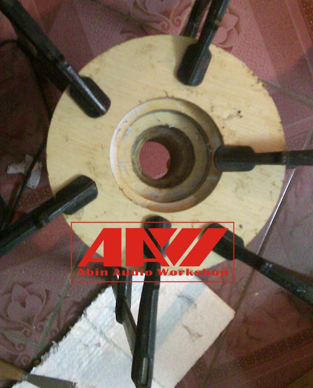

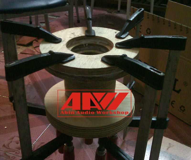

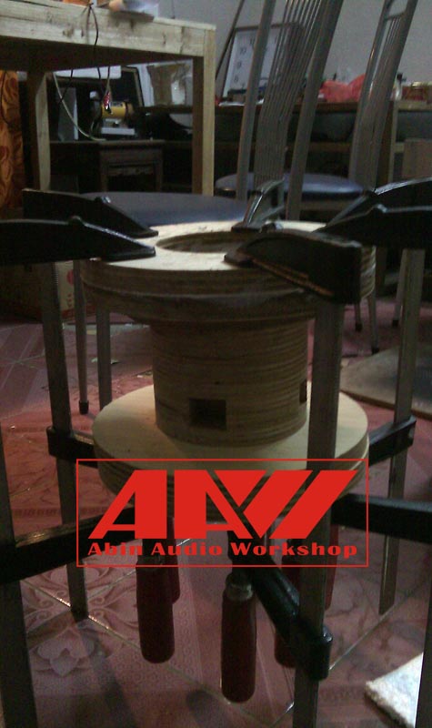

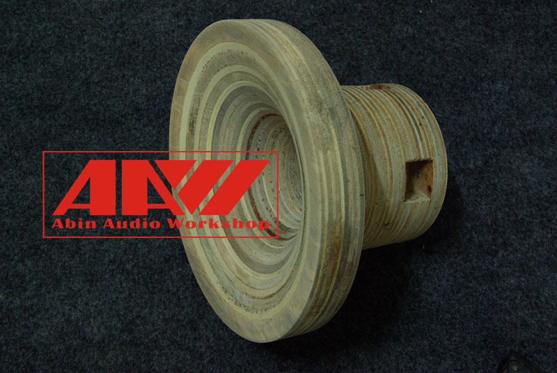

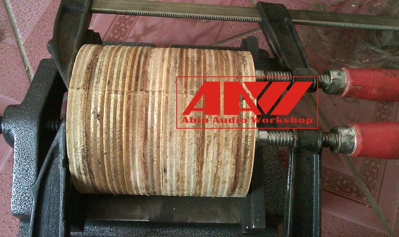

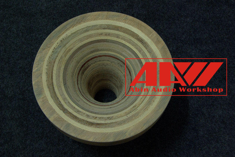

English bad, pictures speak
Nice, I guess you used a lathe to turn those, right? What compression driver do you use with that horn?
Indeed, nice work. Your english conveys all it needs to "Pictures speak" is the single greatest pair of words I've ever seen on this forum.
Yes, lathe. Compressed drive is customized.

Using wood, especially the right kind for tone etc, makes a lot of sense to me over using metal or plastics ... Good effort 😎

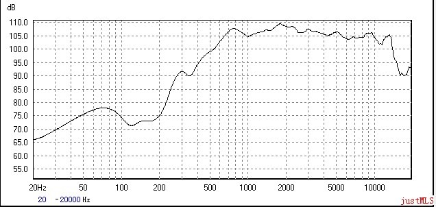

any off axis measurements?
Could you also explain the custom Driver comment? What Compression driver would be comparable if we are to try and buy one?

Frequency response graph is in the studio test,For reference only.
(由于没有专业消音室测试,只能在录音棚隔音室测试的,频响图只供参考)
Drive is customized,For the production of the Loudspeakers and custom.
(驱动头是定制品,木号角也是由本驱动头而开发的)
Sorry, English is really poor.
(对不起,英文很差,复得不好!别见怪!)
Yes, the wood will make the sound better than other materials.
If there were links, they didn't work.Frequency response graph is in the studio test,For reference only.

I can not read Chinese, so that does not help.
Sorry, I tried to share it with you in English!
The problem seems to be that the links are written in chinese, which our american browsers don't recognize. You may be seeing images or links where we're only seeing characters.
"I can not read Chinese, so that does not help. "
Well google can, and he did try to translate it to english.
From what I can understand the driver is in development and is the first prototype available. It was made for the horn and this specific speaker.
The measurement was not done in an anechoic chamber so it is for reference only.
I might very well have gotten it wrong though.

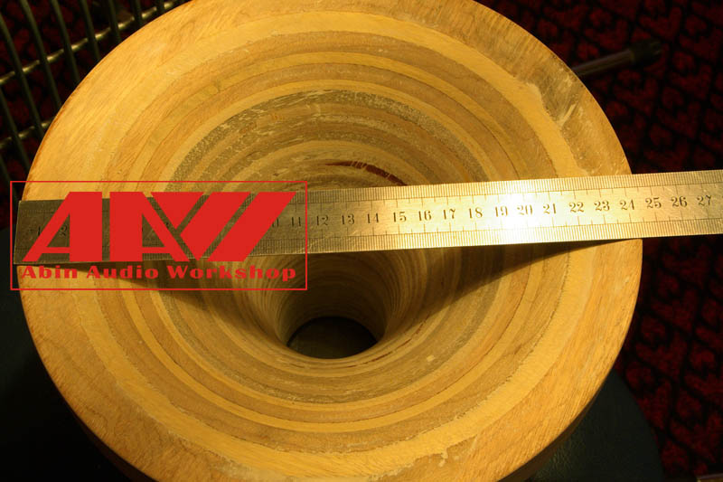

I wonder what the true shape if his horn is.
How accurate can we really cut the waveguide with a lathe?
Im always interested in creating a different horn for a new build.
