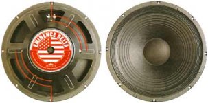

Finally decided to sell my huge and extremely heavy 15 inch bass bins and huge tops due to always having to hire a van for discos,and the 'last straw' injuring my groin due to lifted extremely heavy 50 kg bass bins down a flight of stairs.🙁
Well as I only play dnb and reggae in small venues with a crowd of 100 people max i might as well make some lightweight bass bins and midtops!
I'm thinking a 12 inch Eminence Delta 12LF or Eminence Lab12 in compact bandpass cabinet for bass in a seperate cab.
And a Eminence Gamma or Beta 10 or 8 and a Eminence APT80 for mid/high.With a pole btw the two.
Anyone going to help find some plans for such compact cabs,because all i've found was plans of 'monster' size cabs which i don't want!

The drivers you pointed out won't have very much extension, or in the case of the Lab12, not very much efficiency. Instead, I would say to use two of this woofer per side: Eminence Omega-Pro 12A. It's $170 each, or $160 each for 4+, and will handle plenty of power (700w RMS apiece, 1400w for each dual-12 bass bin) while getting you down to 40 Hz (respectable), and with 4.8mm of Xmax, which you want. If you've got power, these will be able to put out what you want from them. It can be found at Parts Express.
Eminence Omega Pro 12A 12" Cast Frame Driver
You've got to admit, that's a massive magnet and frame. These things will last a long time, and offer positively punishing output for their size. Make sure you build these into a bass-reflex box. They won't really like a bandpass. They should be easier to move as well.
As far as tops go, I would look into the Eminence Beta-10CX driver. You could mount the APT-50 super tweeter in the back and then have time-aligned output with wide, smooth dispersion. You will need the APT3 adaptor and the pxb2-3k5 two-way crossover for this. All that stuff is at parts express, too.
If you want to make these look good, do expanded-metal grilles. There are places on the web that sell expanded metal. A quick search with Google should turn up what you are looking for. You can paint it with a paintbrush or leave it in its natural color. Use an active crossover between the bass bins and tops.

BAM said:Eminence Omega-Pro 12A. , will handle plenty of power (700w RMS apiece, 1400w for each dual-12 bass bin) while getting you down to 40 Hz (respectable), and with 4.8mm of Xmax, which you want. If you've got power, these will be able to put out what you want from them.
But at 40Hz that Xmax will be reached at 50W...... bit of a waste of power capacity IMO.
Would recommend Beyma 12LX60 - full 700W capacity at 50Hz down to 300W at Xmax at 40Hz.
Cheers
Don't PA drivers spend a little more time outside their linear range than hi-fi drivers on account of huge mechanical Xmax but low electrical Xmax? We may run into trouble on this forum because in the hi-fi world, running a driver outside its linear range is extremely taboo. For PA applications, especially subbass, it can be tolerated to a much greater extent. This is all going to depend on whether people here on this (Hi-Fi) forum can think outside the box and understand we're not trying to design the bass section for the successor to the Wilson Audio X-1 but something whose sole design consideration is getting the MOST out of a 12" driver while keeping costs, enclosure size, and required amplifier power reasonable. This is designed for high output at low frequencies, not extreme super-fidelity at low frequencies.
The Xmech (excursion limit) is 20.8mm. Also, you might consider putting a steep highpass/low-cut on these at 45 or 50Hz to make sure you get a lot of output without pushing things too much. 50Hz seems high, but the Peavey SP 118X (single 18", vented) only goes down to 50Hz.

I doubt 12" PA drivers will really have sufficient extension. Seems to me that 15" drivers are more up to the task. Perhaps you should consider carefully the actual construction and the way in which they are to be moved.
- more bracing allows you to make them thinner and lighter
- PVC pipes are lighter than MDF shelf vents
The other approach is to use HT style subwoofer drivers like the Lab12 which have more output in the right box for their size given their large displacement. They need either a bandpass or a horn. I suspect a horn may mean the box is too large and heavy, but perhaps a scaled down version of the labhorn with one driver and designed for an F3 of 40 - 50 Hz.

BAM said:Don't PA drivers spend a little more time outside their linear range than hi-fi drivers .......... For PA applications, especially subbass, it can be tolerated to a much greater extent.
Just because there are many PA sub cabinets in use that DO exceed Xmax substantially, doesn't mean that all PA users can or should tolerate this. PA and hi-fi should both be striving to reproduce audio accurately - PA SHOULD be hi-fi designed for a larger audience. As the overtones generated from exceeding Xmax in a sub are louder to the ear than the fundamental, then every effort should be directed towards ensuring this does not occur.
paulspencer said:I doubt 12" PA drivers will really have sufficient extension. Seems to me that 15" drivers are more up to the task.
Very good results can be obtained with 12" speakers - it all comes down to coupling with the air. Even a single driver version of the Labhorn is still quite large (working on something along these lines myself). Probably the best compromise between size and efficiency would be a double tuned chamber bandpass box (6th order), especially if the desired bandwidth is fairly narrow.

I think i'll go with ported bass reflex instead of bandpass.Just hope the plans of the 12 inch box originally designed by Celestion to use their specific driver,which doesn't that model exsist anymore,work with my driver?
So how would I know if the Eminence Delta 12LF is suitable for a 50 Litre enclosure? with 1 port 62mm length?
As these specs of the cabinet are meant to be used with the Celestion S12 150CE which ain't made anymore!
So hope Eminence Delta 12LF is suitable for a 50 litre cabinet with [1] 62mm port?
Otherwise can someone find me a suitable pa bass driver if that ain't gonna work?

As the shop is not having them Eminence drivers in shop anymore[useless Maplin] I bought some ready made pa cabs 2nd hand with simular drivers in!
The bass bins are made of 18 mm MDF and have 1x Eminence Delta 12 LF 300w rms[old version] with rubber surround.With [2] 4 inch diametre ports about 10 cm long.
No wadding whatsoever in the cabs.Very good large air core inductor but with lousy electrloytic capacitors.
The mid/tops are made of 18mm chipboard[grrr] and have 1x Eminence Gamma 10 200w rms[old version] and 1x Eminence APT150 Phenolic diapharm compression driver.
No wadding in these either,but the crossover is decent with a combination of polyproplene 600v caps and polyester caps and air core inductors.Except both the 20w resistors appear to look burnt unless thats cigarette tar,as they smell of cigarrette smoke?
They all 4 appear to work fine!
