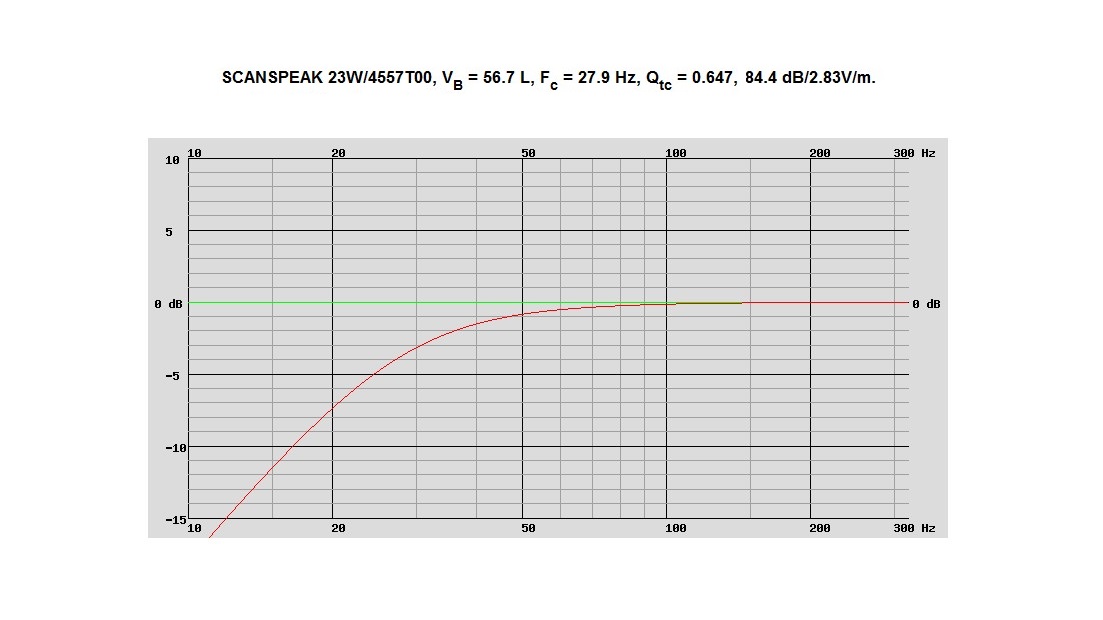

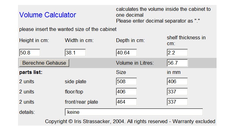

What power amp do you have?
A sealed enclosure for one driver (each)?!😀
56.7L= 2.00ft³
Drivers advisable:
(With correction or not. Of course if freq. is of importance you can always use a LT.)
9" Scanspeak 23W/4557T00 Sub
and about 40/50W RMS (12.01 V) for @Xmax.
Scan-Speak
Scanspeak 23W/4557T00 SubWoofer - Revelator Range
https://www.madisoundspeakerstore.c...557t-02-9-aluminum-cone-subwoofer-black-cone/
12" Dayton Audio RSS315HFA-8 Reference
power amp for 260W/41.03 V @Xmax.
Dayton Audio RSS315HFA-8 12" Reference HF Subwoofer 8 Ohm daytonaudio
Dayton Audio RSS315HFA-8 12" Reference HF Subwoofer 8 Ohm parts-express

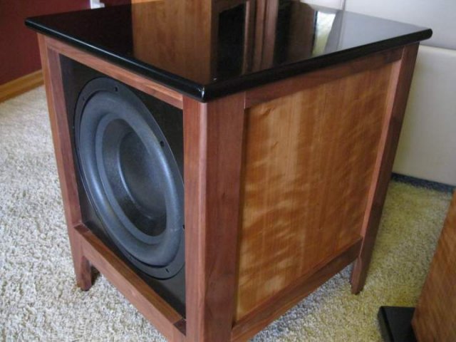

PrepsDK,
I haven't listened to a Velodyne Optimum, but I trust it is very nice! A worthy candidate could well be 12" GR/Rythmic servo sub...here are several pics of one that I built. Fast and musical and I also use it 50/50 for HT and music. It doesn't shake the rafters in the home next door but it does shake the rafters in my home. 🙂
With the legs, the Dims are a bit larger than your requirements...
16.5" wide
22" Height
18" deep
If you build without legs, the dimensions meet your requirements.
