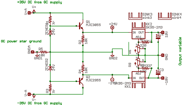

There was no space for another transformer to power the lower voltage preamp, and the relay to power to amp on after delay.so I decided to try a circuit I saw about a year ago.
Rod Elliot's simple pre-regulator. He suggested it would work for dropping up to +and-70V rails to 24V after which he implemented fixed voltage regulators.
I chose to use LM317 and LM337 to give me variable supplies (not to mention the datasheet shows an extra 10db ripple rejection). In theory the supply thus have rails that are variable through a wider range than indicated above, but I like to stay within max of 10V diffirential i.e. up to 24 minus 10V. This means in theory we should never get close to the current limit for these 2 regs, with about a 5A ceiling between the 2 of them)
As far as I understand the prereg part will supply about 100mA with those transistors (biased at 20mA) per rail, which is more than enough for an opamp based buffer, and I hope for nuuk's buffer too. (work in progress short 1 transistor which I will only receive on Monday morning)
I have tested the build up pre-post reg assembly off my + and - 35V Gainclone supply, and it is the most steady output I have seen on my primitive testing equipment yet.

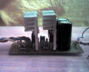

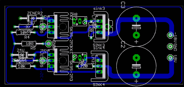

So I attach the neccecary schematics and board files in zip format along with some pictures....
The only thing I omitted on the files is the 10R resistor should be 1 to 2 W... the resistor is shown, just not the wattage...
Rod claims it should be cleaner than only using a regulator.

PS. the heatinks were way overkill - I'm cheap, I sawed them out af a heatsink from an ATX psu that died.

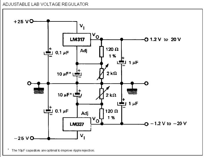

Could I ask, what wattage pots are you using? And what if I just use the schematic on the LM337 data sheet?

I threw the packets away allready... these were pretty small Bournes trimpots, 1/4W on the outside... regular ones would work just fine in that position This little board would work pretty neat for you. But hold on until monday when I can actualy listen to something powered by it...
You could use just the second part of the board with just the 2 regulators on of course or use the firts half with fixed regulators too of course...
The problem with only using LM317 etc, is that the larger the drop you achieve, the less current it can provide without overheating.

Anyway, this is the circuit I was going to use. The simpler the better for this job. 😉

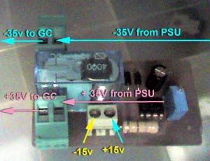

While it is quiet, you could use the relay board with a 12V supply by bypassing the big resistor where the power conects through... it is currently set to operate off 30V. I.e. from the positive and negative rails from the prereg-reg board. (which prevents loading one rail more than the other)
Alternatively you could use larger voltages or voltages in between, by adjusting the resistor.

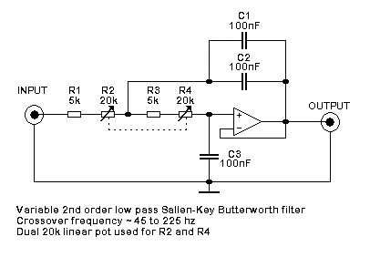

I'd be interested in the crossover/filter you did for the sub, I have a dead Yahamaha here which the woofer still works fine in, it is only a 100W.
This was submitted by some one months ago. It works just fine for what little testing I gave it. I just used two 10K resistors to sum the input which was taped from the input vol control of the mains amp.
I would imagine a couple of buffers for summing and a stage for a little gain would really improve the performance.
But for what it's worth, here it is.
