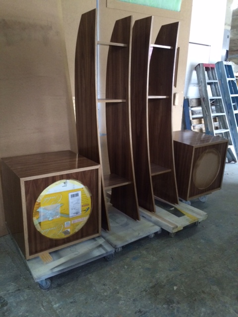

The overall height has been reduced to a mere 2.4m.
They are for a client, who I'm sure will chime in.

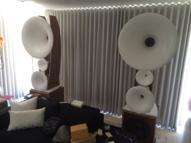

These are for a Fane 8M, with the midrange being handled by Vitavox S2.

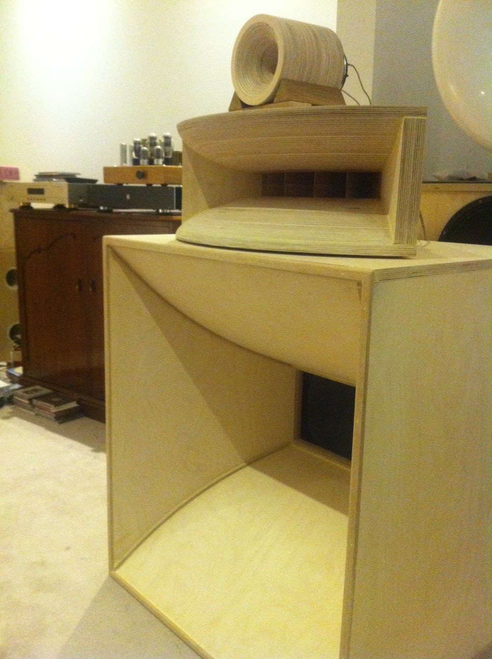

Maybe a word of warning/caution, I've worked with large stacks of birch ply and eventually suffered from cracks developing. Not on my glue seem but in between the ply laminate itself.
I have since covered my stack with glass fibre reinforced epoxy (and some other tricks) and haven't had any other problems. But it may be wise to be ready to cover them with something as the wood will continue to expand/contract, and with these sizes that can become a problem.
I've seen other examples of stacked enclosures with similar problems (cracks developing) on this site.

I have plywood and also MDF horns out there that are over 15 years old. None of them have cracked. You have to glue and screw every layer together. I use 12 screws per layer and rotate the next layer 15 degrees so I don't hit the head of the screw in the layer below it. The screws act as the clamp so you can build up the horn in a single setting. There was no need to use hand clamps and wait for each layer to dry. Each horn ended up with a 5 pound box of screws in it.
Thanks for adding that JLH, good to know a tested recipe exist. My stack was a bit bigger I guess at 2.25 meter. I had seen a B&W inspired mid enclosure build developing similar cracks, hence the warning.
http://www.diyaudio.com/forums/full-range/167744-fe168e-sigma-teardrop-enclosure-20.html
This size is much closer to a horn build.
So it does make sense to copy a working recipe to build a stable non cracking horn.
It's better to get the advise now than after the horn is finished in a way that might not work in the end. Especially if you're building it for someone else.
