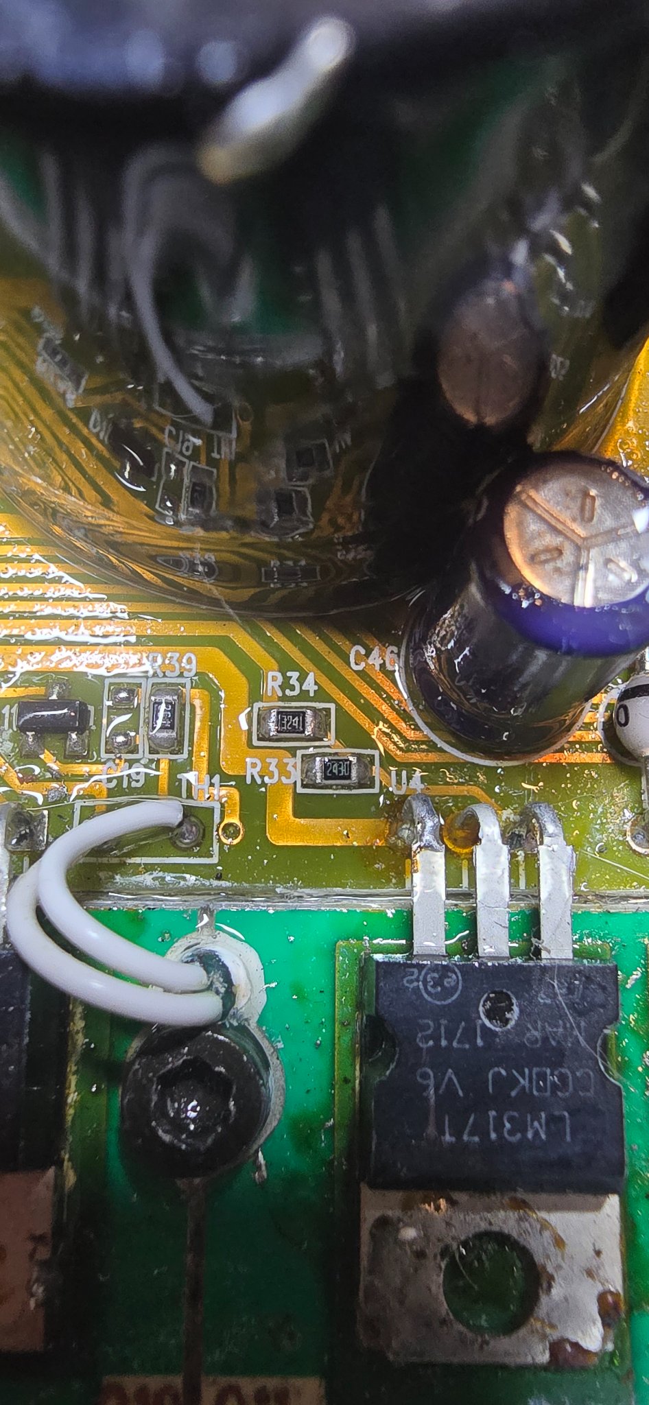

I am truly confused with this amp right now. Everything appears to be functional yet I have an lm317 where the lm337 is supposed to be. Isn't that the same as having a 7912 where a 7812 should be? How is this amp still working? According to the schematic u4 should be an lm337.
you are correct, but maybe its a mistake in the schematics?
To check it out, just measure the voltages at the opamps: TL 072 has negative voltage on pin 4 and positive voltage on pin 8.
If thats the case - dont worry 🙂
But here's the deal. I have an identical amp that's not working that has a lm337 there. Should I try and swap a lm317 in its place?
i would check opamp voltages on both amps to be sure because i dont know if they published another schematic revision or changed the layout...
if negative voltage is on pin 4 of the opamps and postive on pin 8 you dont have to change the regulators, its a quick test 🙂
-26 is not good, it should be around +- 15-19V
maybe regulator or adjustment resistors damaged/ out of tolerance?
Negative is Pin 4 ?
But seems ok, the LM 317 is the positive regulator and your positive voltage looks good as long as it is present on pin 8 of the opamps.
Negative is Pin 4 ?
Do you have an LM337 to replace it with?
If so, confirm that the resistors are within tolerance while the regulator is out of the circuit.
So i was able to round up a lm337. The voltages on the op amps are +/- 17vdc now. What's weird is aside from the voltage change, the amp runs the exact same. Even the temperature of everything is the exact same.
