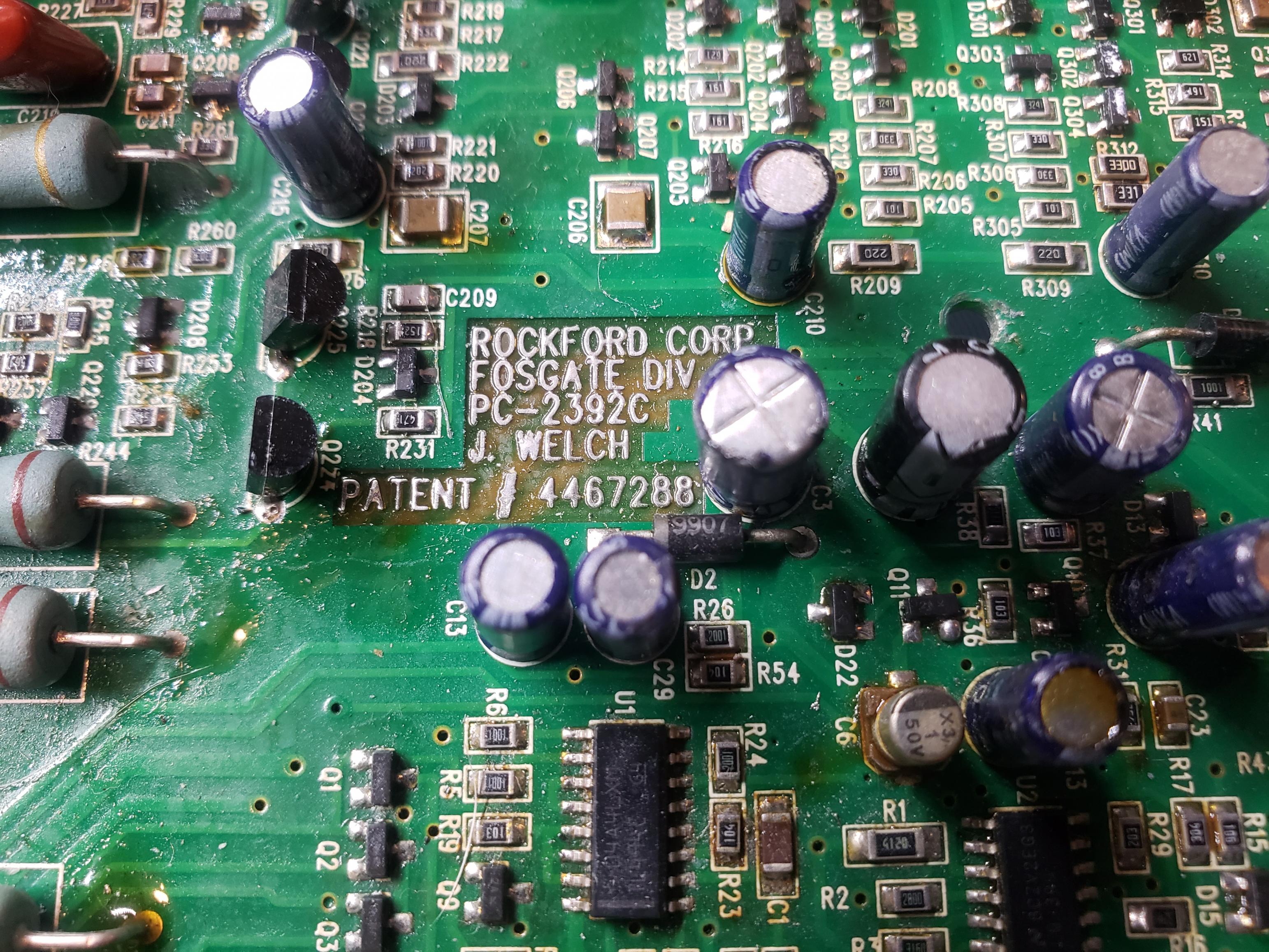

What does the different bank read with a normal multimeter in diode check and resistance?
Do you read a short between any legs of any individual transistor?

Why are you concerned about this? How is the amp malfunctioning that made you make this test?

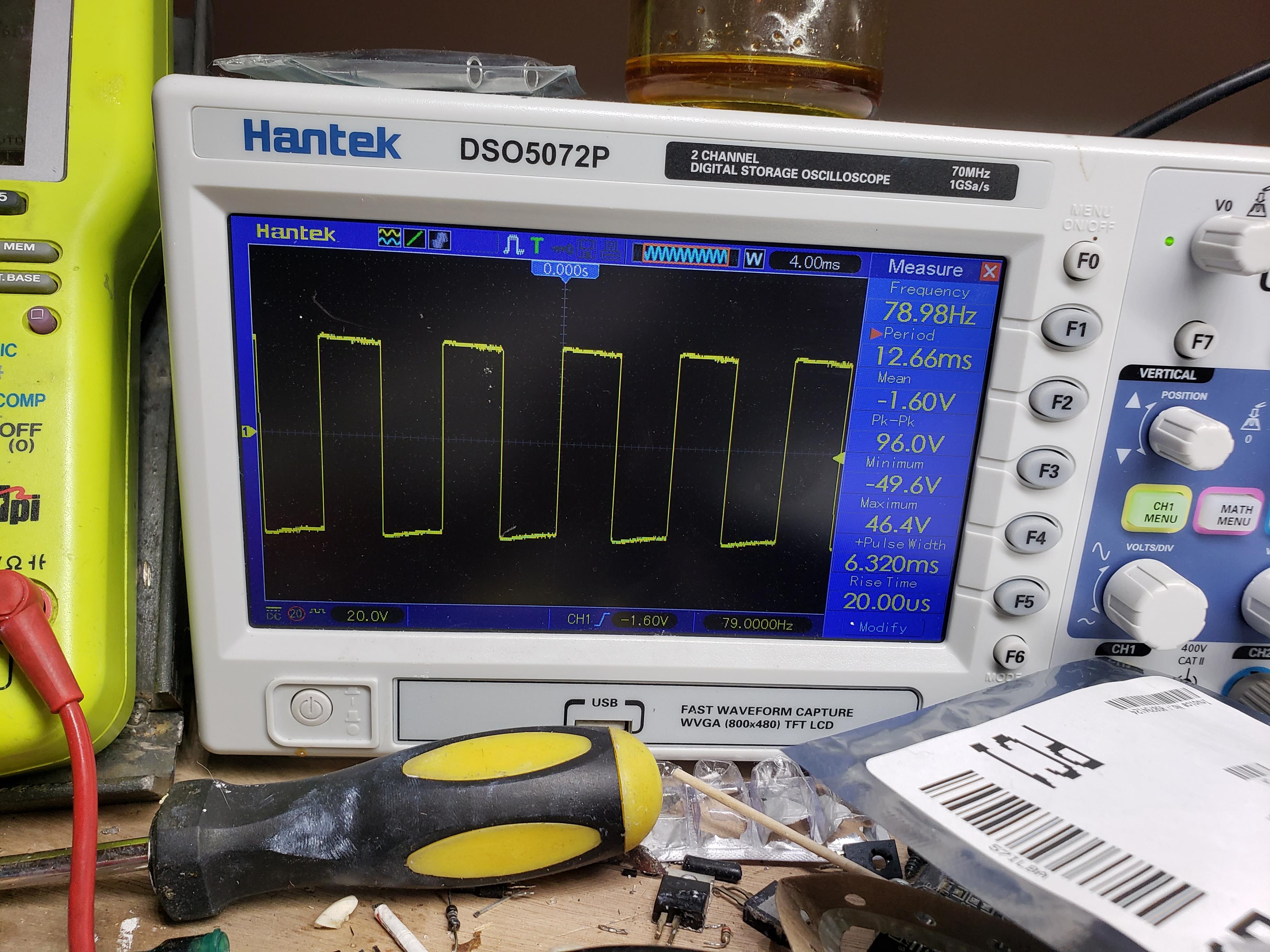

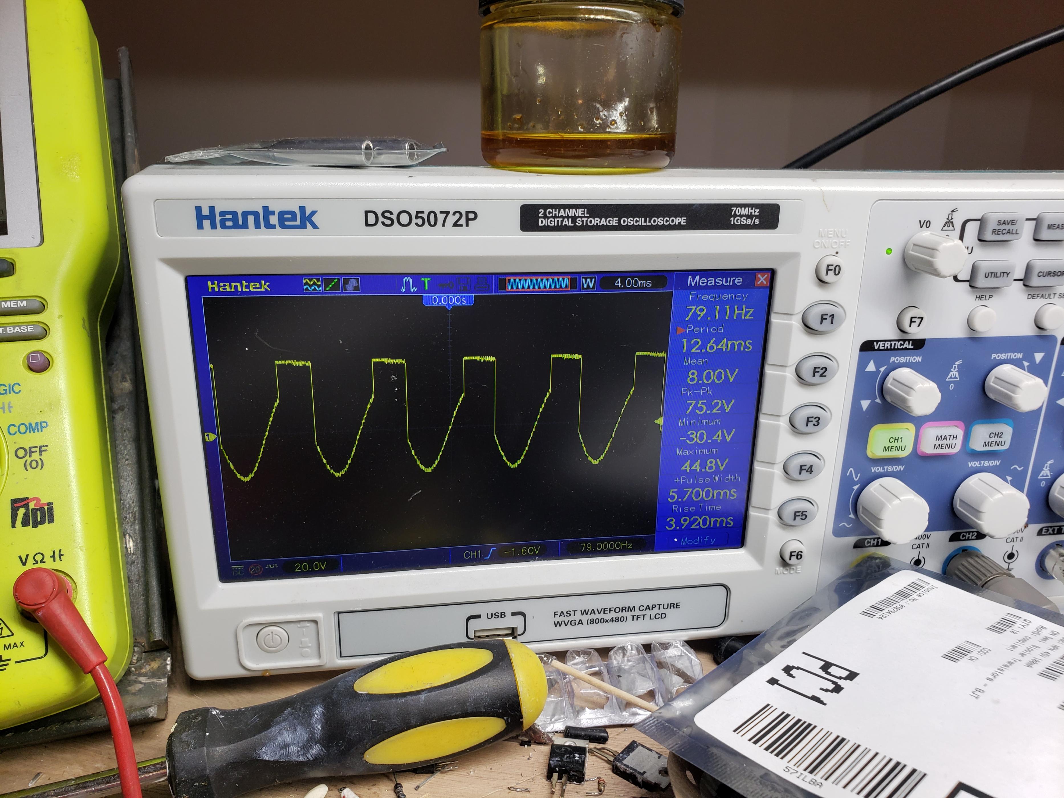

On one channel when I turn the gain up it starts distorting around 6vac with a strange looking wave . The other channel goes to 16vac then jumps to 96 vac and turns into a squarewave.
