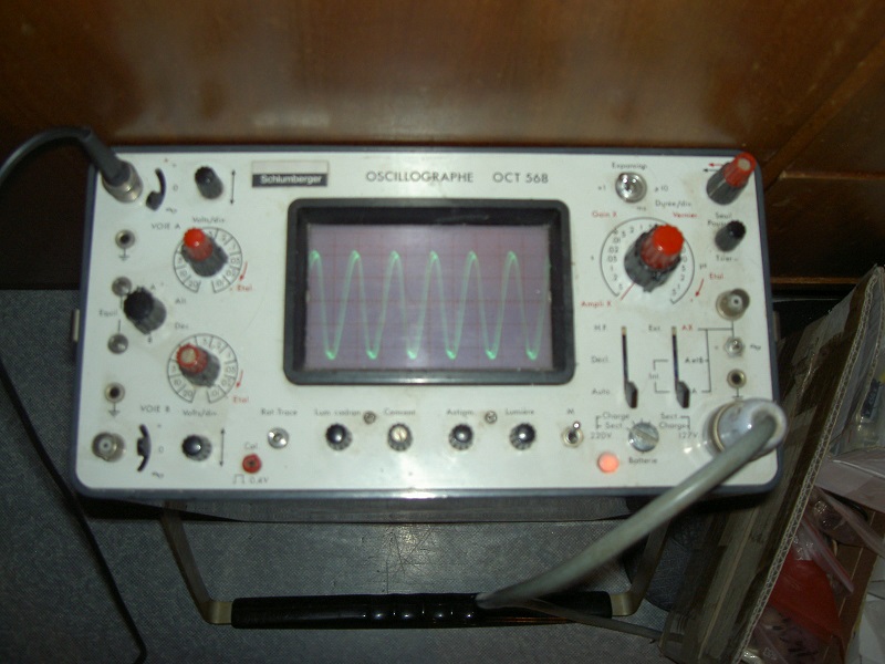

I have the same fuzzy schematic and because not all resistors had colour code rings, it was hard to really know which R had to go where. I only get 3W undistorted on my scope, then one half of the wave collapses. Who can help me out with a more detailed schematic please?

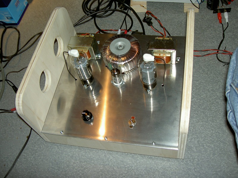

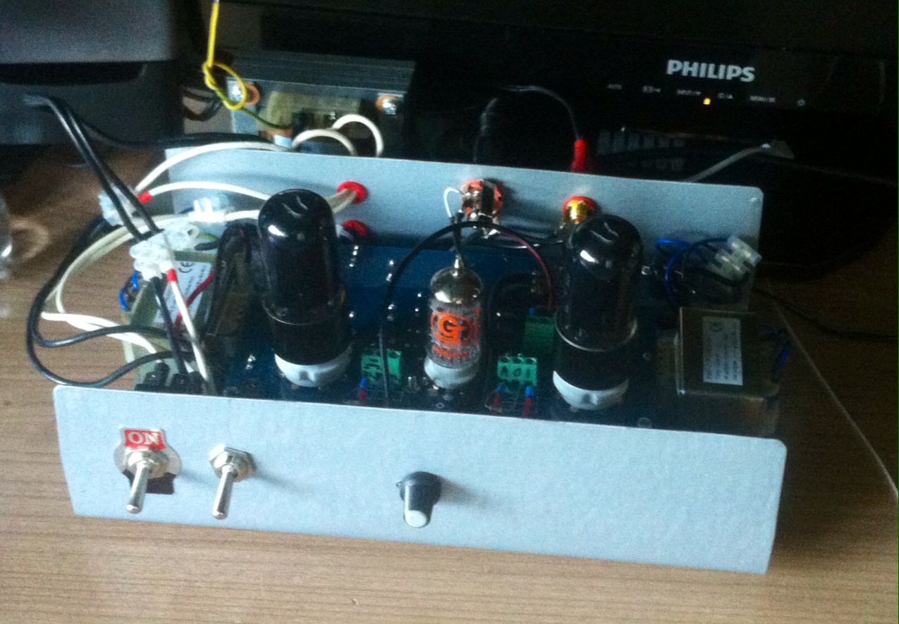

The Amp is done,
Hey Guys,
I had finished the electronics on the amp, and i tested it, it sound acceptable, taking in consideration that is single ended, and i had used 230--> 2x6V power transformer as OT. All i did was to repack the E+I lamination's and put an air gap. I am planning to wind some bigger trany's for OT, and to finish the enclosure of the amp.
Thank you guys for all the help and tips,

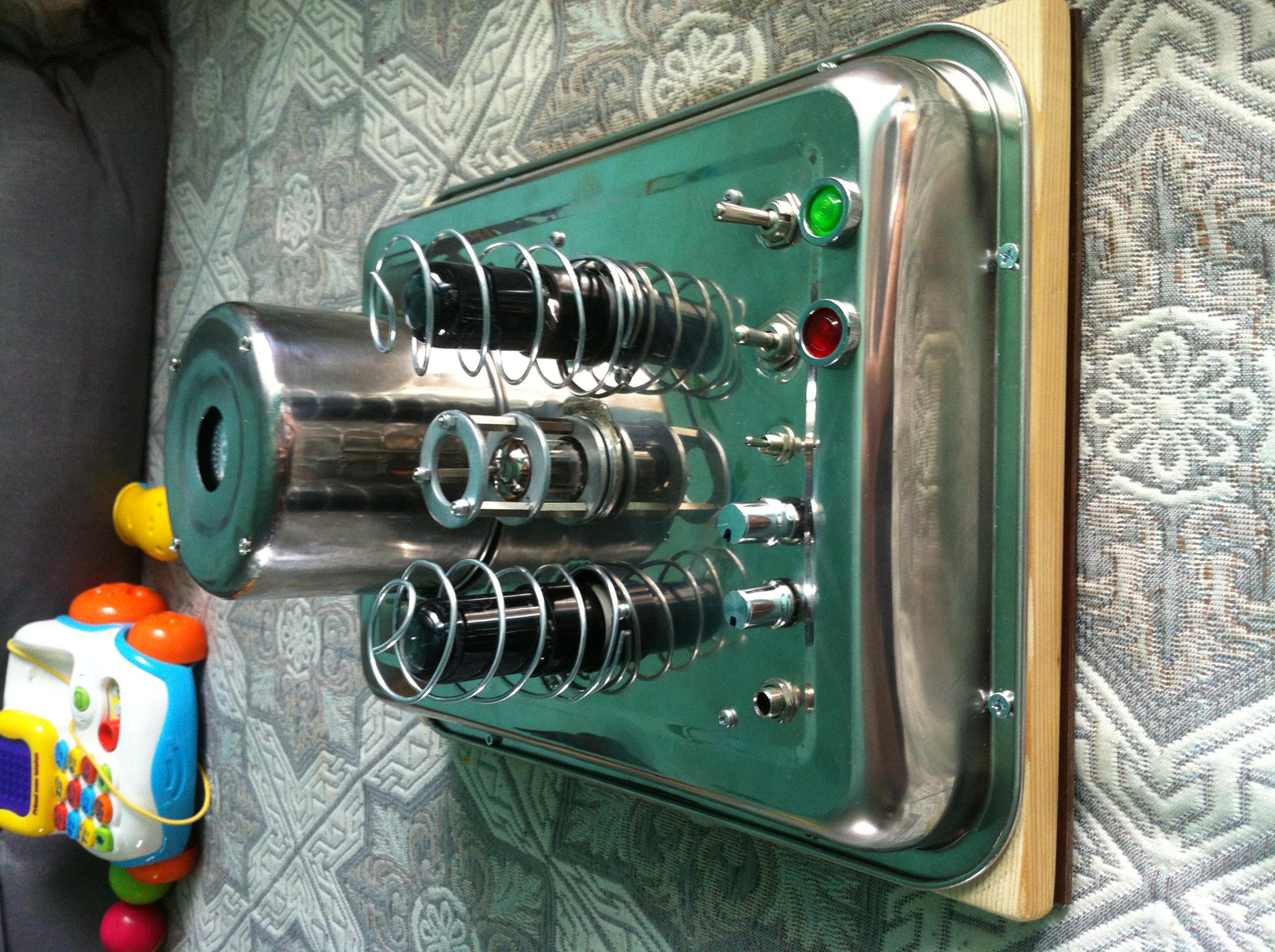

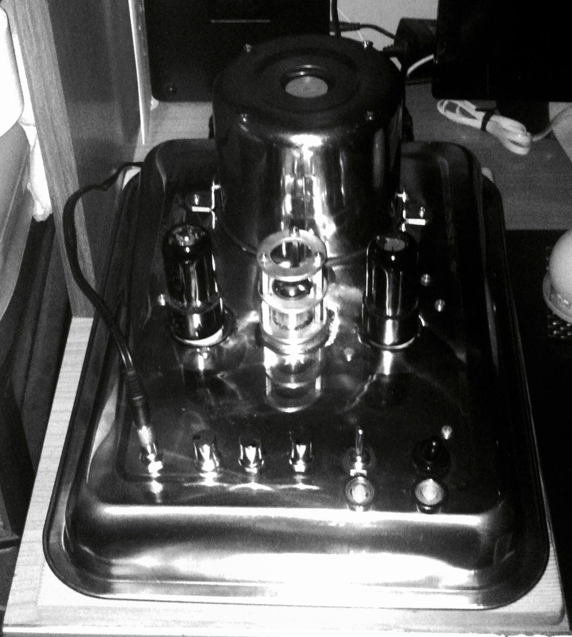

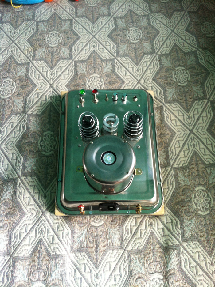

Hello guys, sorry for not being active for quite some time, but life is full of action and simply there is not enough time, but i try to make some time for my projects too.
I had finished the build of the amp in this post, and i will share with you some pictures,
since inside is known, the final form is like this, hope you like it, please live a comment, if you like it or not, i accept constructive critics and advice, i am just a human, and i learn from my mistakes 😀
Here come the amp:
I really like it! Lots of curves and a 1950's 'swoopy chrome' look. It reminds me a little of the old Automat in NYC. The big springs around the output tubes are a nice, fun touch. Are those 6V6 tubes?
Hi, dude,
I am glad you like it, i give it away to one of my friends, as a birthday present.
the tubes are 6P6S rusian equivalent to 6V6, and the preamp tube is ECC83.

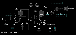

hello ,
i comparate the build and use tube TV ( EL 300 drived to small ECC 83 😀 )
2 x 8 W to 1 Khz , the OPT build to Hexacom .
The EL300 tube is a very interesting and obtain good performance in audio amplifier applications.
A notice about your construction output OT is that transformers are small and I think you can get better performance if you use these sections for OT somewhat higher.
Low frequency response to be much better at 0dB, in my opinion!
In the picture I have another solution EL300 and amplifier with ECC83:
