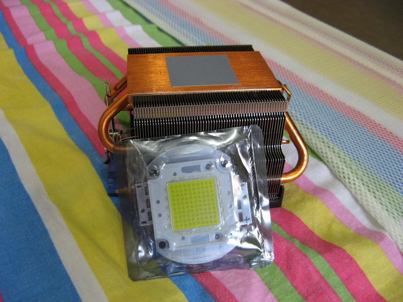

100wLED + driver + condenser + cooler

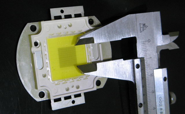

LED:
Forward Voltage VF IF=3500mA 32-36 V
Flux Characteristics ¦µv IF=3500mA 6000-7000 lm
Color Temperature Tc IF=3500mA 6000-7000 K
Viewing Angle 2¦È1/2 IF=3500mA 110 deg

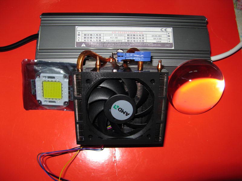

LED special power: Constant Current Source (not normal Switching Power Supply )
cooler.:
pure copper base and 4 heat pipeS
condenser diameter 75mm. focal length 70 mm

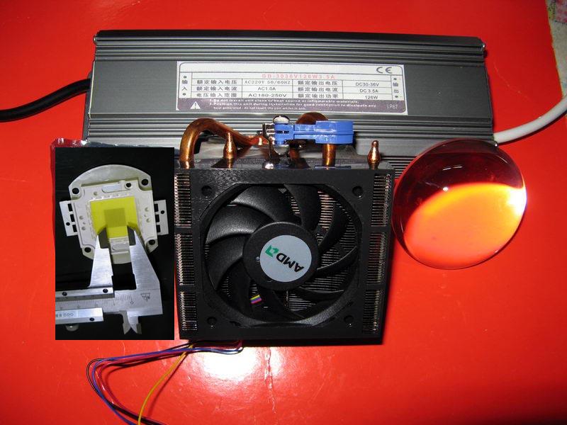

If you all want to learn more about this solution, I can analyse it on request.
1. The tempreture on the heatsink? How much? high or low?
2. The total output of the lamp array?
3. The efficiency of the engine?
4. The color temp of the lamp?
5. The real life of the lamp array
balabala
1. The tempreture is about 60C elsius, on the pole of lamp array
2. The total output of the lamp array is 6000-7000 lm?
3. The efficiency of the engine 60-70lm/w
4. The color temp of the lamp is 6000-7000 k
5. The real life of the lamp array, no time to test
