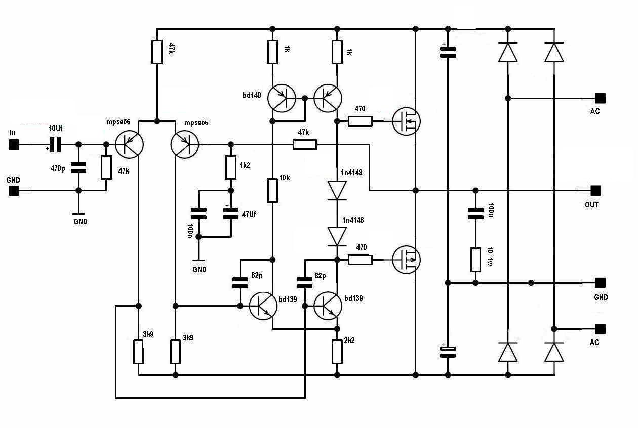

IMAK Member Joined 2010 2010-08-12 8:10 am #1 2010-08-12 8:10 am #1 Hi friends, I want to use tip35/36 in this 100w mos amp schematic so any suggestion for that ?😕😕😕 Attachments mosfet-amp.jpg 92.9 KB · Views: 147 djk R.I.P Joined 2001 2010-08-13 2:24 am #2 2010-08-13 2:24 am #2 Add a pair of drivers, and a Vbe multiplier for the bias. Status Not open for further replies.
