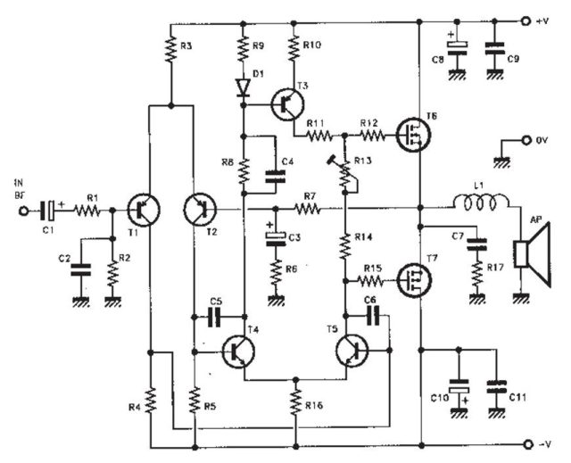

Is this Mosfet amp(see the attached file) a simple good amp?
What do you think about it?
100W 8 Ohm +/-50V
components:

That is the 'industry standard' MOSFET amp as designed by Hitachi when MOSFETs first became readily available. It has been cloned a thousand times, both commercially and DIY. It performs well, but there are improvements/better alternatives available nowadays.
no, ratu!
220uF is the correct value as these caps are only for local/close decoupling. PSU smoothing caps are to be used in addition and these should be like you said.

Ok! if it´s only for decoupling, remember to put it as close as posible to te power mosfets.

T1,T2
It is very iportant that you buy many mirror transistors(10 or 20 units of T1 and T2) and measure the hfe of each one, try both which have the same hfe and in the case that you have many, try the maximum value of hfe.
This is aplicable for all mirror transistors!
RATU
RATU
ratu said:On wintermute schema, match Q1-Q2 and Q4-Q5.
RATU
Thanks for the tip Ratu 🙂 Since these are really cheap transistors (the bc556 anyway), I think I'll give that a try! The 10 off price on the bf469's is about $2.60 each though 🙁
