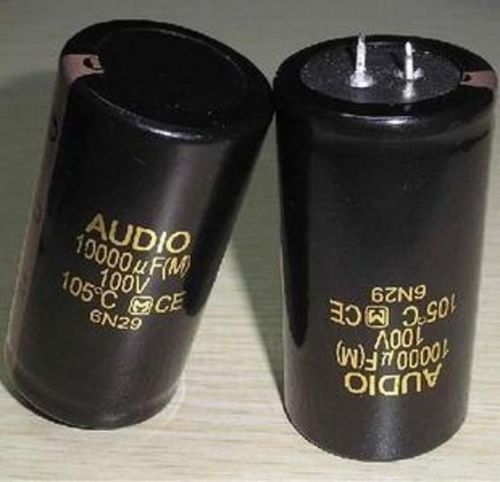

The most common concern with caps, and particularly high value, high voltage is Being able to track down their provenance.
Fakes are moderately common, and when bought from "auction sites" becomes more so.

The most prevalent issues are:
Relabelling devices to higher voltage / cap
Sticking low voltage units in large cans.
If you buy from larger companies/ sellers with a solid business then you are pretty safe.

I purchased a batch of 100 X 10,000uF 100V 105deg caps from a Chinese company through ebay. Not expensive and made by Rubycon, a trusted manufacturer with traceability.
They sent me one as a free sample and after stripping it down, I found a good solid capacitor with large gauge connections internally. Bear in mine the energy stored when charged, lesser connections will blow open circuit!
Buy with care and ask for a sample if quantity purchasing.

The big "AUDIO" on the cap makes me a bit suspicious. Yes, some reputable brands earn a bit more on the same caps by putting fancy sleeves on them and call them "for audio" (Elna) or something like "super through" (Nichicon), and have their marketing departments use a lot of superlatives, but I thought Panasonic wasn't into that...
Edit: ah, no, Panasonic is also into audiofoolery (from 6:02)...
Just the fact that there's no brand name makes me suspicious. The fact that the biggest word on the label is AUDIO, as if it were the brand name, makes me triply (trebly? terribly?) suspicious.The big "AUDIO" on the cap makes me a bit suspicious.
Oh, but the brand name (rather, a logo) is on the cap. Panasonic caps can be identified by this logo:

The logo is a throwback to when Panasonic still used Matsushita in some of their company names.
As for audio marketing, it's just something that is so common that 'it has to be done' to sell. Otherwise you will forever have audiophiles going 'oh but this component doesn't have audio features!', even if you have the same product. Plus you get to mark up the product by having a word on it.

I bought a few of these, and they do seem to be 10000uF parts, judging by discharge rates (I did a very rough check of timings to various discharge points).
I'll put them to the test voltage wise tonight if you like?

I guess any company including Panasonic can get on the bandwagon of having “audio grade” caps they can charge more for. And then if it doesn’t meet sales goals they nix it. I’ve found that caps intended for power filtering in SMPS duty tend to be “best” for audio. It has to be good to be able to cram high current thru it at 20 kHz without overheating.
