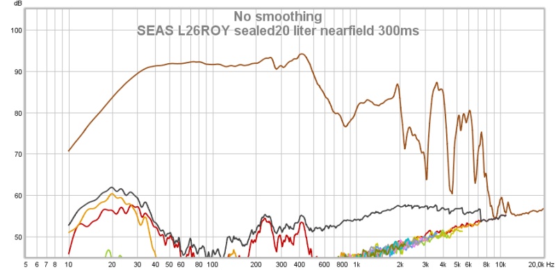

SEAS L26ROY in 30 liter (wrong volume in picture text) sealed box, nearfield measurement. Not just a subwoofer!
Is this the standard l26roy or the 4 version?
Juhazi: Dayum, the L26ROY has a flat response, looks like it has mildly better sensitivity as well. It might be a bit better suited to what I'm looking at compared to the L26RO4Y.
How do you find the transient response in the sealed 30L box? i.e. is the bass still quite tight and punchy? As well, how much power are you giving it in your active setup?

^and ^^ My measurement does not have standard voltage/dB. Yes this is the older version, not RO4Y. The 4 should have even better low extension but perhaps also higher distortion there. Th unit is downfire and the wiggles at 600-800Hz come from this setup. The factory datasheet response is reliable.
I use "Linkwitz transform" -way equalization in my active system. These are very strong units and can take loads of power, very well suited for active 3/4-way systems and subwoofer usage!

That depends entirely on the way you use it. I haven`t measured the alu Seas and it was used as a subwoofer, but below you can see a short test of it.
