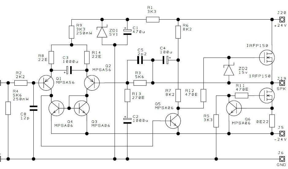

hi..i built some single ended designs.i made this circuit and i can say its the best i have heard.and i have some questions...
1-)how we decide the max or best voltage supply value of single ended symmetrical class a amps?(for this amp with irfp240 transistors)
2-)i replaced irfp240 instead of irfp 150 in this circuit.mids and trebles increased and bass reduced..but i always see positive offset of 150mv..i can reduce it to 100mv only by playing trimpots..i can not reduce it anymore..which values of resistors should i change?

Adjusting R4 value you may reduce your off set to zero
try a combination... a fixed resistance plus a trimpot...then adjust and measure your offset.

thanks i will try..i should change some resistors..there is sth wrong at this amp..

for irfp240 the maximum supply voltage is 240Vdc.
The ideal voltage will probably be less than this maximum.

hi andrew...there is not a single ended transistor amp works at 200v dc.i meant what is the max voltage value for se class a amps for only one pair of irfp240.whatever.and what about the question 3 ? thanks
I bet there is more than one.umut1001 said:...there is not a single ended transistor amp works at 200v dc.i meant what is the max voltage value for se class a amps for only one pair of irfp240....

Change R1 to 2.5k!
Then play with R3's value if needed...
