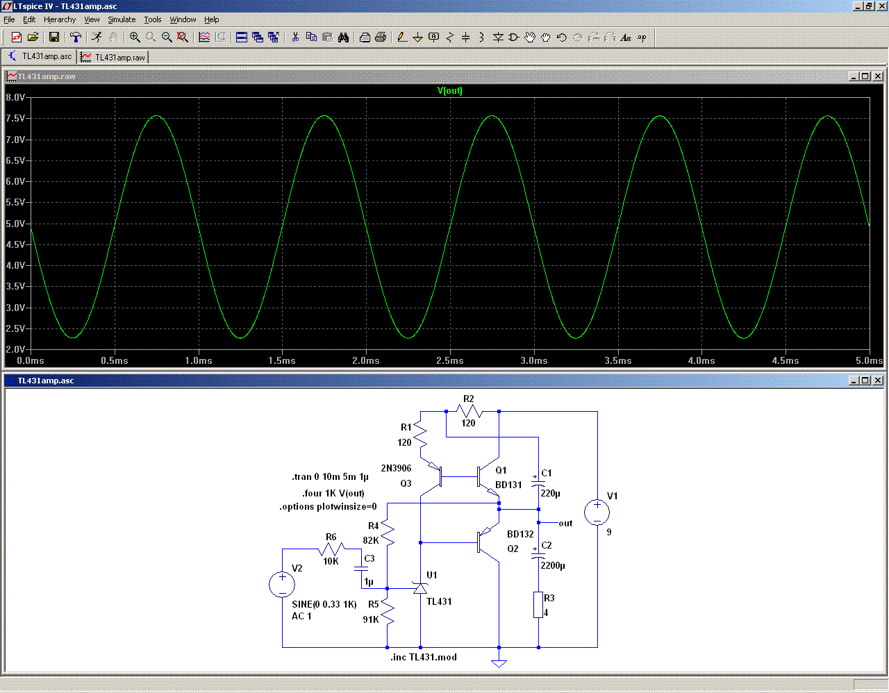

I only have short answer to you question: for fun! My idea is to build a guitar amp from an old circuit, a transformer less amp, in the same spirit as the Deacy amp.
Could you point me some links to some "modern" 1watt amps with similar or smaller partsps? Thanks.
Why not try something original for a change:
Here is an example based on a TL431 used as a supertransistor.
When built, it will look exactly like an ordinary discrete transistors amplifier, but with exceptional performances:
Effebi: For a guitar amp 10% THD is quite reasonable and probably I'll go for some Zen variation (class A mosfet). Or something like this with a proper buffer.
I wonder what is the sound of a class A guitar amp with, mainly, 2nd harmonic distortion! How does it compare to a tube amp?
