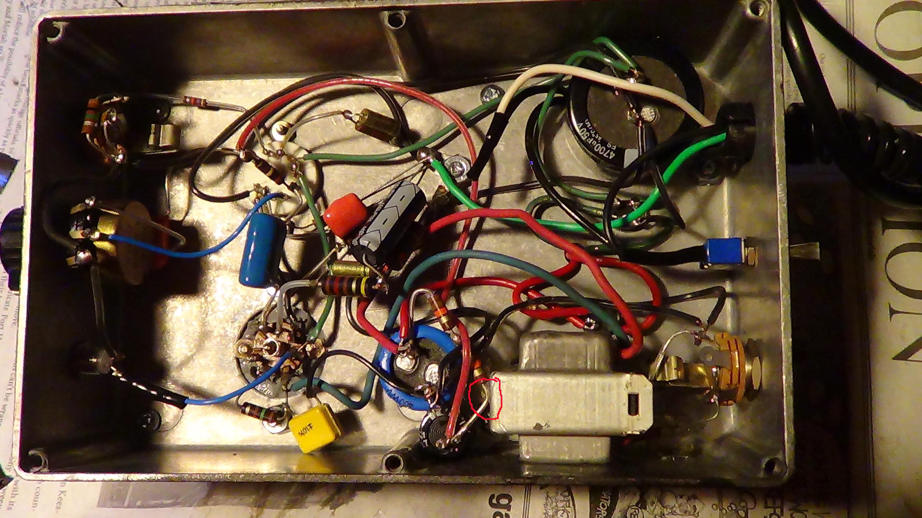

I have an old Red Iron Lil Mo' amp, which is a 1 watt point-to-point wired tube amp. I just changed the tubes, but it still hums a lot (120 Hz) and sounds very muffled, not at all what I would expect, based on Youtube videos of other Red Iron amps and my experience with other low power tube amps. Also it seems like it should be a bit louder - I know 1 watt is not all that much. It definitely shouldn't hum that much.
I suspect that the filter cap is bad. Is that is the most likely cause? Is there a way to check, other than just replacing the cap?

Not the cause of your hum, and it may be an optical illusion in the pic, but I'd have a look at moving that resistor next to the (output?) transformer a bit, while you have the amp opened up. Is that clear insulation on the resistor lead?

Looks like there could also be a short between the case of what I believe is the output transformer and a resistor in the power supply. Could be an optical illusion.
It certainly has a thrown together look to it. Does it have a fuse? I assume it has a power transformer.

I don't see a fuse in there. I do see the HV secondary wires and the 120v primary conductors going through non-grommeted holes to the top of the chassis where the PT must be mounted in this version.
The transformer we're looking at is the output transformer - you can see the connections to B+ and the power tube plate.

Just to be clear, you have three suspects for cap problems: the large black 4700uF 50v cap on the heater supply (upper right in the pic), the smaller blue 400v cap with the power supply wiring attached (to the left of the output transformer) and the filter cap for the preamp (the black cap with the grey stripe).
You could try wiring up an appropriate size (and voltage rating) cap with wire leads and either tack solder (as already suggested) or attach alligator clips and connect in parallel with the existing caps. Though this doesn't always cure the problem, it should give you an idea of where to focus your attention.

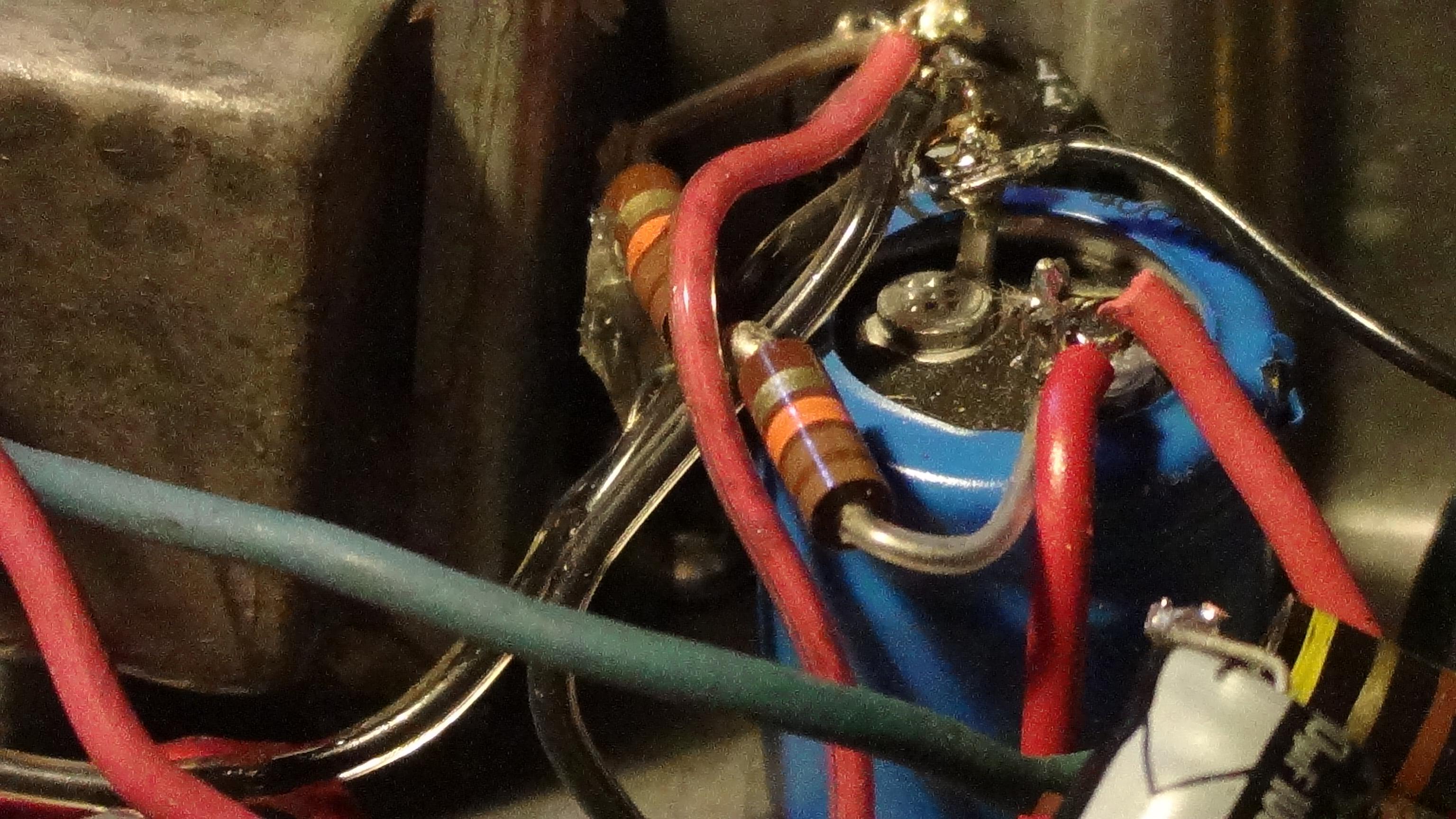

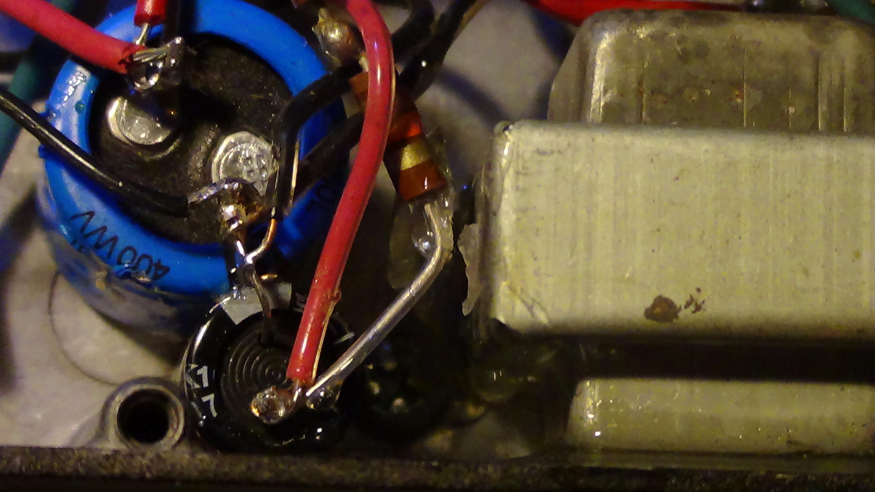

That transformer is the output transformer and there does seem to be some goop in there. See pic.
The power transformer is on top. I think this may have been some sort of prototype or early version, as it does not look quite like the picture on the Red Iron website (which does not show a transformer on top). It does not have a fuse.

Thanks for those close-up pics. I'd missed the 4th cap tucked in between the blue cap and the output transformer.
If you do re-cap it, it will be almost a complete rebuild. (It might be a chance to replace some of those carbon resistors with metal types...)
