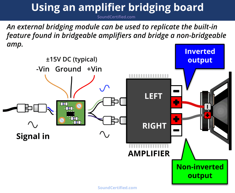

I have an idea for a stereo system design that uses 1 stereo amp for each of the 2 speakers. How do I wire stereo amplifiers to drive a single speaker. It seems to get a lot of discussion and is quite a common setup but I can't find any concise / explicit diagram which lays it out in such a way that there can be no confusion.

You can't do that with a normal stereo amplifier, you need one that is "bridgeable".
Some stereo amplifiers are designed to operate in "bridged mode" thus converting a stereo amplifier into a bridged mono amplifier.
https://soundcertified.com/how-to-bridge-amp/
Amps have to be designed to parallel the two outputs, to avoid blowup. Download the owners manual for your brand and model of amp for some tips. Sometimes the 2 channel drive from one input switch is internal. Sometimes you have to buy a Y cable to drive both inputs from one source. Some designs will not behave with the outputs tied together. No bridge instructions in the manual, do not do it.
As indianajo says, some stereo amplifiers are designed with a polarity switch to invert one channel internally.
Upon reading the link I supplied, I see that if a stereo amplifier does not have the internal polarity switch then you can add an external "amp bridge tied load (BTL) preamp board".
