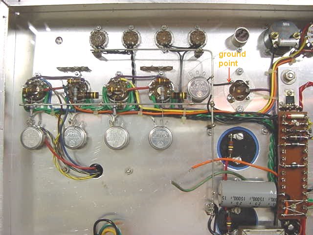

I almost always use number 12 tinned copper buss wire from a large spool I bought years ago. I like it to be self supporting and to remain straight as I connect wires and leads to it. There's nothing more shabby looking then a crooked ground buss. In the attached picture of an amp under construction, the ground point is at the output filter as Kevin suggests and near the input XLR connector. The first input tube is also right nearby.
I've never heard of a proper ground buss picking up EMI or RFI. After all it is at ground isn't it? You'd have to be right next to a 50KW transmitter for that to possibily happen. And even then the wavelength of the buss wire would be way too short for frequencies of that power level.

No. By using thicker wire one lowers the impedance. I use 4mm copper wire in a matrix grid system. This requires a good quality fat tipped soldering iron. By using such large OD, one can take some liberties but circuit hum is insignifigant and embedded with amp noise. The power caps are starred at one point away from sensitive stages. I don't always rely on the chassis for ground as sometimes in MI stage apps, hum can be a circulating external cable problem and one has to lift off the ground connection. The line earth is always connected to the screen of the power transformer. This protects the user.
