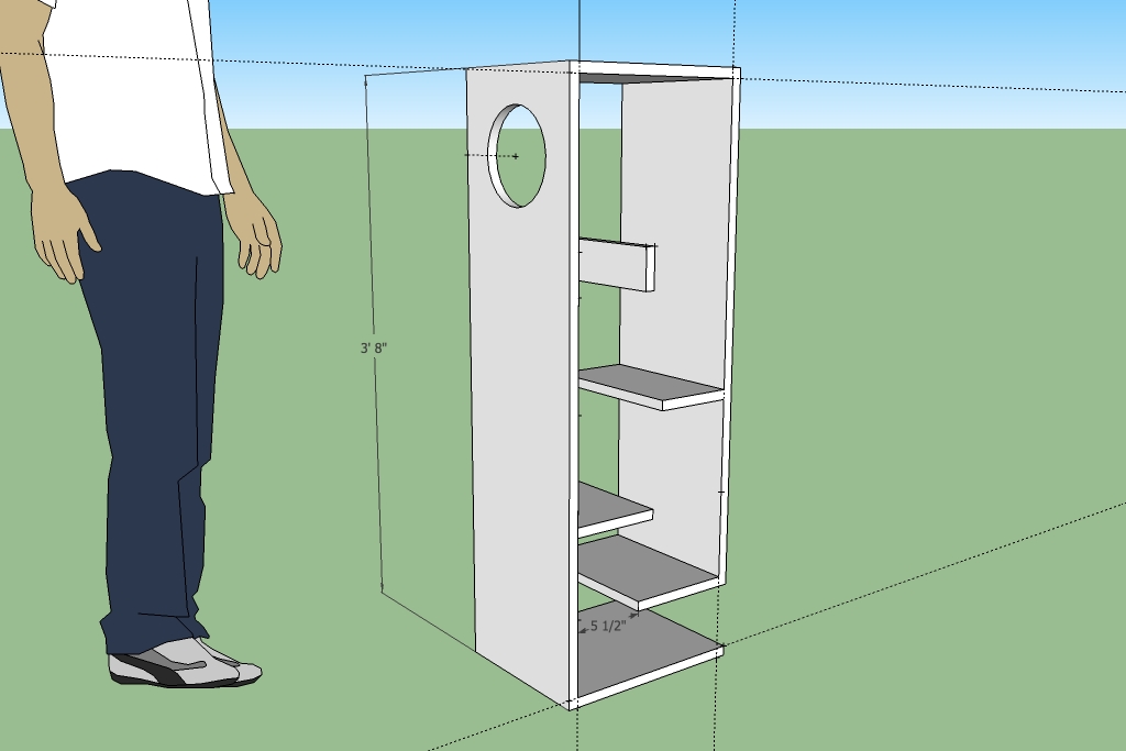

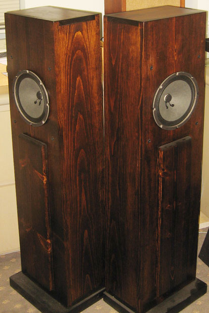

Karl,
I modeled the TL's in Horn Response. I worked the original design out as a regular tapered TL, then I tried some models with various steps to see how that might affect it. It works very much as I expected, which is to say, great! The transient response sounds excellent to me. How the cabinet effects transients will depend on exactly what you are asking out. The TL's midbass lacks the "slam" I got from the BIB's, but I'm sure it will exceed a sealed box in that regard. It has been awhile since I tried a sealed box, but I suspect that the midrange on up isn't entirely different. If anything, I'm sure the TL is better as the speaker has more room to breath, and likely is being asked to work less hard.
If you are looking for "slam," that will always be a challenge with a little, low excursion woofer. I'd pick the biggest enclosure you can stand to give it as much help as possible. If you are looking for speed and microdynamics in the midrange and treble, I'd stick to 1.5 cu ft at a minimum. You don't want to have to stuff the enclosure too much and "choke" the dynamics. I haven't tried it myself, but if you go to a very small (1 cu ft or less) sealed box, you should be able to stuff it enough to get the bass in line (not too warm), but those micro-dynamics will the the first thing to suffer. The flip side is that the smaller sealed box will restrict excursion more, so the maximum dynamic range should be greater.
I attached an image from SketchUp. This is the TL with no sides, so you can see the internal folding and get the basic idea. The dimensions are a little off, and I can't figure out what I'm doing wrong. That is why I'm not showing all of them. If you needed this to go flat against a wall, you could face the terminus forward. As long as you've got an inch for them to breath, the rear vent is probably the way to go.
Paul

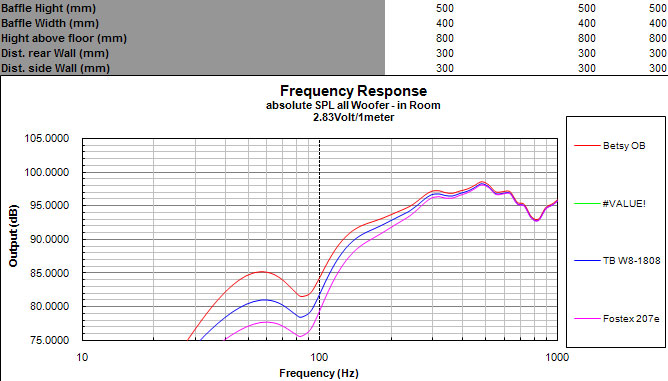

Attached are charts for sealed, vented and small open baffle speaker for Betsy. I left some other drivers in the open baffle sim for comparison. These boxes work well enough. If you like the Betsy's dynamic, detailed sound and don't mind a sub i think the small open baffle might be an interesting idea as a substitute for a bookshelf sized speaker. I should sim the Betsy on a larger open baffle too...
Godzilla
Godzilla

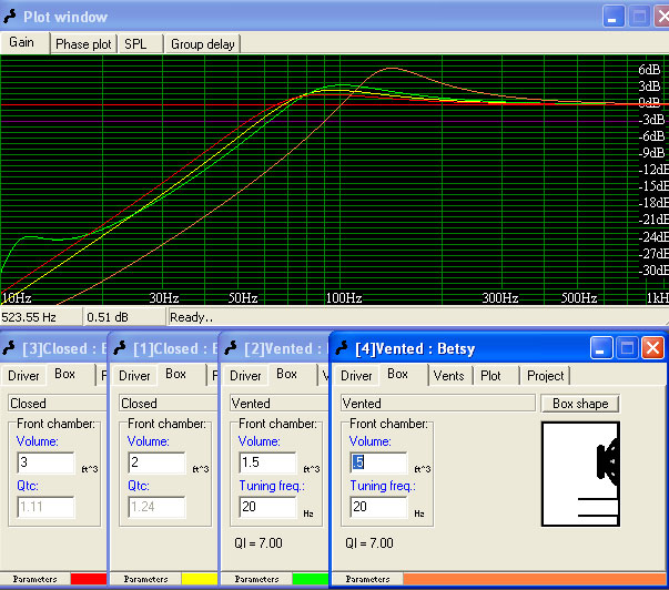

That's a good thought! I've only simmed the driver i have with the higher qts... the BetsyK may be better in the sealed or aperiodic boxes for sure. It may be fun to compare Betsy on a small OB to BetsyK in small sealed/aperiodic. I would imagine more base from the BetsyK but the imaging could distinguish itself on the open baffle providing a different advantage (or flavor) over the other. An open back box like the old vintage boxes is probably what i will build for my Betsy in the near future.

BetsyK sim I did sometime ago for 3rd order sealed box shows ~350uF "should" flatten the passband and lower F3 but a series capacitor of this value will raise the output and in-band excursion. A leaky box may be good - do nearfield mic and muck with holes/whatever while watching on RTA

I feel like building the Betsy in a small OB just for kicks... will hide a small sub under my office scanner and keep it a secret. Shhhh!

Generally, power handling in it's strictest sense shouldn't be an issue with fullrangers. With most higher efficiency fullrangers, you will exceed Xmax at power levels well below the voice coil's thermal limit. Where excursion isn't controlled by any acoustic means, like an OB, it won't take more than a couple of watts to exceed where the speaker sounds good. And, it will only take a couple more to get the voice coil out of the gap. I can imagine that some BLH's may control excursion enough to allow you to through some serious watts at the speaker, but that isn't what we're talking about here. Even if thermal issues somehow enter consideration, there shouldn't be enough air moving in and out of the aperiodic box to make a difference. Stuffing in the sealed box would limit the speakers ability to shed heat. But, I really don't think that is the primary concern in the vast majority of home fullranger applications. IMO, if you need more than a couple of watts, a single driver isn't for you. Sure, there are drivers with higher excursion, but that doesn't mean using it is a good idea from a distortion standpoint. Thermal concerns are important in pro audio, but that is an entirely different ball game.
What you want is to limit excursion to keep distortion down. Both the sealed and aperiodic boxes should do a decent job of that. With a woofer assisted OB, you'll get better results with some sort of high pass filter. However, in the extreme near field (are you thinking on a desk?), it may not be worth the hassle.
If you are looking for small OB inspiration, how about heavy duty (1/4" wall) aluminum stock pots? They cost a bit of $$ in big sizes (like 40 quarts), but I'd love to put a pair of Betsys in the bottom of some shiny cylinders. Maybe even big roasters on a desk.
