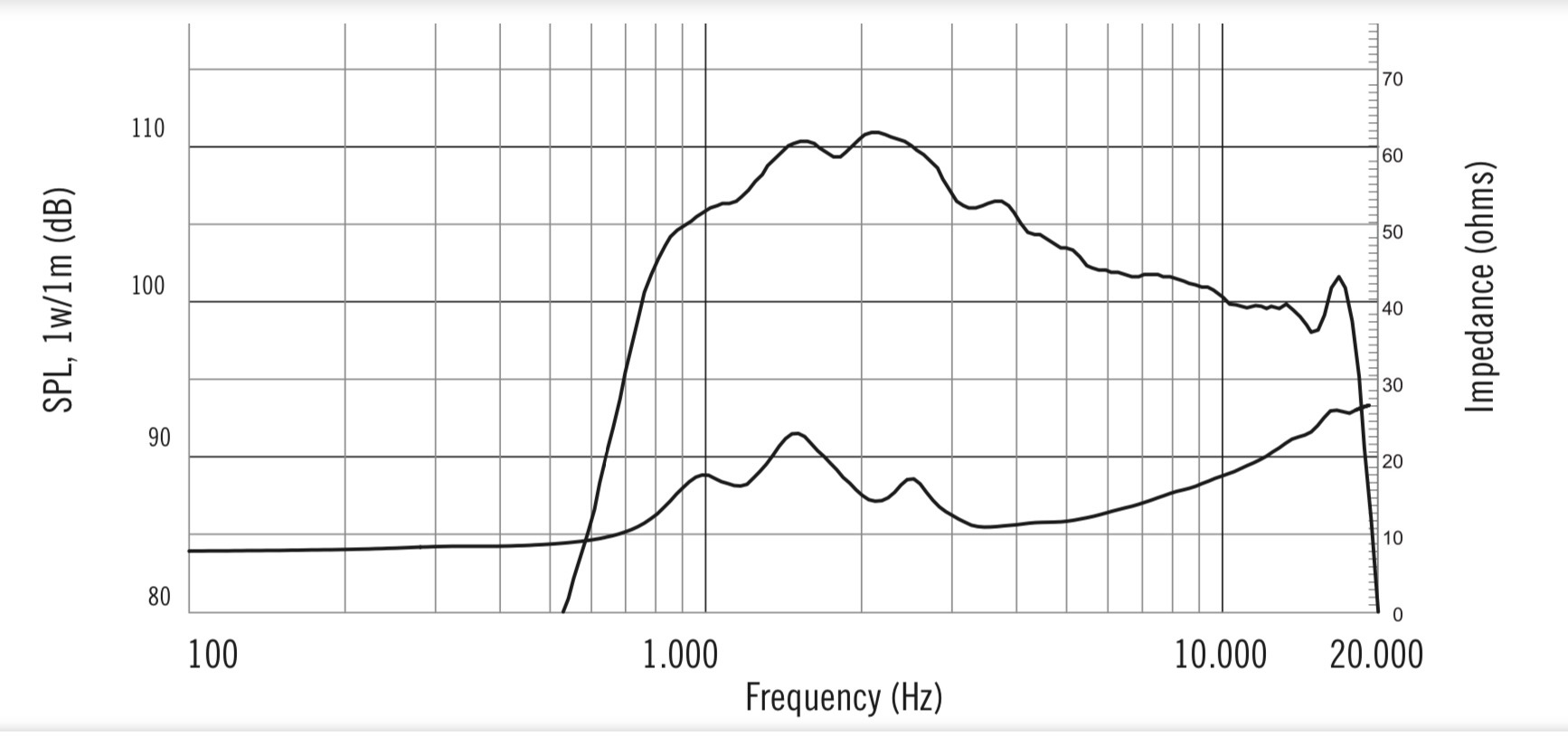

Also, here is the graph for your CD. Different horns may effect the 12db hump around 1k differently.

I don't want the directivity to be too narrow, not much less than 90 degrees horizontally. I would like to set the crossover frequency between the midrange and tweeter where the respective directivity characteristics of the midrange and tweeter there are approximately the same. All crossover development will be based on measurements of the individual drivers in the concrete enclosure, including from different angles.
That's why I can't say exactly where the crossover frequency will end up, but certainly not particularly low (the dispersion of a small midrange will be narrower at higher frequencies than that of a large bass-midrange), perhaps around 2 to 2.5 kHz.
The original plan was actually to use a "normal" tweeter without a waveguide, the Sica LP 110.28/380 TW. But I just have the two RCF N350s here as well. Maybe I will try both.

I like the suggestions to try the small B&C horns, especially since they also have CD behavior and they also seem to fit well visually with a 5-inch midrange driver in terms of dimensions.

I also like the B&C ME20.
145mm x 145mm, fits the size you want, and the directivity control is really good, as you probably have seen in the spec sheet.
I'm using it above a B&C 8NDL64-8, driven by a B&C DE14TN, with an acoustic crossover point of 1600 Hz, which results in a good phase and polar response match for the pair. At 2 to 2.5 kHz, the ME20 would be a good match for your 5".
A 2uF capacitor ahead of a 10 ohm resistor in series with the driver, and a 20 ohm resistor in parallel took care of both CD compensation EQ and crossover.
