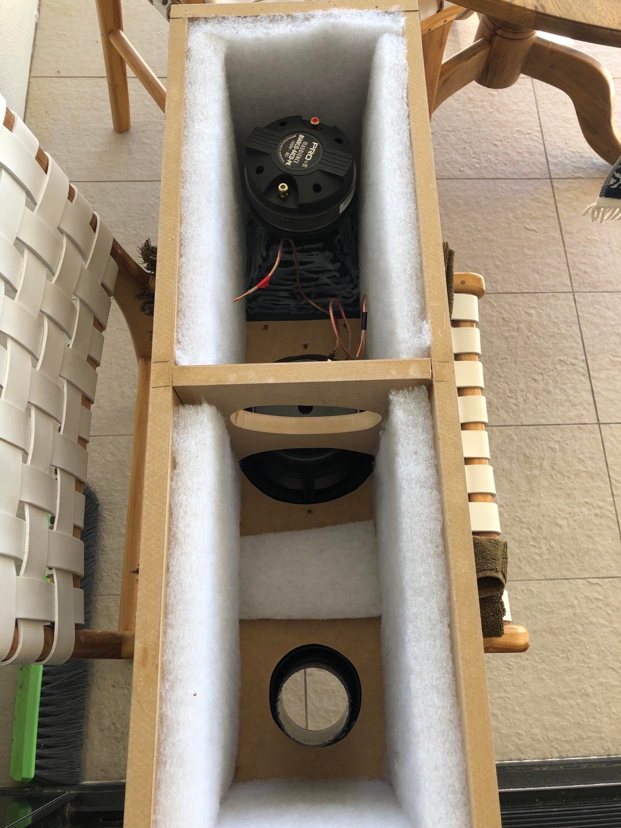

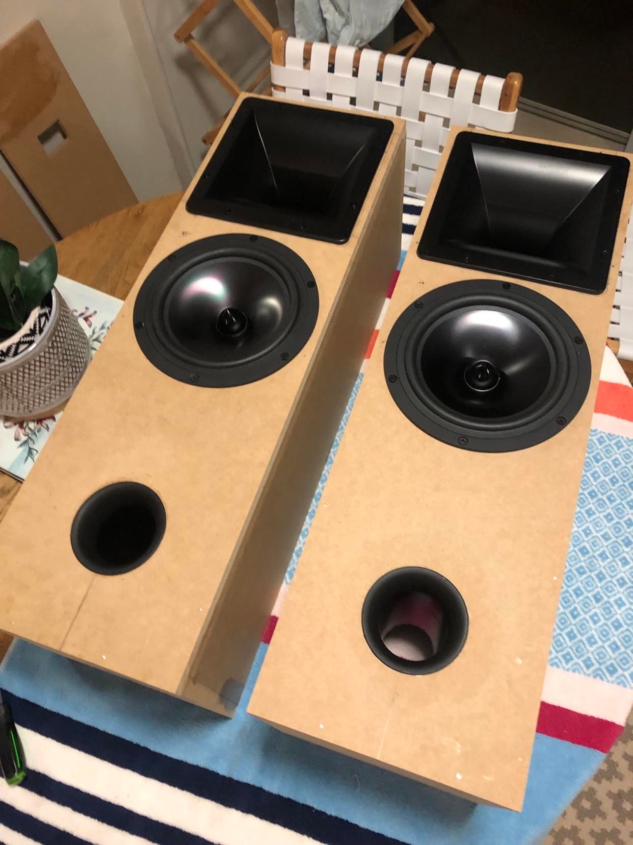

Box:
x2 36 liters (1.26 ft3) boxes anchored together, ported, 36Hz @ F3, 780mm wide x 250mm tall x 300mm deep. 18mm MDF, braced.
Drivers:
SB Audience Bianco 44 CD-PK compression drivers, one inch
SB Audience H225 one-inch horn, 800Hz Fs
Dayton RS225 8-inch woofers (Reference Series)

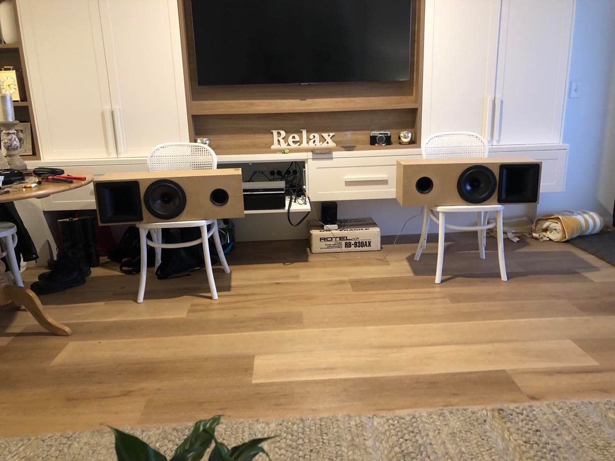

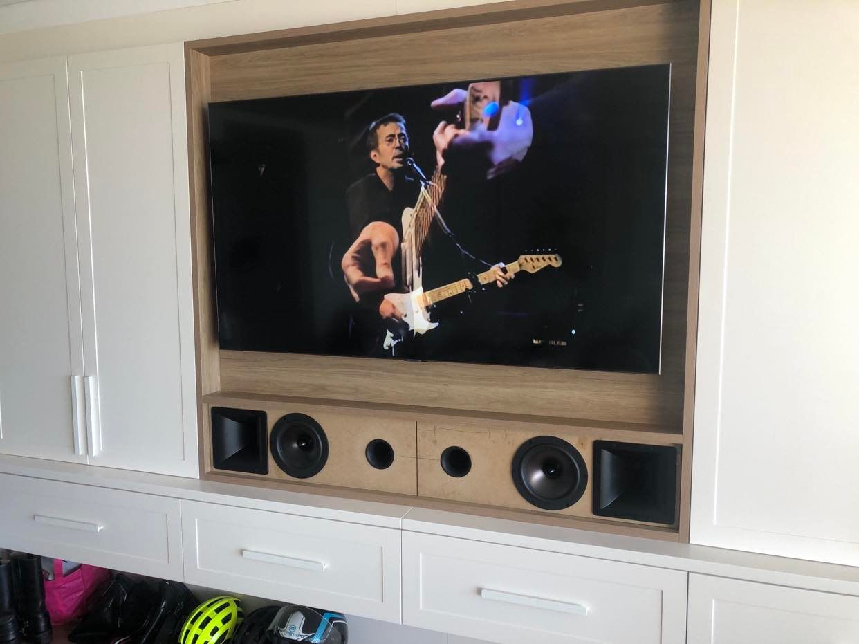

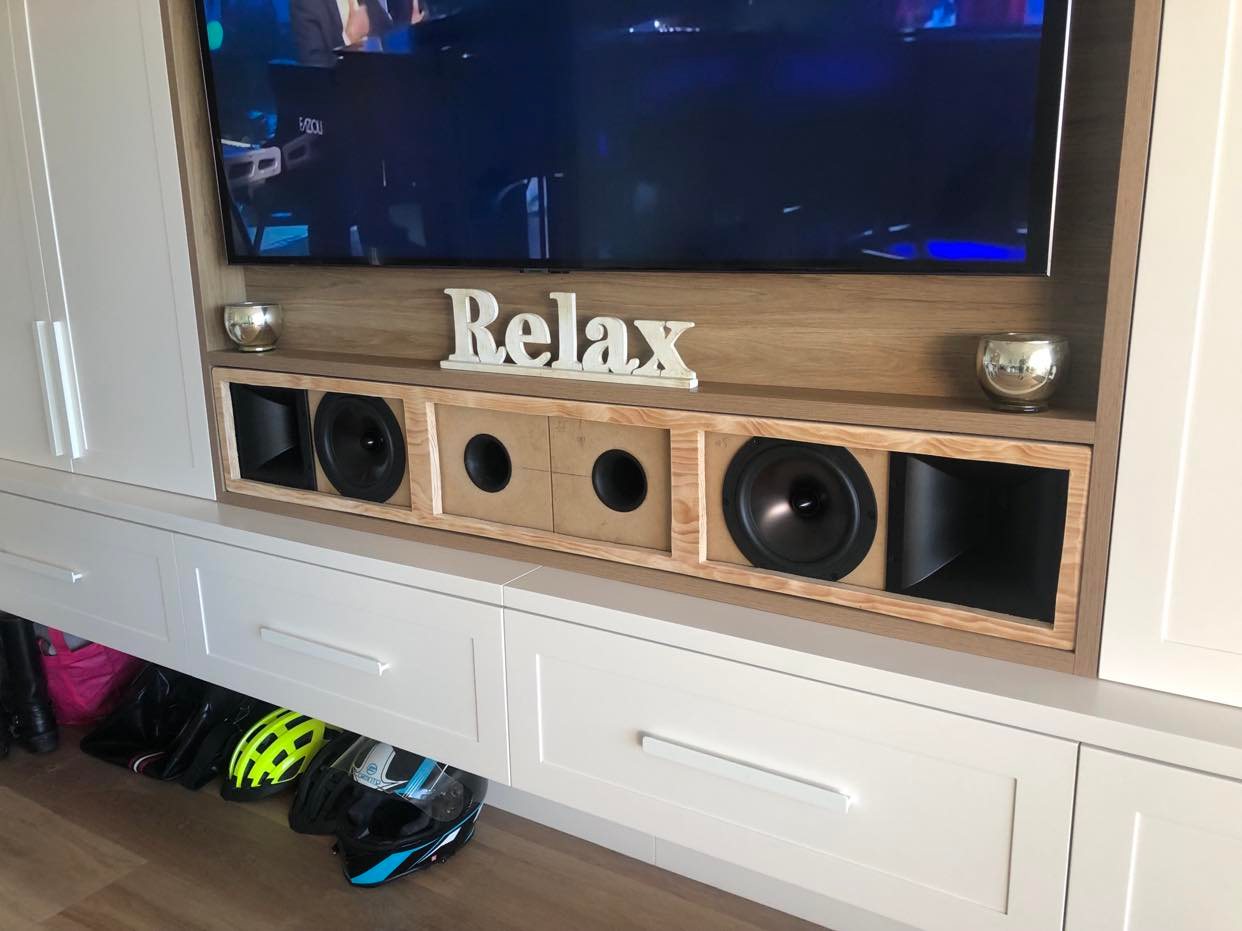

Finished fitting the speakers and building the grill frames. Hacking into a new expensive wall unit with a Multi Tool was a little scary. Sounding good. Grill cloth to add, plus re-wire the pre-amp so it sits outside of the drawer. Makes the little Yamaha and Sanyo centre channels look cheesy by comparison.
