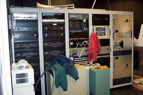

I my real world job I service many Large Format 8/70, and 15/70 motion picture sound systems and I can tell you that without doubt that most of the problems I encounter are in the patch bay. I don't give a hoot how high of quality one you use...it will eventually act up!! Many patch bays have been replaced by audio routing systems. Pinkmouse these people are building stuff for at home!! I say stick with the higher quality RCA, or XLR jacks and plugs! They are not going to get much repeated plugging and unplugging anyway......and even the lesser expensive WBT stuff is far higher in quality than anything Neutrick produces.....
Mark
Yes, Indeed the universe can allow queer things......
Below is an installation pic of one of those systems we installed last September. All Quad Amped EAW and powered by QSC amps. This is for a 15/70 3D system and it was ll purchased used. There have been quite a number of problems related to the patch bay in this system and hopefully the owners will allow us to replace it with an audio router system soon. Yes, it is multi-multi kilowatt!
Mark
