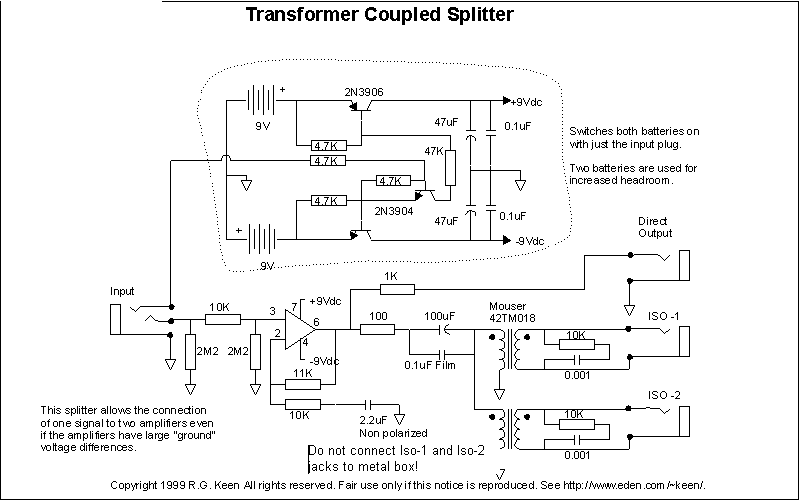

Another nice idea from R.G. Keen. A single stereo jack is used to turn on both positive and negative 9V rails. The jack turns on one small-signal transistor, which in turn turns on two others that actually switch the power rails. See attached image.

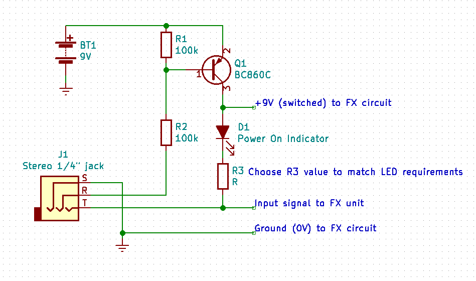

I simplified R.G. Keen's idea to switch just a single positive rail using one PNP small-signal transistor. An ordinary (non-switching) stereo jack is used.
The idea is that inserting a (mono) plug will short the ring connector on the stereo jack to ground, turning on Q1, which in turn applies power to the FX circuit board.
This circuit has not been built and tested.
-Gnobuddy
If I am reading the drawing right: it shoots the huge LED current right into the FX's input.
Perhaps smoking the FX input, and probably not lighting-up either.

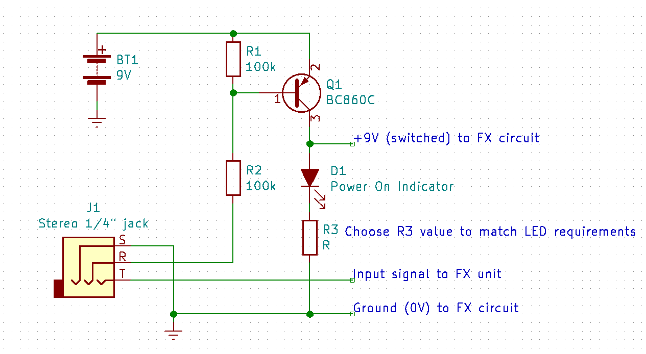

Oh what a difference a single wrong connection makes...thanks for the catch! (I "saw" the right thing in my head, of course, but unfortunately that didn't translate to where I clicked the mouse on the screen. )If I am reading the drawing right: it shoots the huge LED current right into the FX's input.
Corrected version attached. LED current terminated to ground where it belongs, not to signal input into FX circuit.
In my recent builds over the last three or four years, LED current is typically 100 micro amps, or one-hundredth of the old standby 10 mA. I use LEDs rated over 5000 mcd, which combined with the usual 20 mA max current invariably means they are more than bright enough to act as an indicator at 100 uA.
