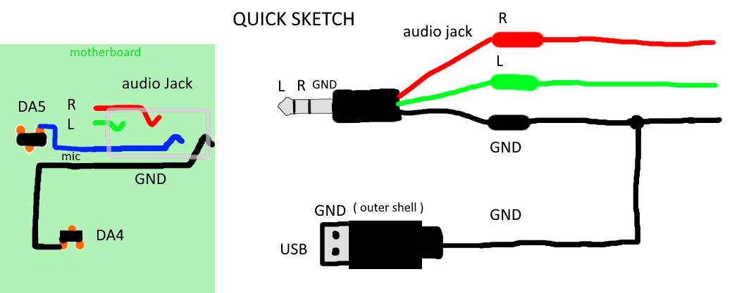

Please can you draw some schematics what you do when it works and when it does not? You talk about output voltage, but it gets fixed when soundcard ground is connected to some other ground... if I understand your long description correctly. Weird. Please post a schematics, hand drawn will do.
Ok so i actually get 0.89v between the soundcard ground and the USB ground tested with a 3 pin aux cable and a multimeter. There is no offset between the Audio ground and L or R channel , Strangely.

I measured the original DC 1.3V offset using a 4 pin 3.5mm jack between the Tip (pin1) and Pin 3. I got 1.6V a offset between the Tip and Pin 4.
This represents the Jack pins
______
< = = =|_____|
1 2 3 4
Also i have to add that the distortion can also be reduced if i use the waves maxx audio software to set the jack to Headset mode instead of Headphone mode ( for devices with the 4 pin connector) but pins 3 and 4 must be shorted for it to work [ shorting pins 3 and 4 can be done by using an ordinary 3 pin connector instead.]
but headset mode disables the microphone on the computer.
The 9V supply was from a linear power supply without a voltage regulator (cheap power supply for electronics ) that plugs into ~ 110 - 240V ac.
The positive rail of the supply was shorted to the Audio Ground of the headphone jack.
