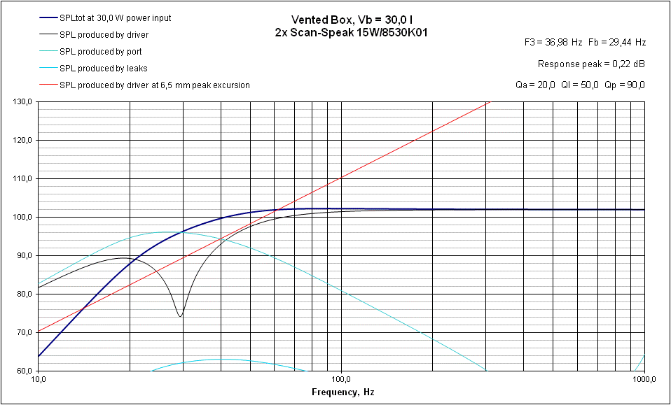

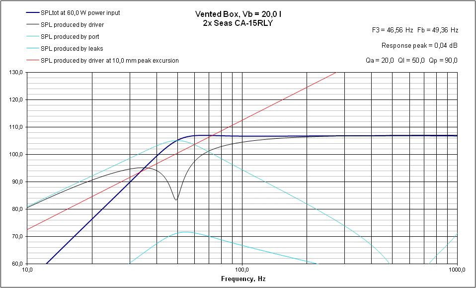

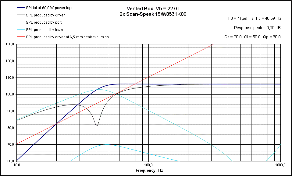

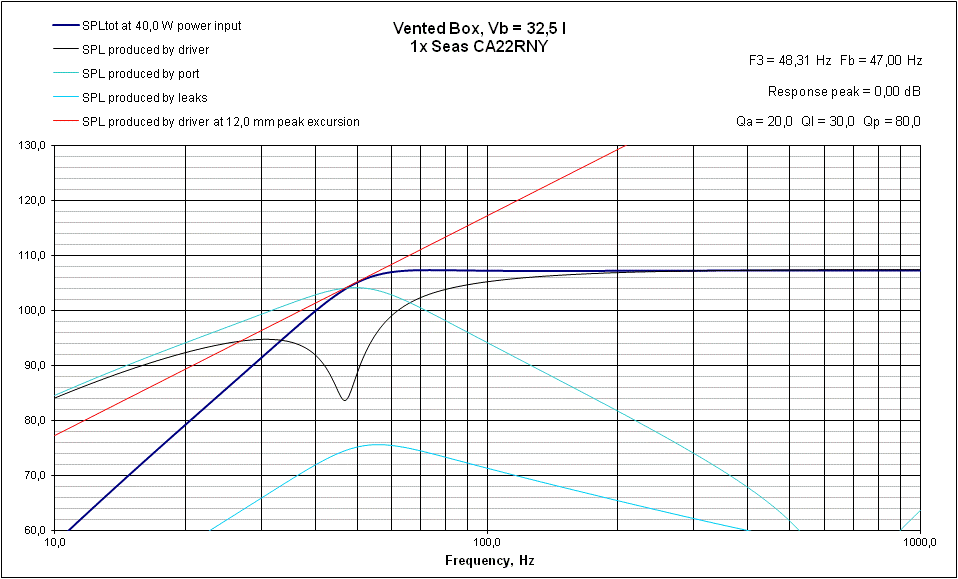

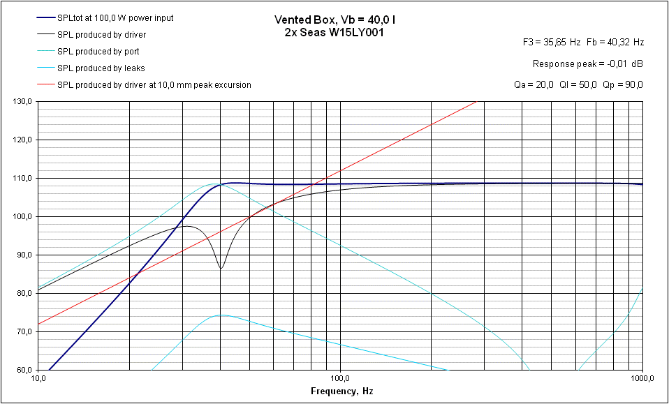

For myself, for the future, I counted several small woofers in ported box of 20-40 liters, in Unibox:
