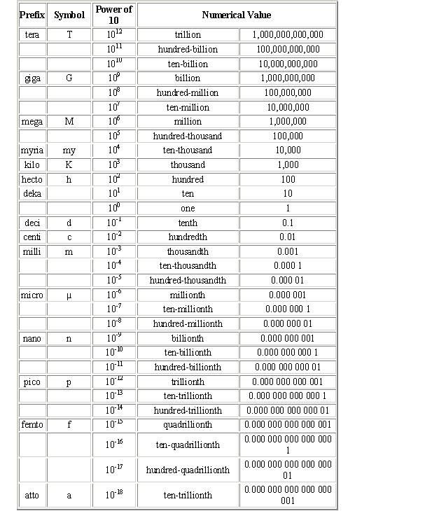

0,0047uF = 47pF?
No, it's 4.7 nF. Which is the same as 4700 pF.
On your calculator:
uF is 10 with exponent -6.
nF is 10 with exponent -9
and pF is 10 with exponent -12.
Note that the international way to express these values is by using a dot instead of a comma. In Europe we write down 4,7 which confuses others. We write down 10.000 for ten thousand whilst the Americans write down 10,000 for the same thing.( If I'm correct ).
Bas, if you use the 0,0000xxx way of noting values errors creep in easily.
Try the exponent way of expressing these values on your calculator and your cross over filters will require much smaller caps ( or bigger ) than you calculated before 😉
Please check the numbers here😉
