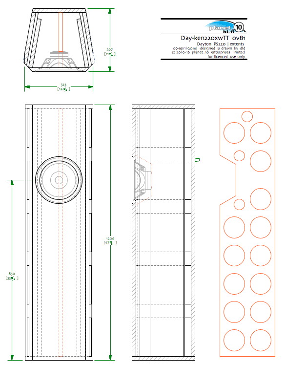

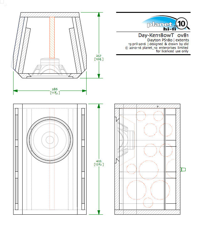

Thanks! I bought the Elekit from Tubedepot in Memphis. That meant the postage to Australia was a big chunk of the price, but the Elekit retailer in Australia (Secret Chord Analogue) didn't stock the baby 8185. SCA do sell the TU-8900.
Yes, the speakers are Dayton PS180s. I tested the amp and speakers before I'd built the boxes, and wasn't impressed - the speakers sounded like they were in a tin can. It was horrible, but thankfully the sound in the speaker cabinets is totally different. I built the cabinets out of MDF with solid Sassafras fronts. No doubt an audiophile wouldn't be impressed, but I'm happy. In fact, for the TU-8900 I've stuck with the formula and bought a pair of PS220s, and some Tasmanian Blackwood for Singularity enclosures.

The PS-220 is decent, benefits from a coatinb of ModPodge/puzzlecaot. I did a floorstander miniOnken for the big one, the PS180 wanted a much smaller box.
