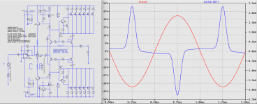

To add. Below shows the power supply sources to the LT1022 in relation to the potential difference across the split Mirror Diamond (sMD at full power 1kHz - 200W/4R. Note that the input/output across the sMD is nearly overlapping in the center, also with the LT1022 output operating nicely near mid-supply within the voltage tracking boundaries.

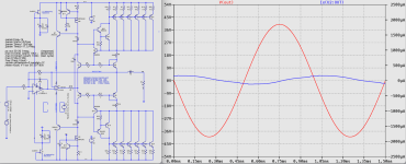

Below is the voltage out across the load in relation to the current out of the LT1022 while voltage tracking the sinusoid under circumstances as per the above. The peaking of the current is the result of loop feedback correction in response to nearing the current limiters at full power 200W/4 Ohm. The current limiters being set to about 12.5 Amps with full power peak current being 10 Amps at 200W/4 Ohm. As observed on the right these currents effectively disappear when current limiting resistors R9/R10 are reduced by an order of magnitude as would then require 125 Amps to limit.

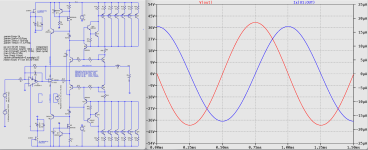

Operational amplifier U1 is the global feedback device operating as integrator with a 68pf feedback capacitor, effectively appearing across the 10k Ohm feedback resistor that sets the bandwidth. The current output of U1 is shown in relation to the output voltage of the amplifie, as observable at a 90 degree phase shift, hence purely capacitively loaded. Of note is that at 1k Hz the output current of U1 is in the order of +/-20uA, meaning U1 is operating largely unloaded, a condition supporting low distortion in itself, and that in conjunction with high voltage supplies keeps the dissipation to a bare minimum. Observable in the network is that the output is directly connected to the inverting terminal of the LT1022, hence in configuration a unity gain loop feedback connection that in the absence of a need for integration for stability operates in a high speed time alignment way, this as observable by current drive correction above. This is while the positive input terminal of the LT1022 is changing more slowly, being driven of overall loop integration correction by U1. This combination of dual loop feedback correction as feedback nesting, in conjunction with added benefits that the sMD with further feedback nesting is largely responsible for ultra-low distortion results.

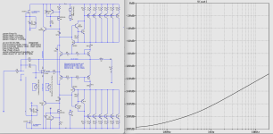

An aspect of power amplifier design considered more critical than perhaps realized is the PSRR, particularly under circumstances whereupon distortion that is particularly low can be influenced more by the power supply. As a result, particular attention was also focused on measures to mitigate the risk of sonic consequences as related to PSRR. This is not to suggest that the extent of PSRR realized is either necessary or sufficient.

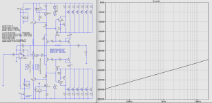

Simulations revealed that supply regulation of the LTC6090 input op-amp is particularly critical. This was determined by a number of simulations applying a 1 Volt test signal inserted in series with the positive power supply rail. In the first simulation below left is with the input LTC6090 removed, with the positive input to the LT1022 grounded, thus testing only the PSRR of the output amplifier in a unity gain buffer mode, and with the LT1022 still in the loop to control the sMD. The PSRR results appear reasonably impressive. The reason for this performance is that the tracking supplies also provide pre-regulation to the LT1022, forming an isolation layer from the raw supplies, being further reduced by the PSRR of the LT1022 itself, and thot for reasons operating in a broadband unity gain feedback loop way pushes the PSRR frequency extension. The simulation to the right once again includes the LTC6090. Observable is that the PSRR is worse, as counter to what can be expected.
The reason for this is that the input regulation to the LTC6090 is inadequate, that in being so becomes dominant of the overall PSRR. Ultimately failing by the use of the JFET's in the supplies. In the notes on the schematic (this near these JFETs) indicates replacement by NSIC2020's. These are 120 volt rated LED drivers as constant current sources fixed at 20mA. These appear ideally suited for this application. Given the voltage range of NSIC's the current regulation can be expected exceptional, even though untested. In the simulation below left, the NSIC's are simulated by ideal current sources, improving PSRR broadband by a minimum of 20dB at 20kHz. This can now be compared to an input LTC6090, operating with an unregulated supply to the right.
What is evident is the serious degradation in the PSRR to exclude regulation, being not worthy of the risk to sonics to exclude

This is an unexpected result, as you ,emtioned, and thus should be scrutinized. PSRR for almost any opamp, including this one, is huge.
I wonder to what extend the LTspice model does accurately follow the real thing. Not sure the PSRR is even included in the model.
Jan
Jan
Jan,I wonder to what extend the LTspice model does accurately follow the real thing. Not sure the PSRR is even included in the model.
Here are the simmed PSSR+ and PSSR- with Av=1V/V
Both are identical in the sim.
The PSSR- is relatively accurate, but the PSSR+ is 40dB too pessimistic in the sim.
Hans

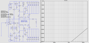

It should be noted that the sMD or "split mirror diamond" is also a feedback network, though discreet, this with its own PSRR. This is shown below left with its input grounded through R14 on its input. This then being nested inside the loop of the LT1022 that reduces the overall PSRR as again below middle, and then both nested again by the input integrator on the right, hence the form of the multi-nested feedback indicated in the initial post.

So it looks like they just plugged the same number for +psrr and -psrr in the model.The PSSR- is relatively accurate, but the PSSR+ is 40dB too pessimistic in the sim.
Normally +psrr is (much) better than the -psrr as you discovered.
Jan
I'm hoping the added regulation will be sufficient in conjunction with whatever PSRR's of the LTC6090's happen to be as good enough Jan.
